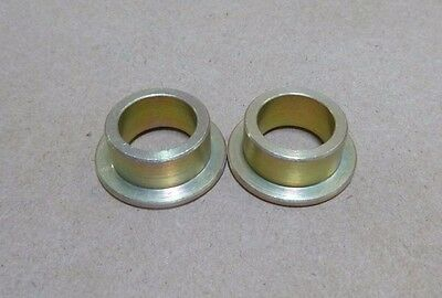

I was actually wrong on my top pin hole size, it's 1.25. Looking at the factory step bushings for the top link they are 1.25OD x.765ID x .70L

I haven't converted all my pins to Cat 2. So ... in the mean time - I use bushings on my Cat 1 pins to fit my Cat 2 implements - as needed.

Yeah, a flanged bushing is what I was thinking I would probably need. I’ll go check TSC tomorrow. I guess I should probably also measure the actual diameter of the holes too.
Yep, flanged:
