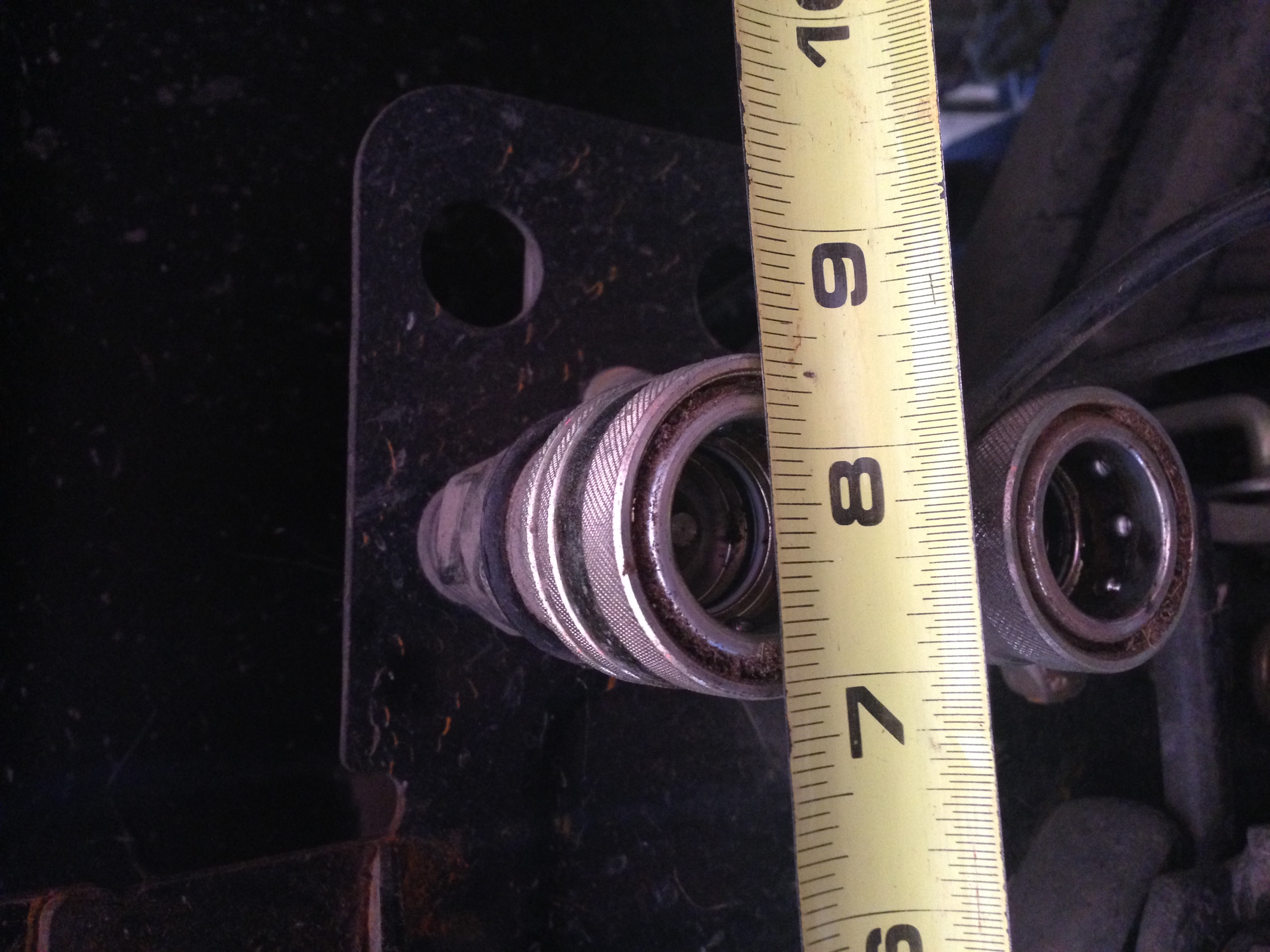

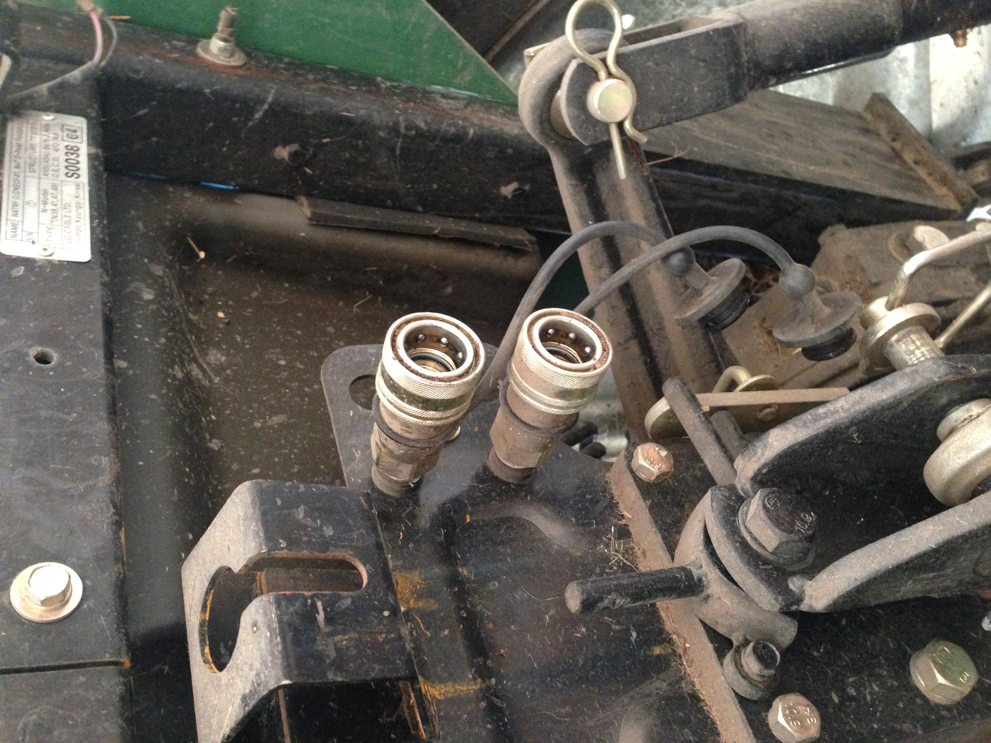

Also, can someone help me identify the type of connectors I need?

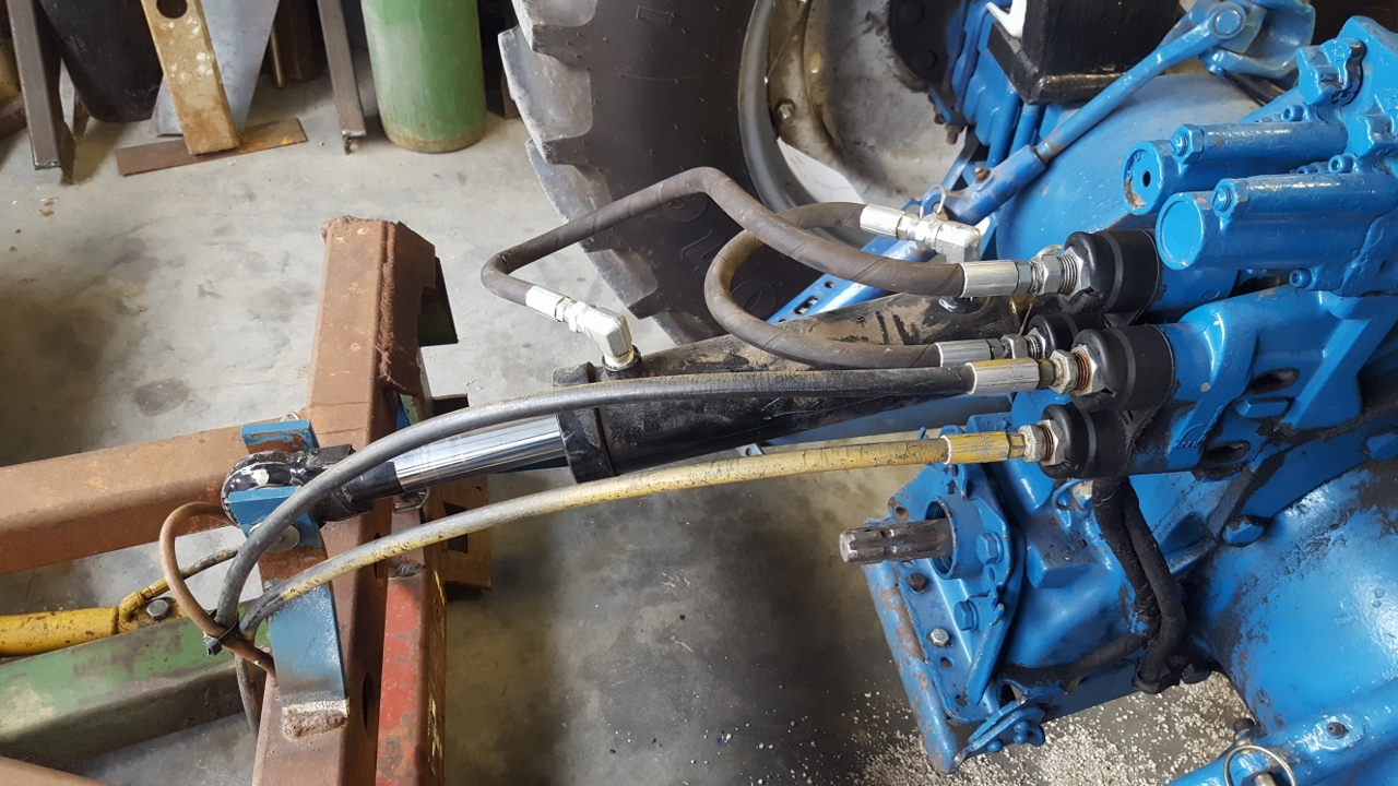

If you study this you can order all the parts you need to complete this install from Surplus Center. Take some careful measurements for correct hose length. Go long. Consider the height variations involved in raising/lowering your 3pt. I also like to use 3/8" or smaller hose. It's not as bulky and flexes much better than 1/2".

Your couplings will have markings on them that will tell you the brand and model number. You will need that info and a cross reference guide to get the right QD fittings.

Also any guess on the quick connect fitting, i cant find it anywhere in the manual either (and the tractor is currently an hour away) (my understanding is that montanas are re-branded LS, so my guess would be the same fittings that LS uses.
