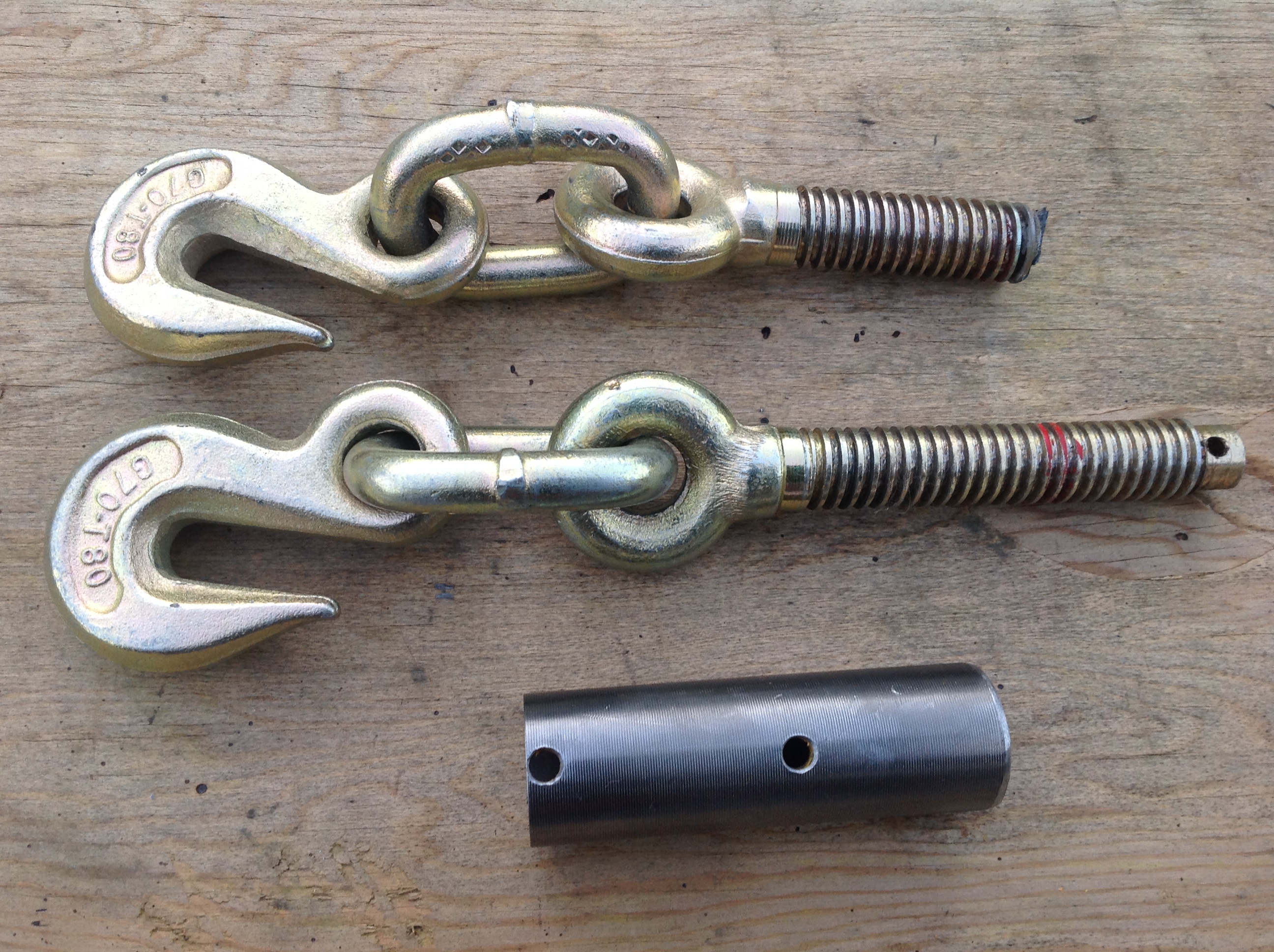

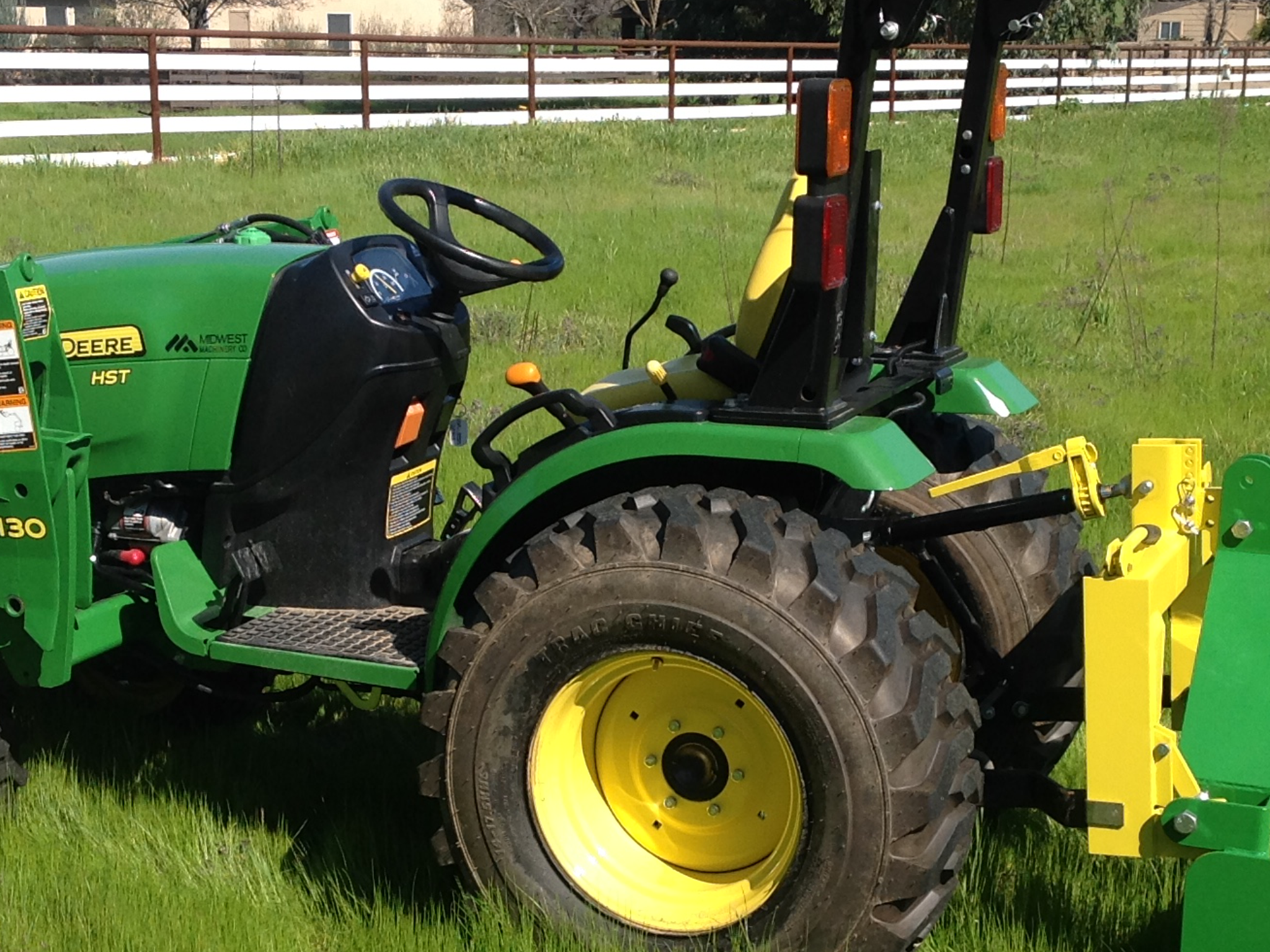

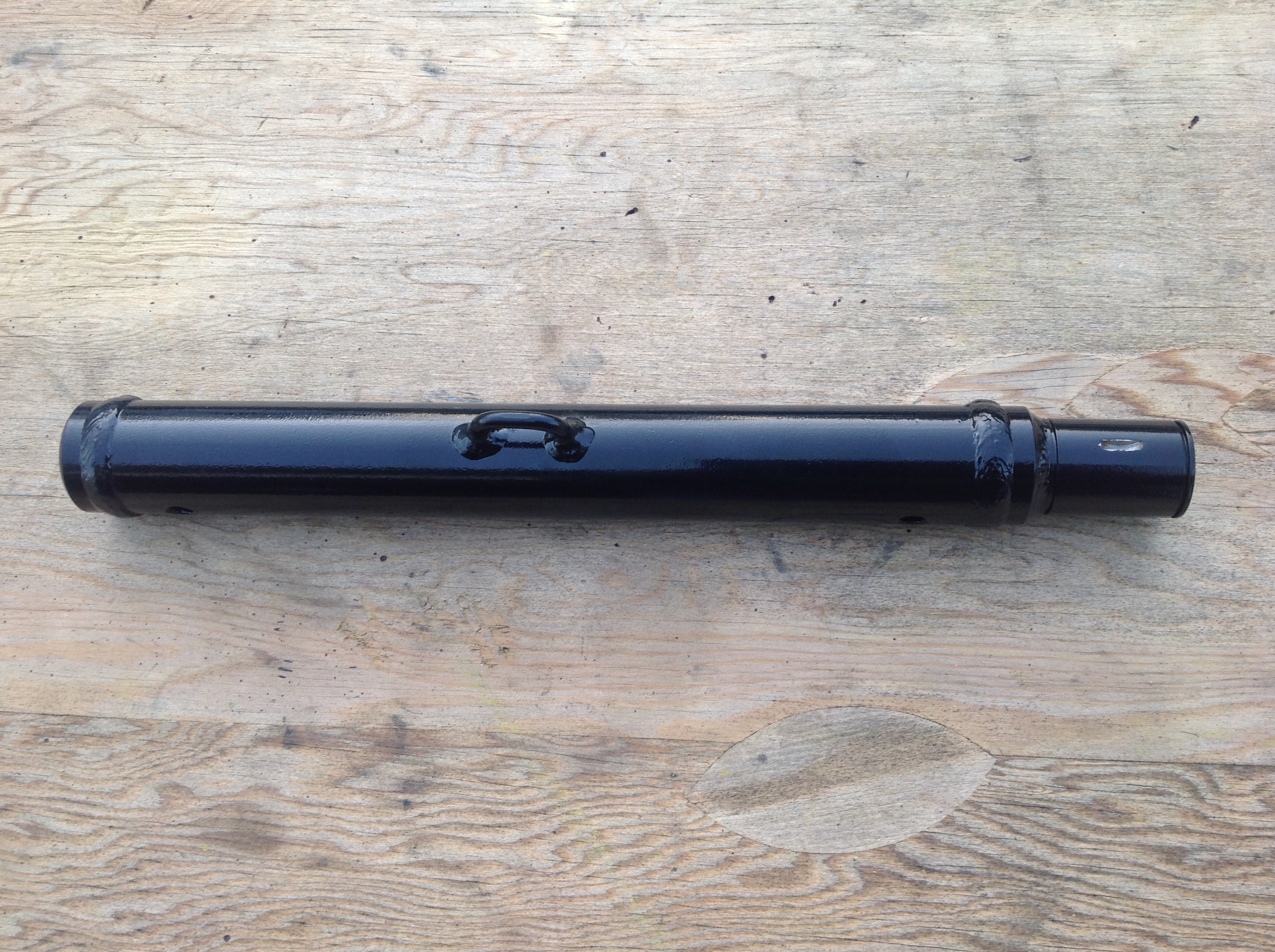

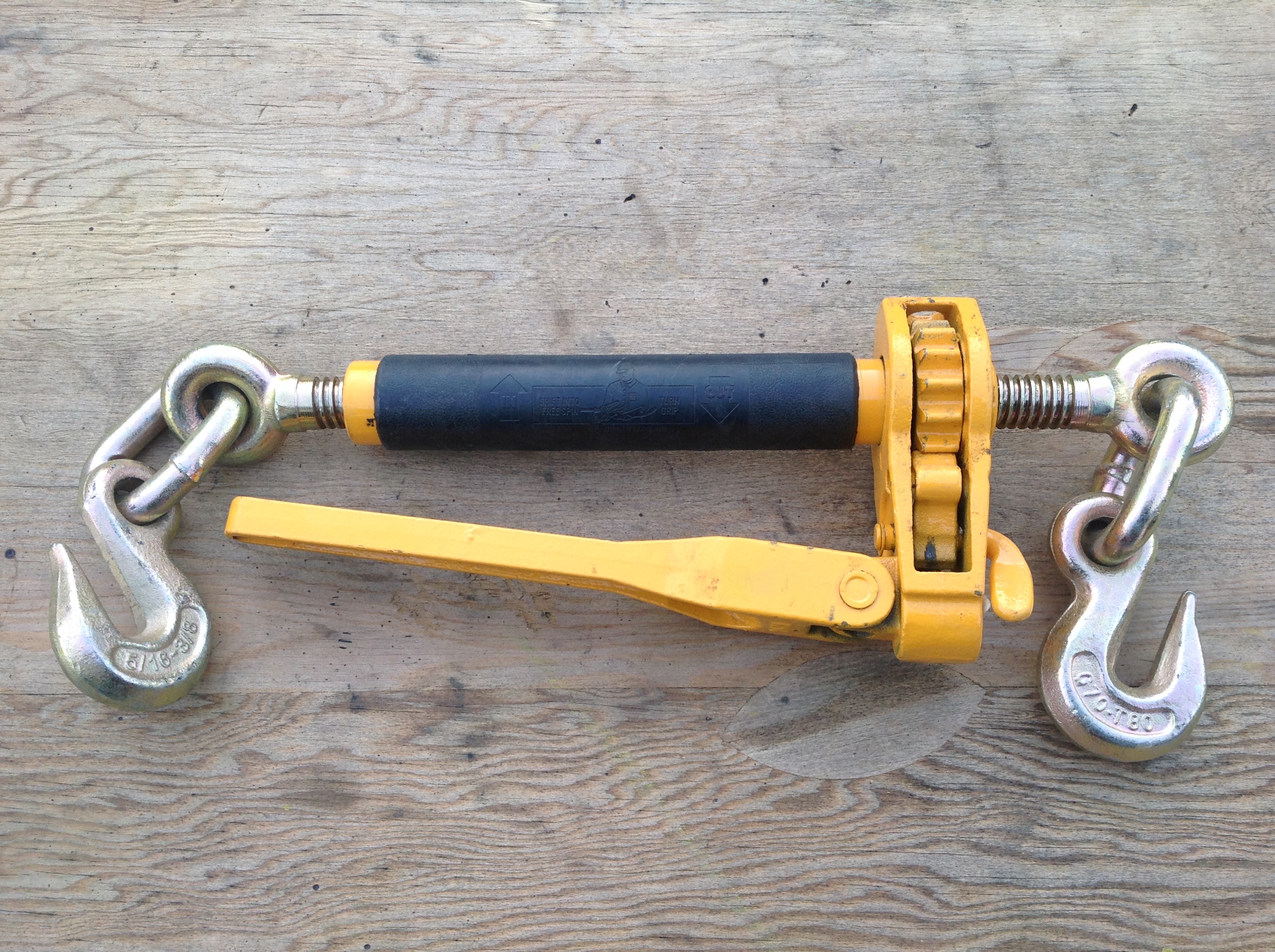

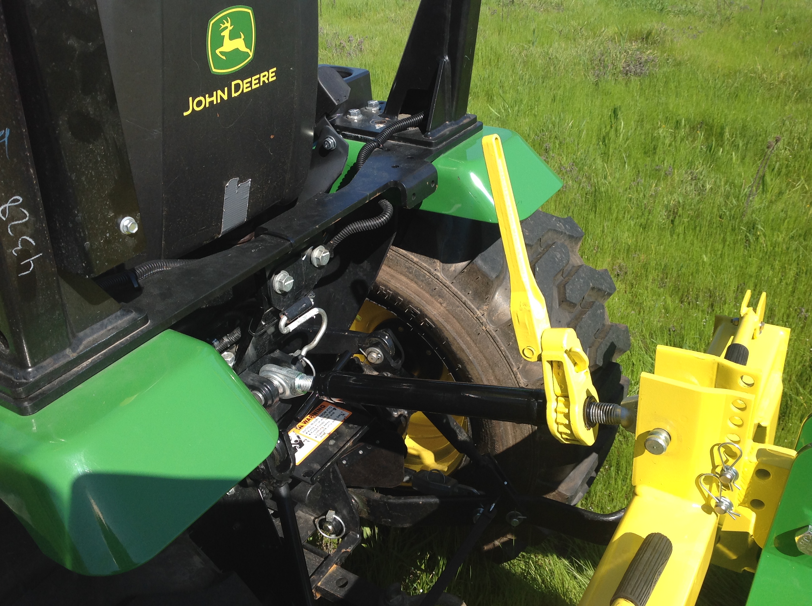

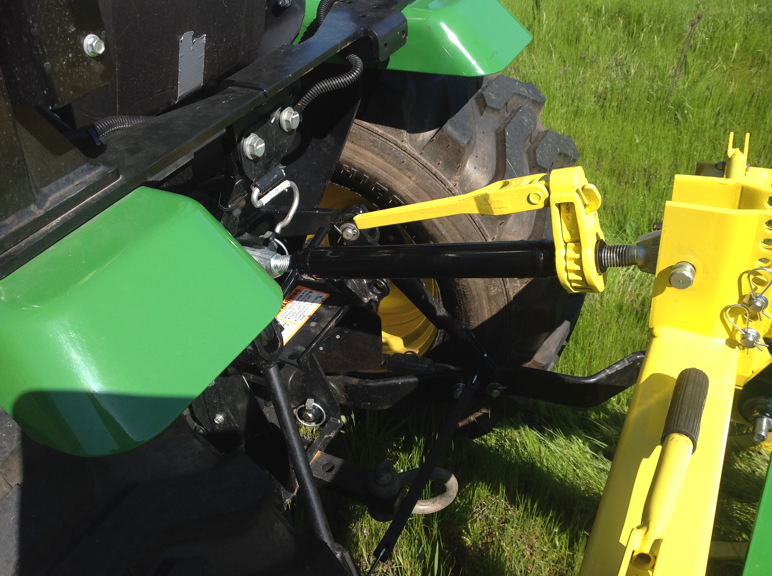

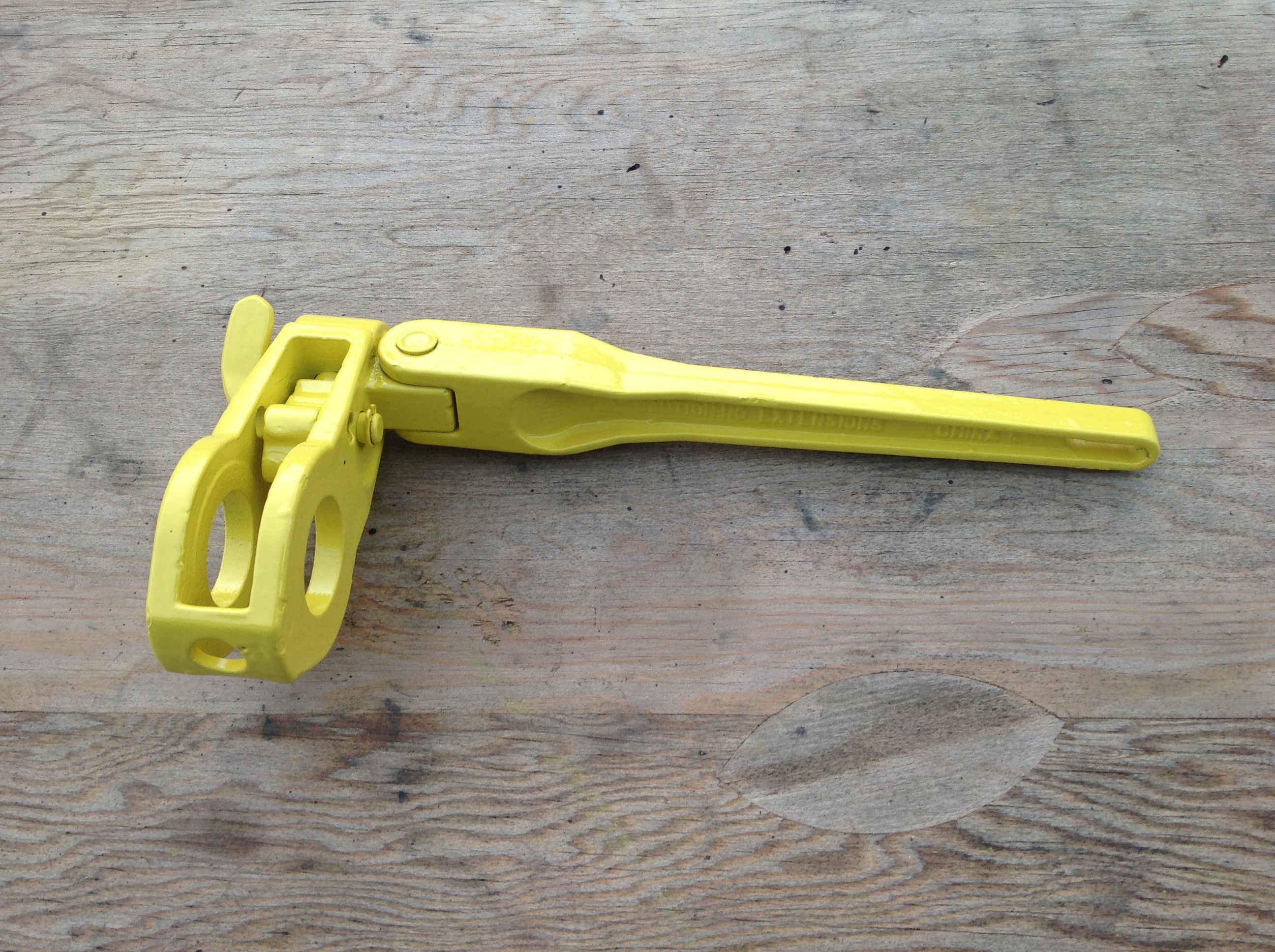

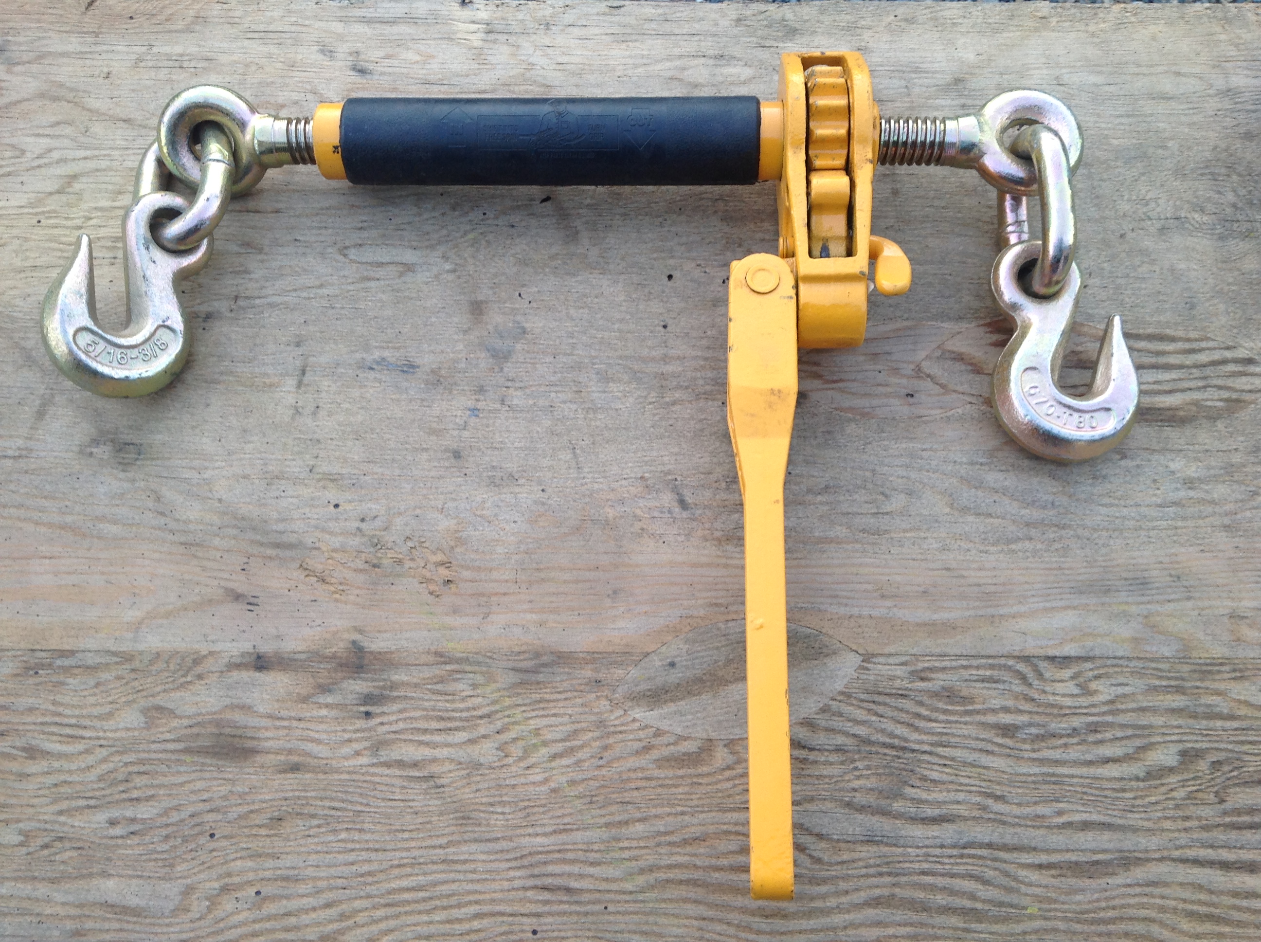

I cannot afford hydraulic TNT at the moment so I made a lever out of a chain binder to adjust my top link from the operators seat.
I took a 5/16" - 3/8" ratchet binder and used the parts from it to fabricate my top link.

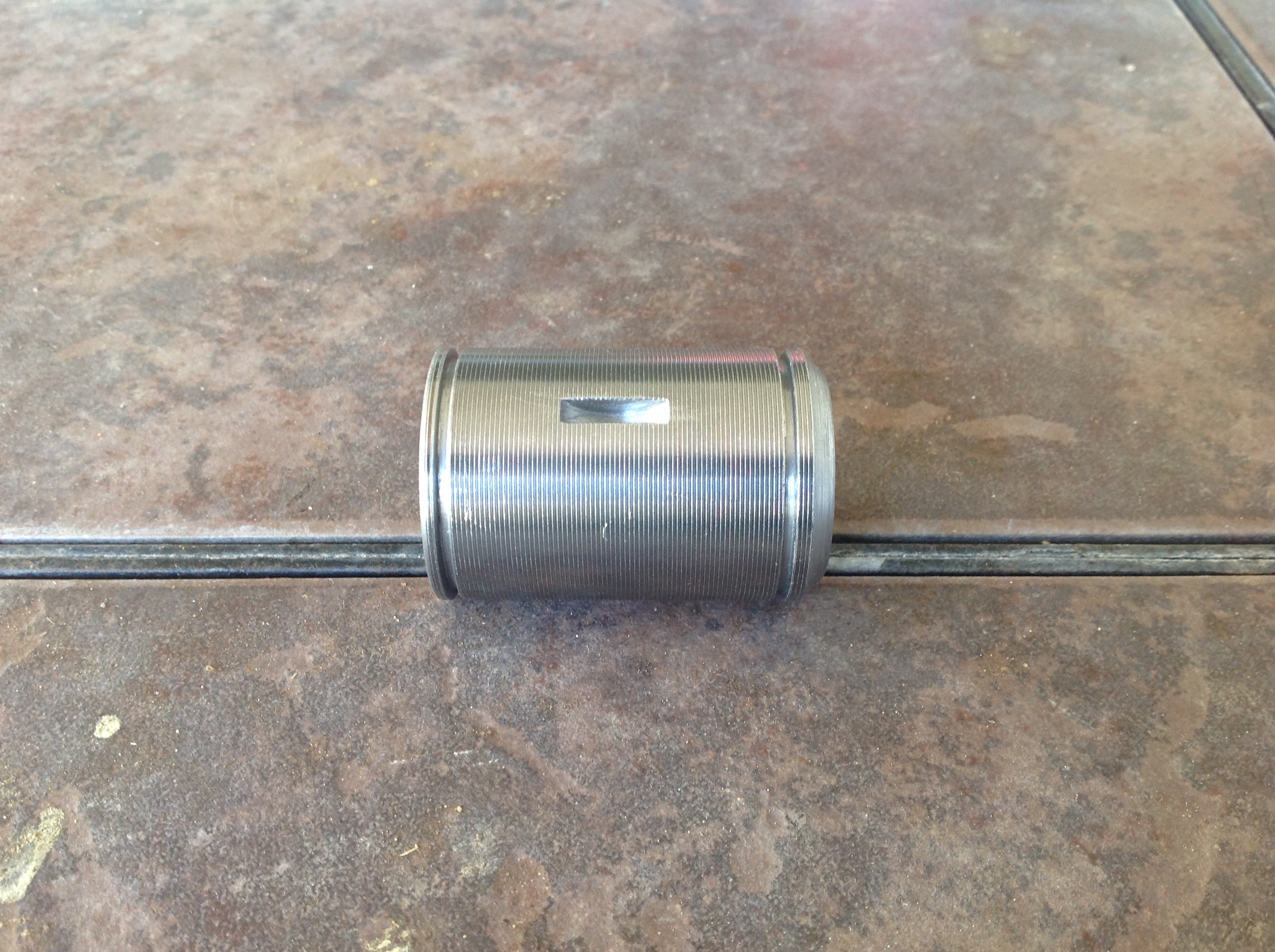

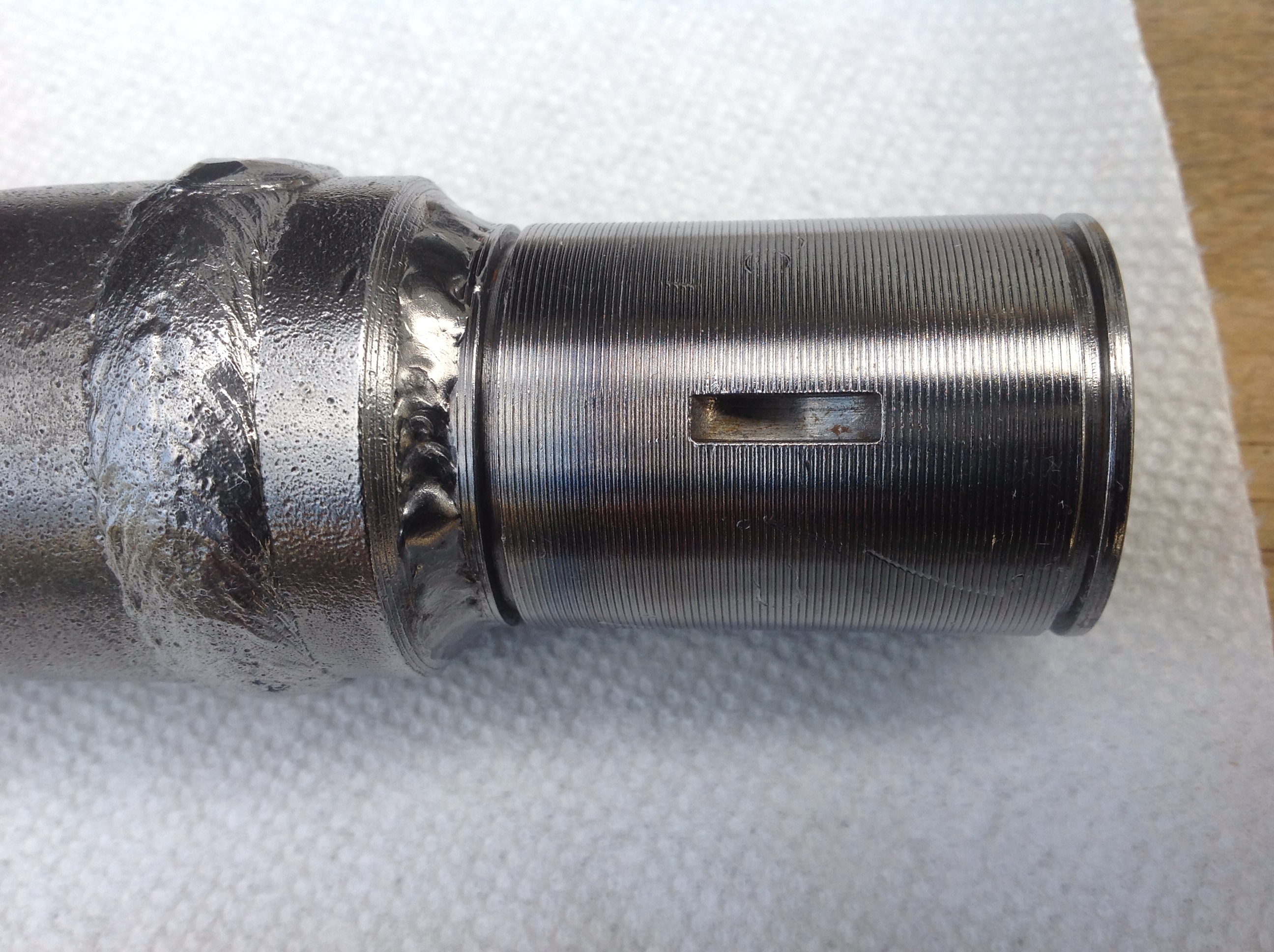

Cut off the plastic grip with a razor knife and you will notice that the holes for the roll pins are only drilled in one side of the cylinder, you will need to drill two more holes on the opposite side so you can drive out the roll pins to be able to unscrew the threads from the cylinder. I did not think about drilling out two holes and I used a chop saw.

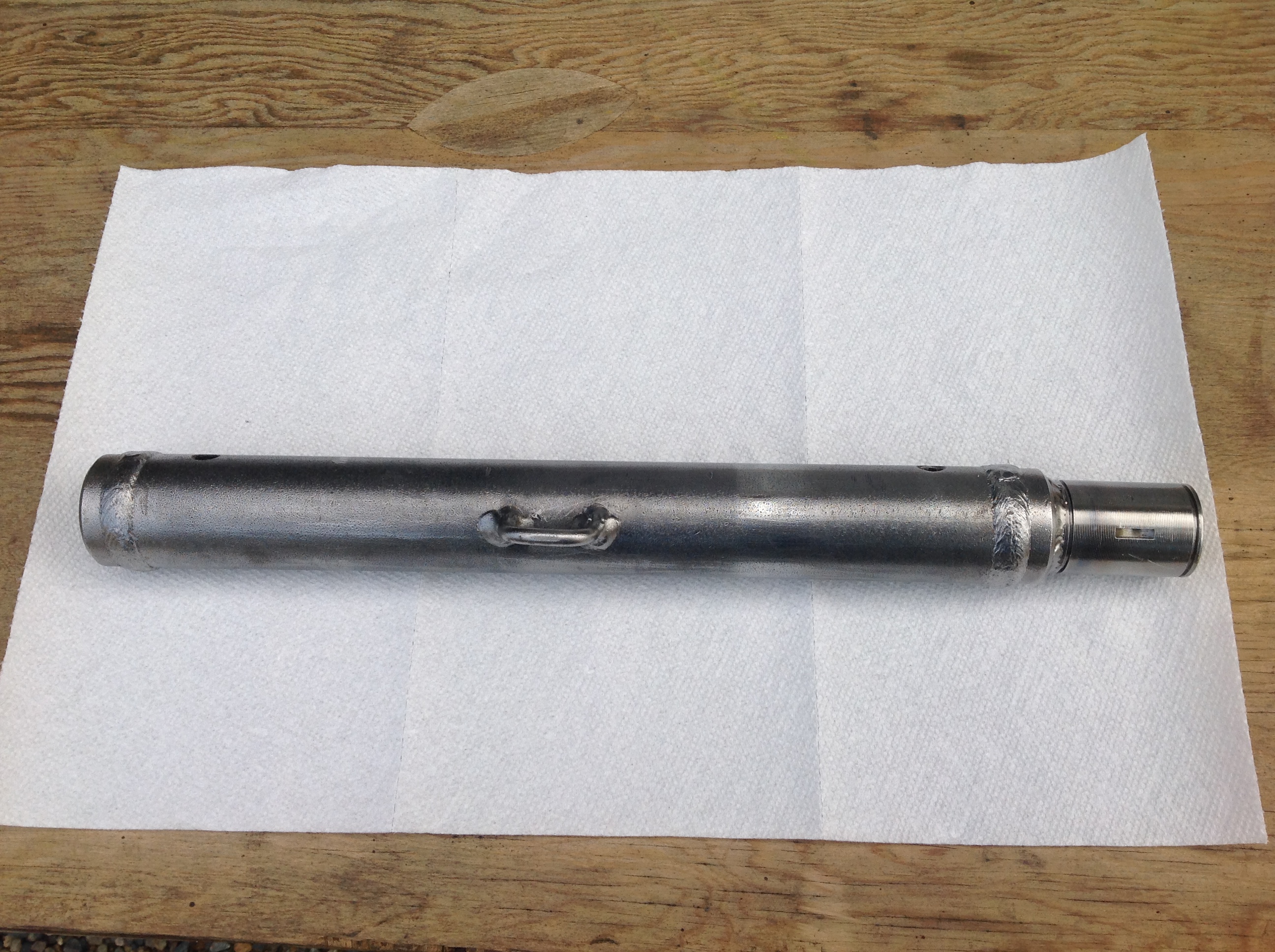

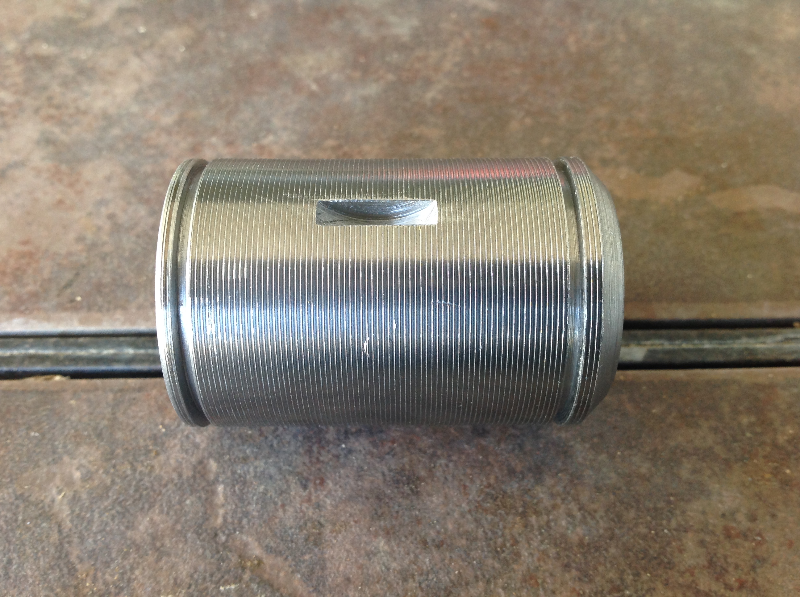

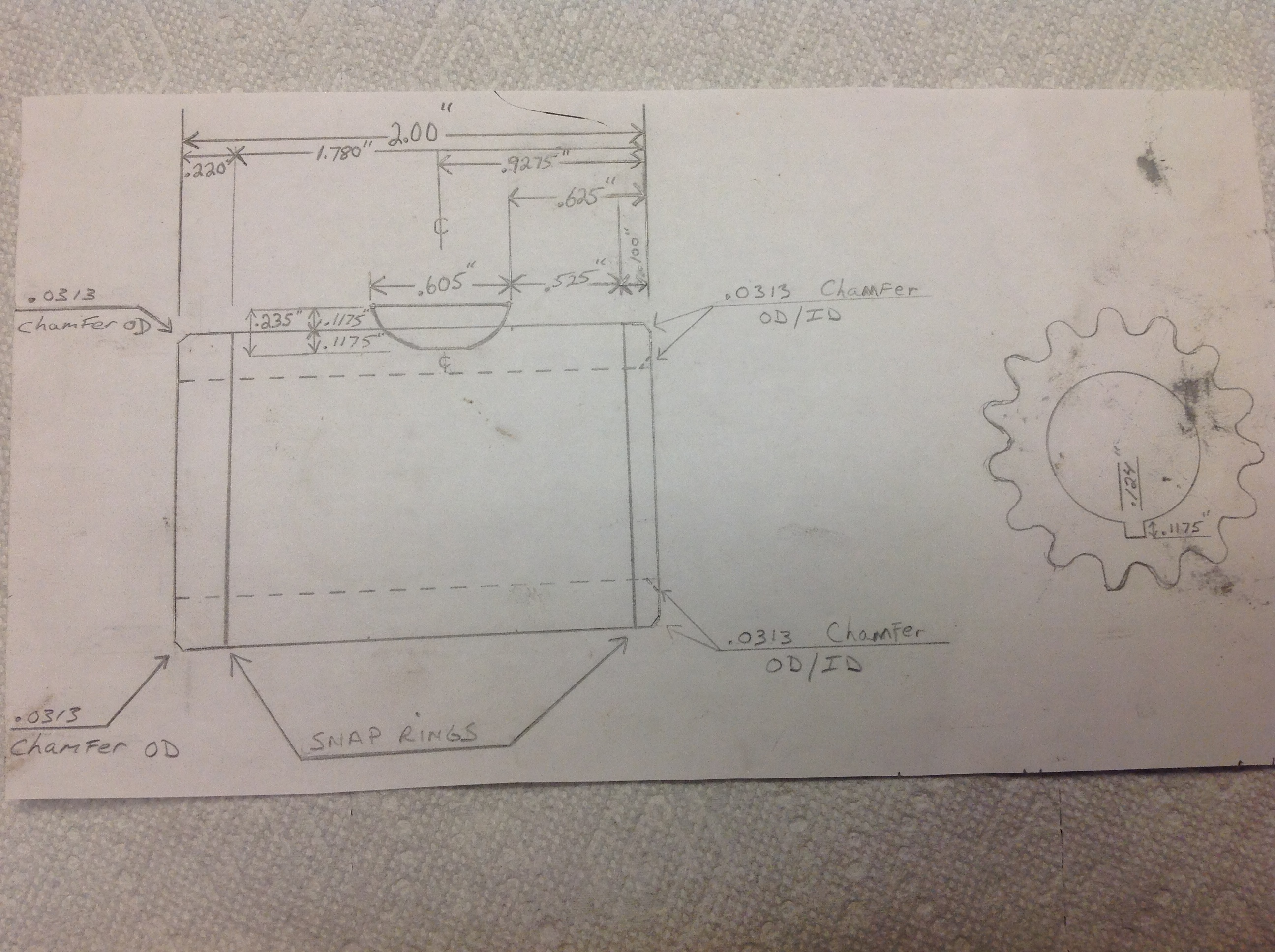

I cut a 2" section out of the cylinder that did not have internal threads and machined two snap ring groves and I cut a slot for a woodruff key.

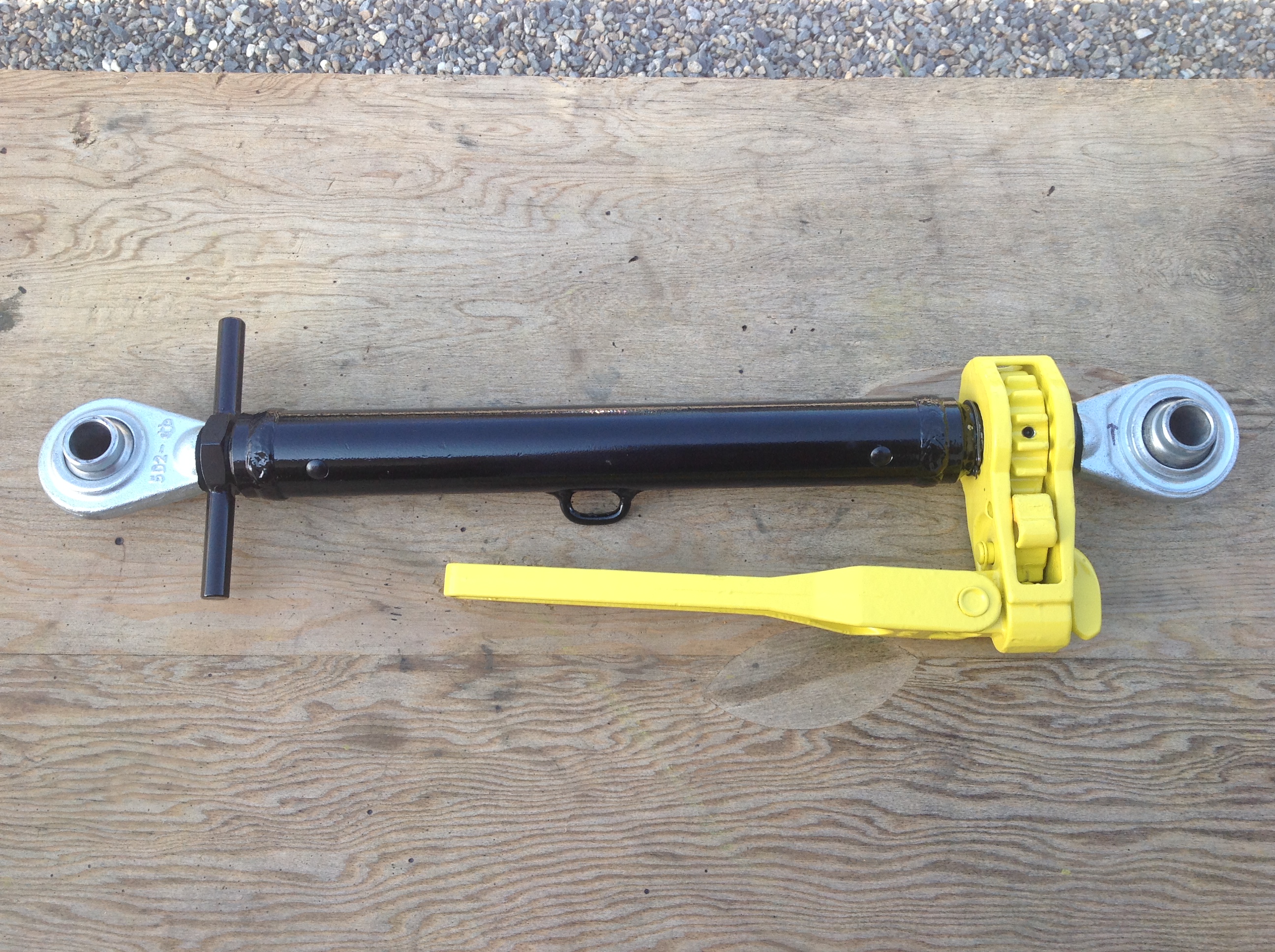

Then I TIG welded the part to the end of the top link and painted the top link.

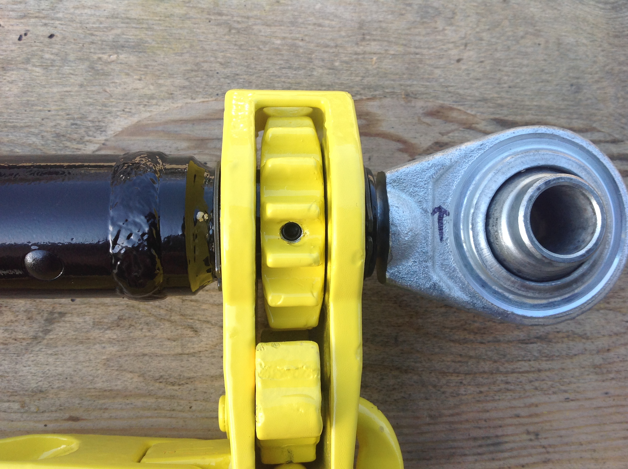

I then drilled four holes in the sprocket and tapped 1/4-20" threads for Alan screws, and I filed a notch for the woodruff key.
I then assembled the parts.

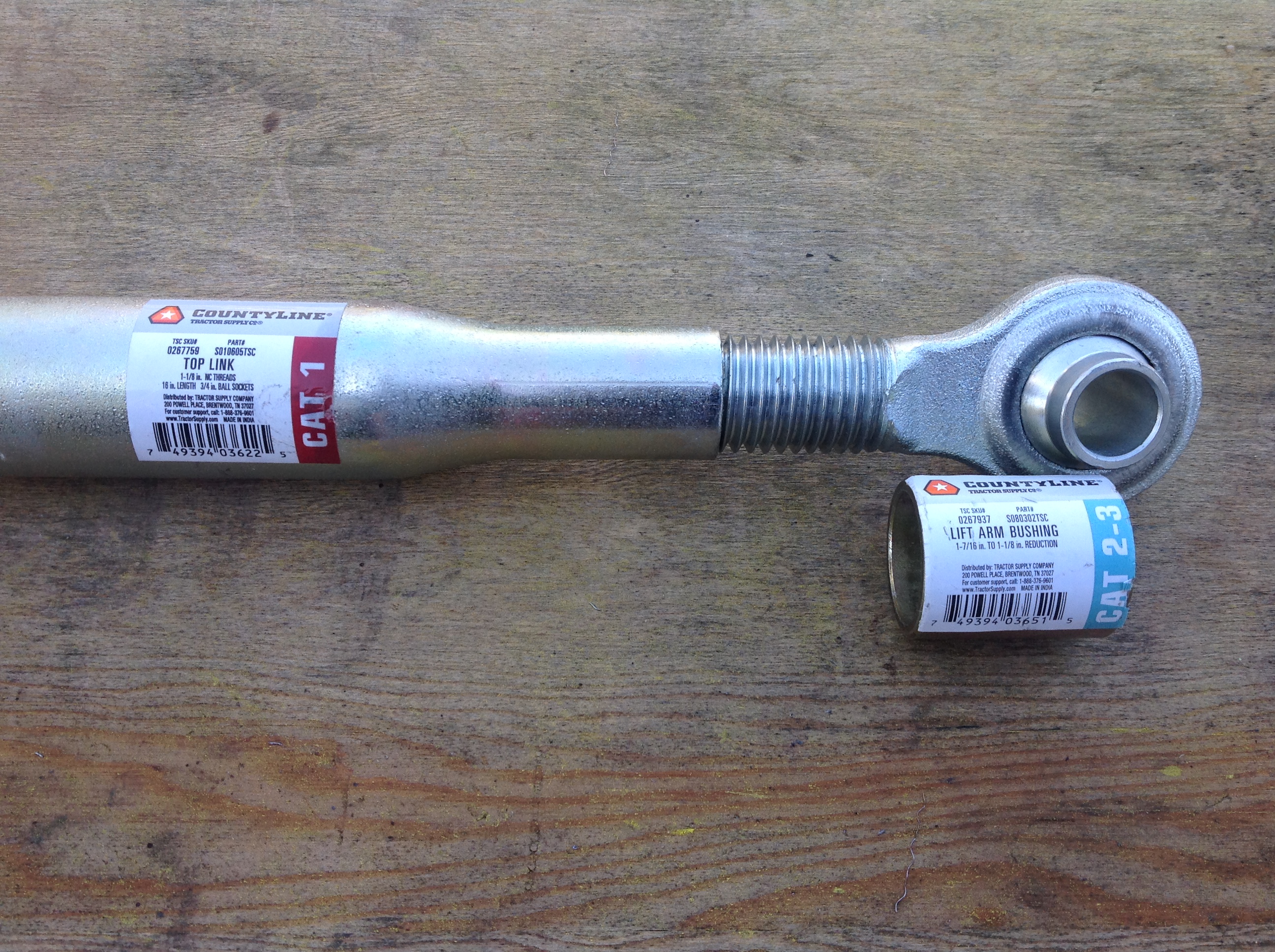

The diameter of the top link tube on my John Deere was to big for the diameter of the ratchet handle, that's why I had to weld a piece of the tube from the binder to the end of the top link, if your top link threads diameter are to big to go inside the 2" collar, you can use a TSC top link, the diameter of the tube is almost the same as the ratchet handle and sprocket gear, you could take a catagory 2-3 bushing and machine the inside diameter, slide it over the top link and weld it in place and then machine the outside diameter to fit the ratchet handle, it's not much bigger and you would not lose the 2" of adjustment if thats an issue for you, or you could come up with your own creative way to attach it.
View attachment 500324View attachment 500325

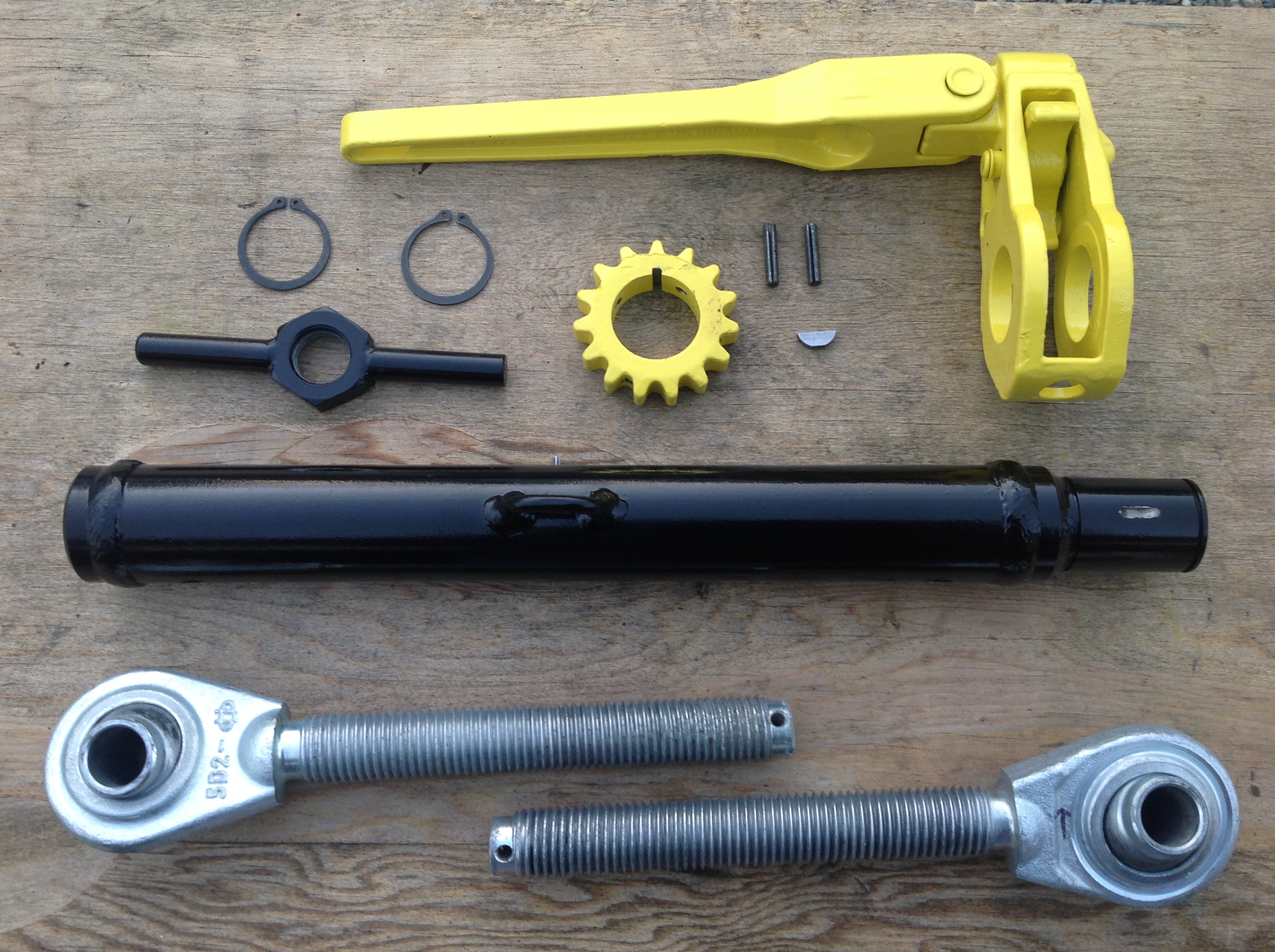

View attachment 500328View attachment 500329View attachment 500330

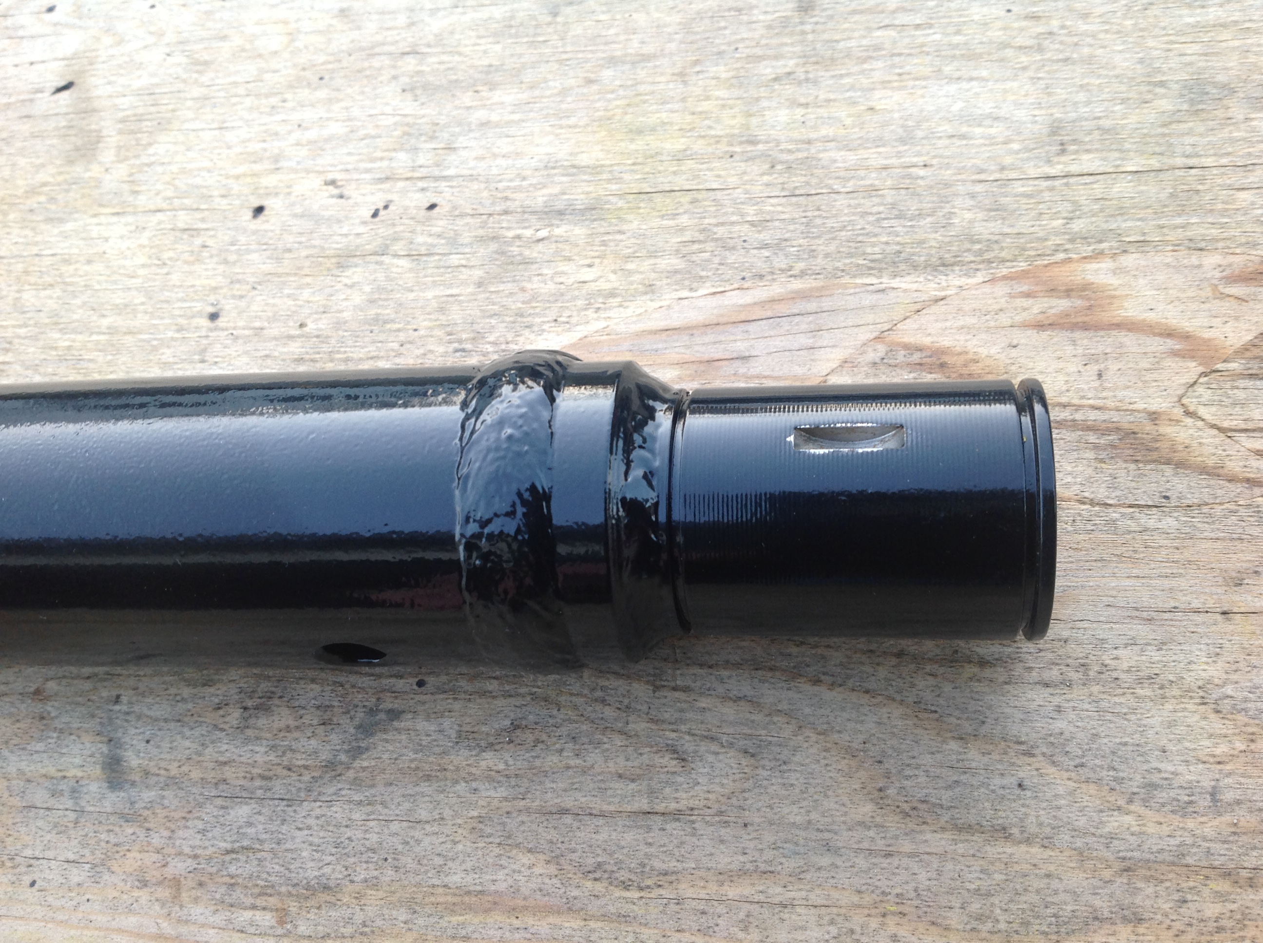

View attachment 500331View attachment 500332View attachment 500333View attachment 500334

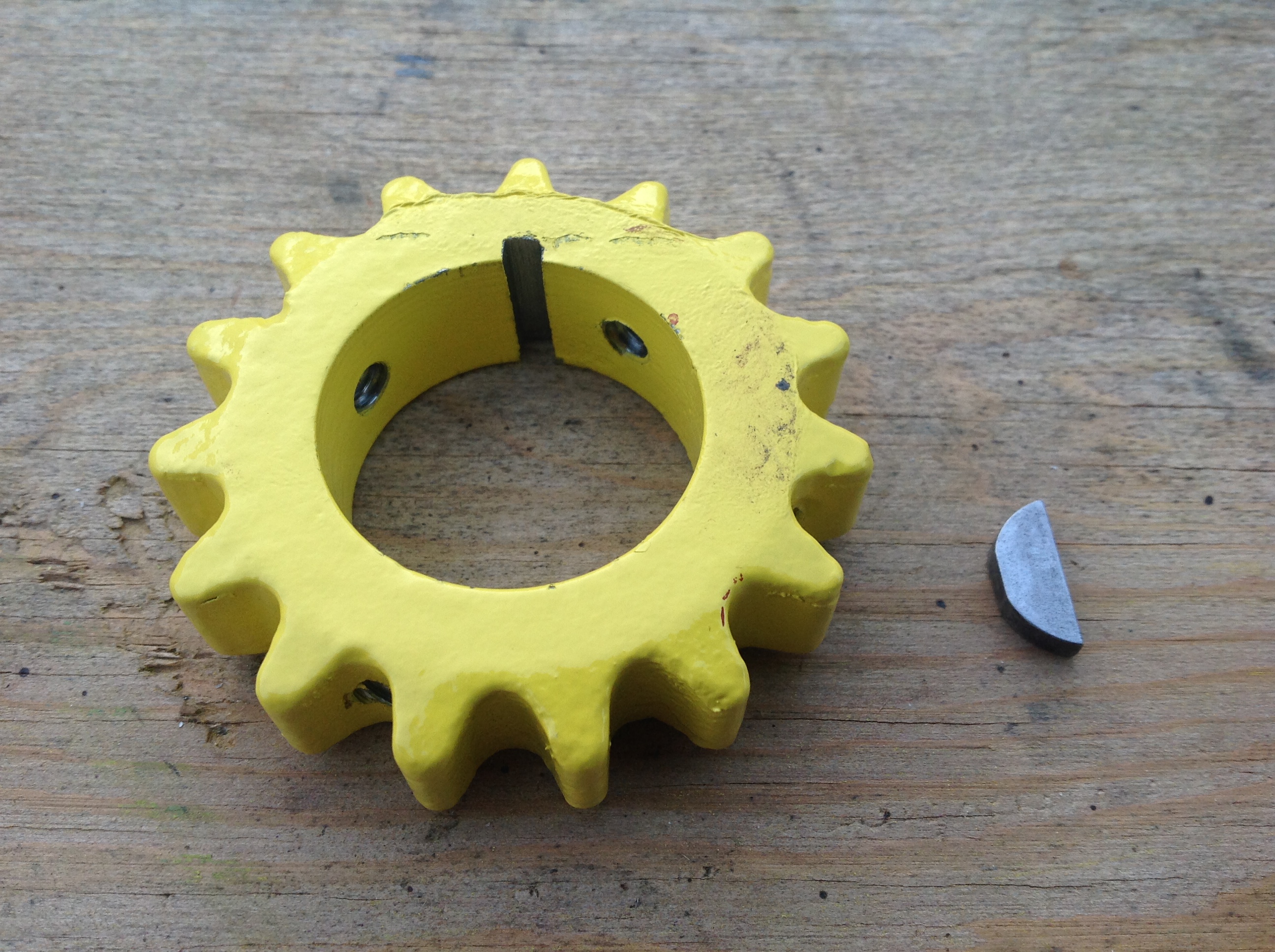

View attachment 500337View attachment 500336View attachment 500338
I bought a "Ratchet Jack" from Agri-Supply, and changed the clevis ends to standard 3pt. threaded ball ends, achieving a similar result, but without the folding ratchet handle.
The Agri-Supply SKU is 38124, and the cost is $29.99 + the cost for the threaded ball ends.
Your solution requires more work, but I think I like your result (folding handle) better.

After I bought my tractor I was surprised to see such a Stone Age device being used to adjust the three point, you think the tractor manufacturers would have done some improvements over the years to make the adjustment more user friendly. Before I built my ratchet top link I did do some research and found others who had the same idea but did not use a folding handle. Just curious, what is the Ratchet Jack used for in its original form before you converted it.
If you could figure out a way to make the handle fold down it would be like mine and would be cheaper, because that ratchet binder I used is not cheap.

I searched for one on google and this is the only one I found but it looks like you need to remove the handle if you don't want it sticking up. I wanted one that folded, so I figured why not just build one, fun project.

My only concern with a handle sticking up is that I would raise my three point and crush the handle into the back of the tractor, if I was using a box blade and was constantly adjusting the top link I would hate to insert and remove a handle each time. I'm sure it would be easy to figure out a way to make the handle fold down and then you would be good to go for a good price,
