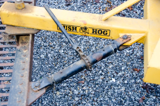

Excellent examples Dennis.
See them a lot on older Batwing cutters. Used to level hitch as your pictures shows and to level rear wheel assemblies.
   / Top link ratchet adjustment #22
It can now be used instead of a hydraulic cylinder. Ratchet jacks came first and were replaced by hydraulic cylinders.

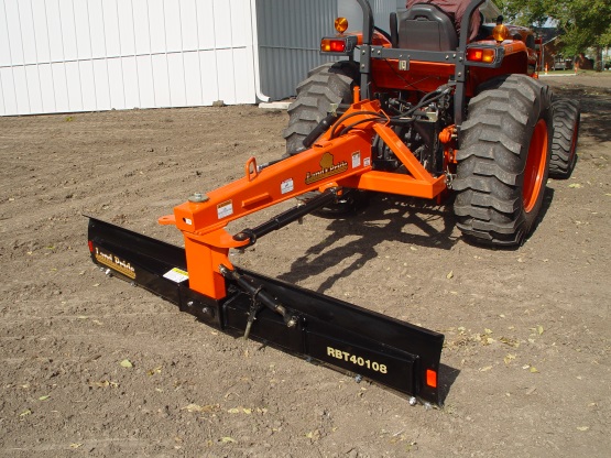

Thanks for these photos!
I am the OP for modifying a ratchet jack for a top link, but you have now given me another idea!
I have an 84" back blade that can be manually offset, but it is an absolute bugger to do so manually.
At 76 years old, I must pull up to a pole, and use a come-a-long to shift the blade sideways.
Several times each year I like to reach way outside the driveway traveled surface, and bring all the loose material back in.
Using a ratchet jack, as in your photo, would allow me to offset my blade much more easily.

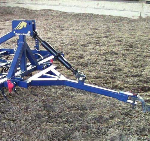

Here is a close up of a ratchet jack to change the angle on a landscape rake:

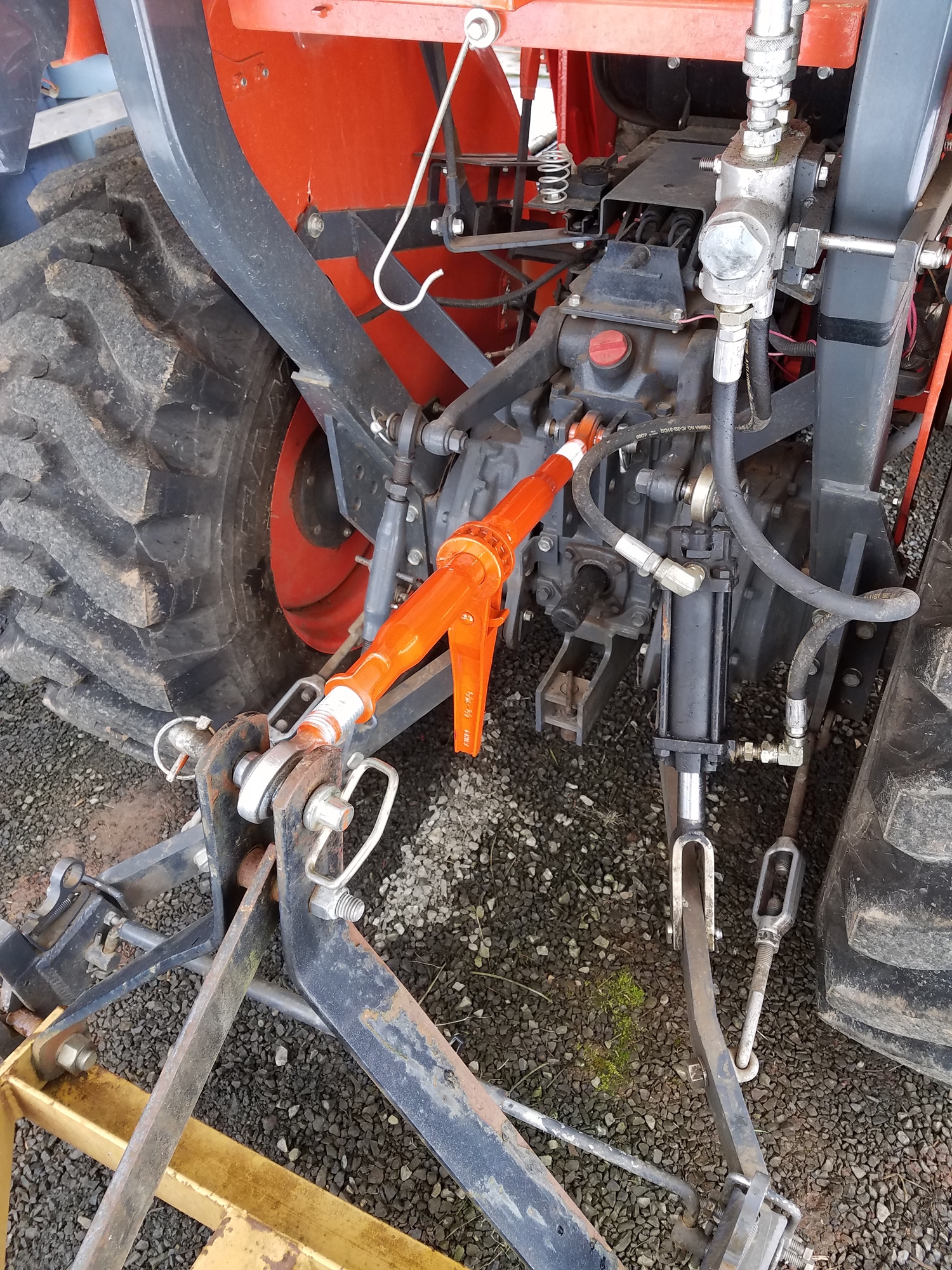

In mine I used a $23 toplink and a $31 Harbor Freight binder. A little cutting and welding. Total time to build from start to finish (including painting), 2 1/2 hours.

I thought that this already existed! I have been thinking about doing the same thing for 6 years. You gotta market that man!
   / Top link ratchet adjustment #29
I agree - market it!
That said, I'm wondering if anyone has attempted the same thing for a lift arm adjustment? My new JD's one major negative is the lack of a reasonable leveling mechanism for the 3 pt. It has leveling but I have to get off the tractor and use a very awkward adjustment that is just ridiculous in my opinion. On my old For 8n, I could crank the leveling mechanism from the seat, and I did. A lot. I use a grading blade a lot and not having a simple leveling mechanism is a real PITA. The JD system is designed to be set once and forgotten, and that doesn't work for me.
So, why wouldn't this work as a leveler? Would it be strong enough? (2200 lb lift capacity). It would have to avoid interference with the tires.
