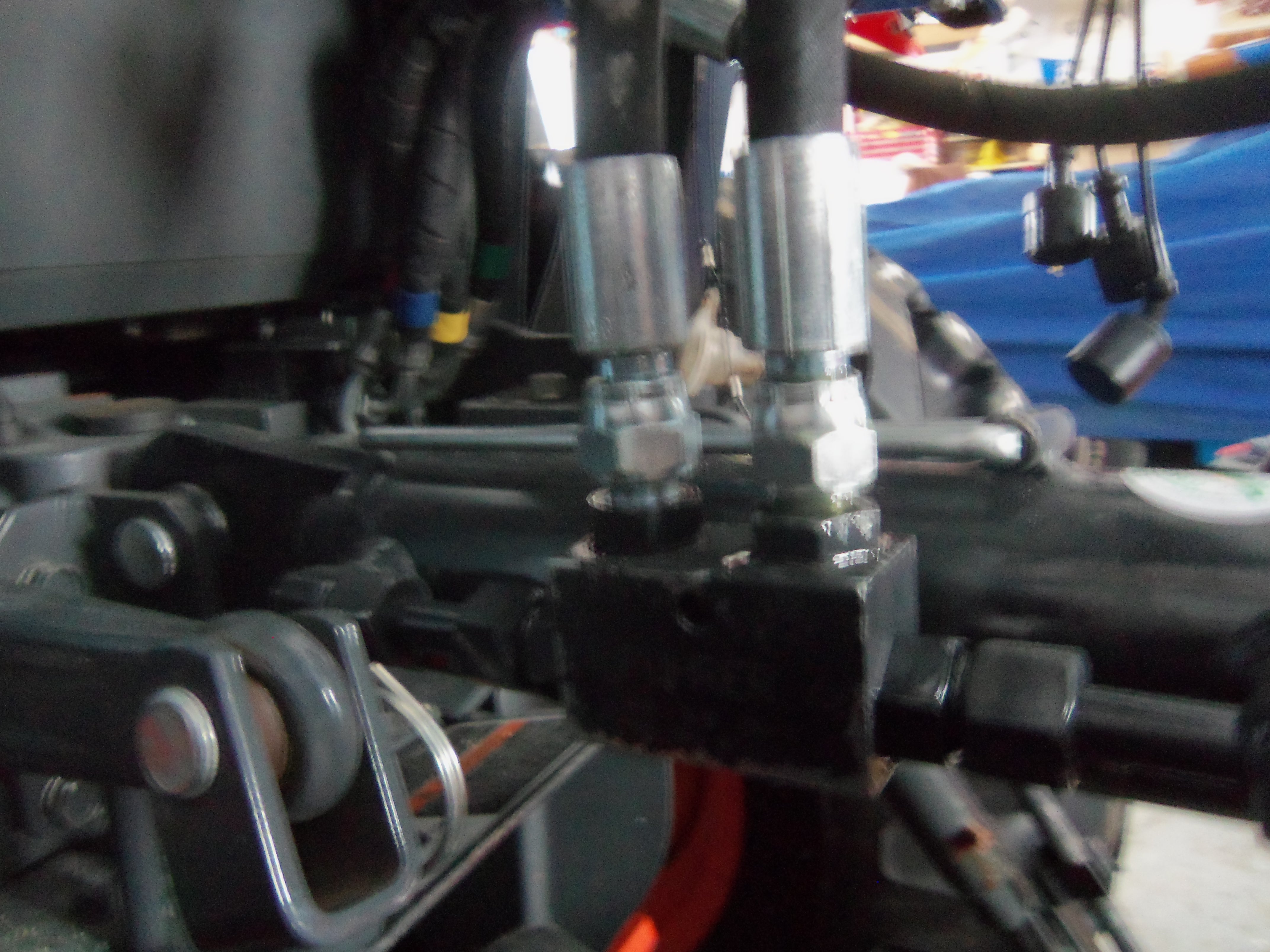

Here a pic of my top link will get better one on soon

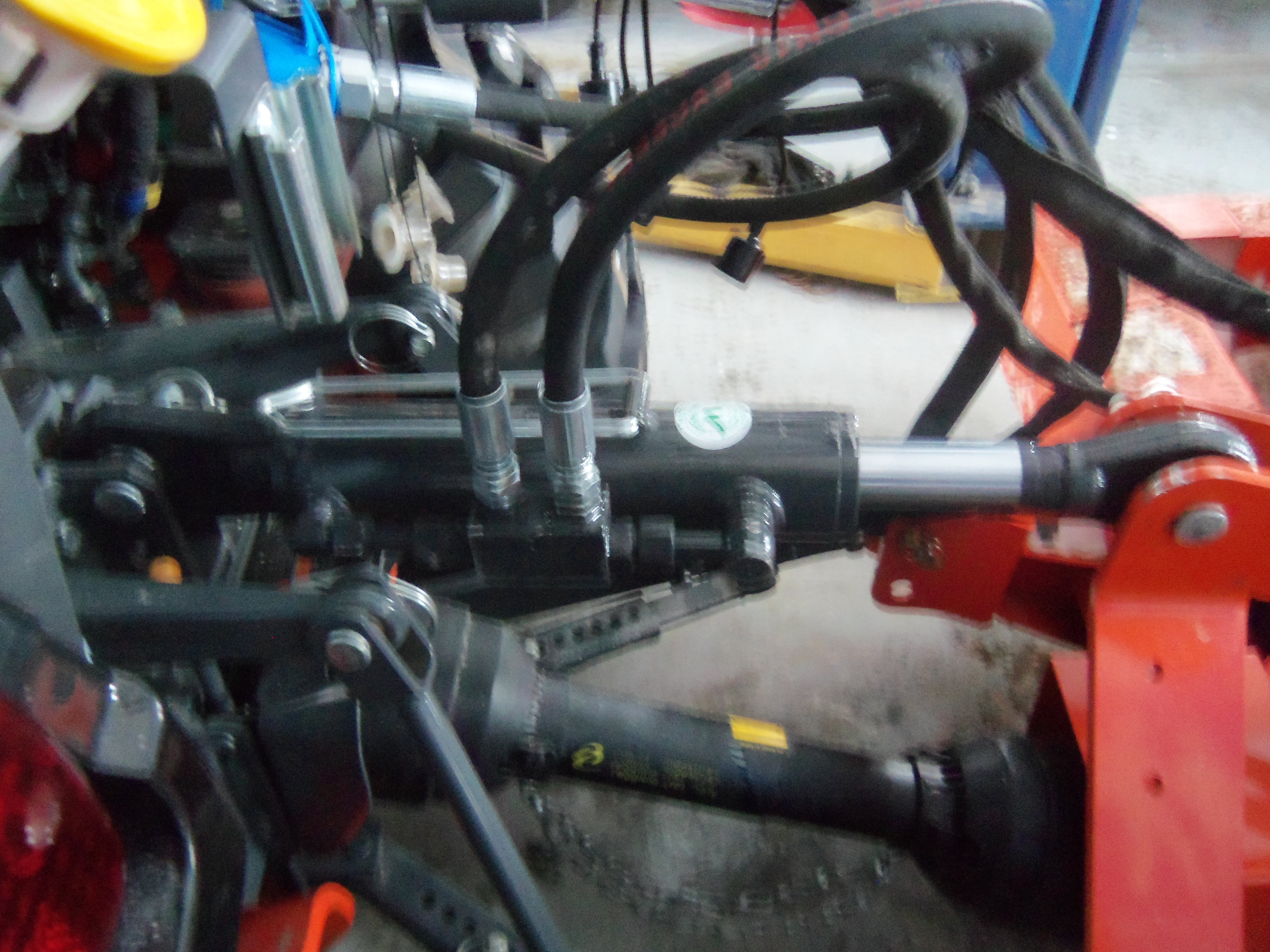

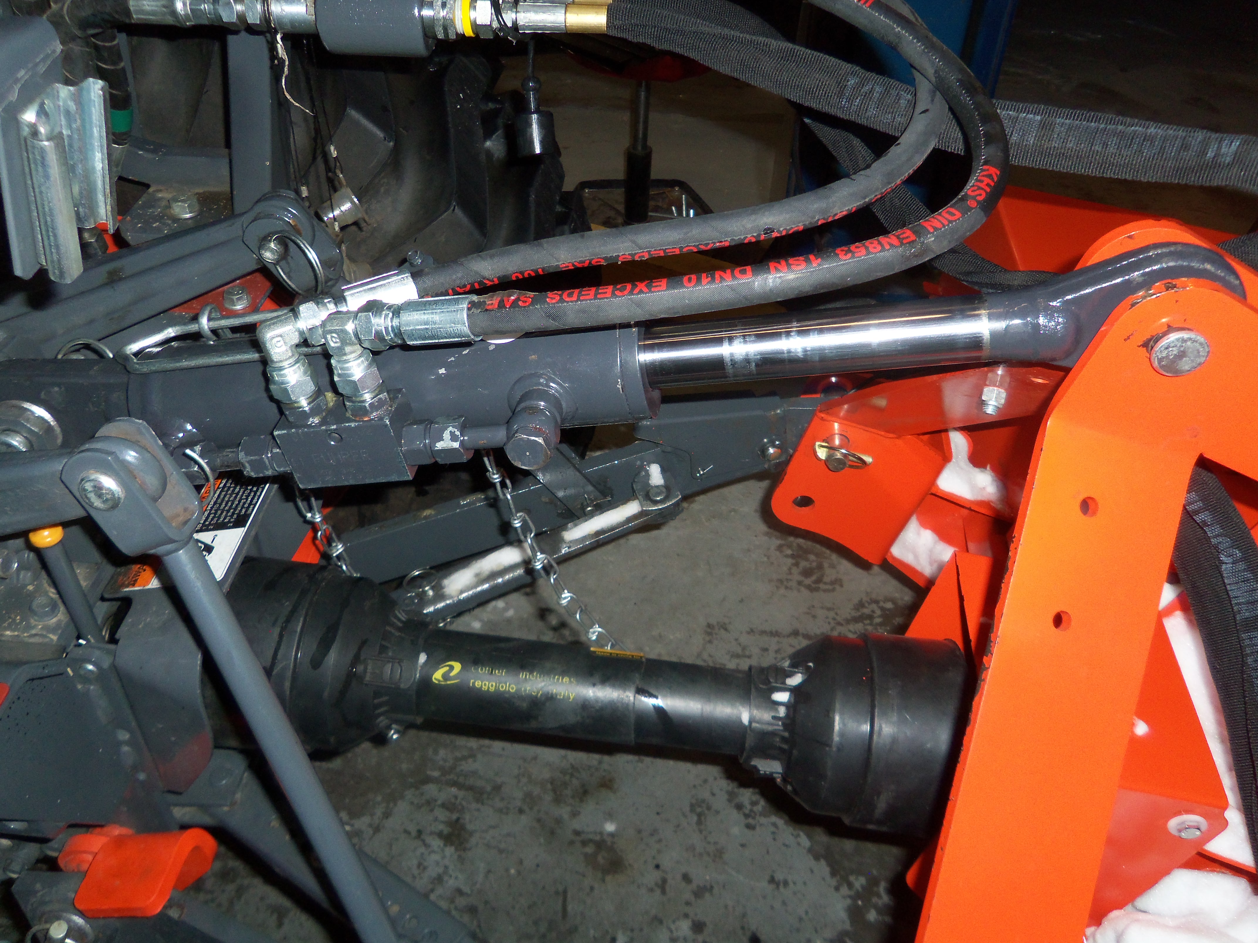

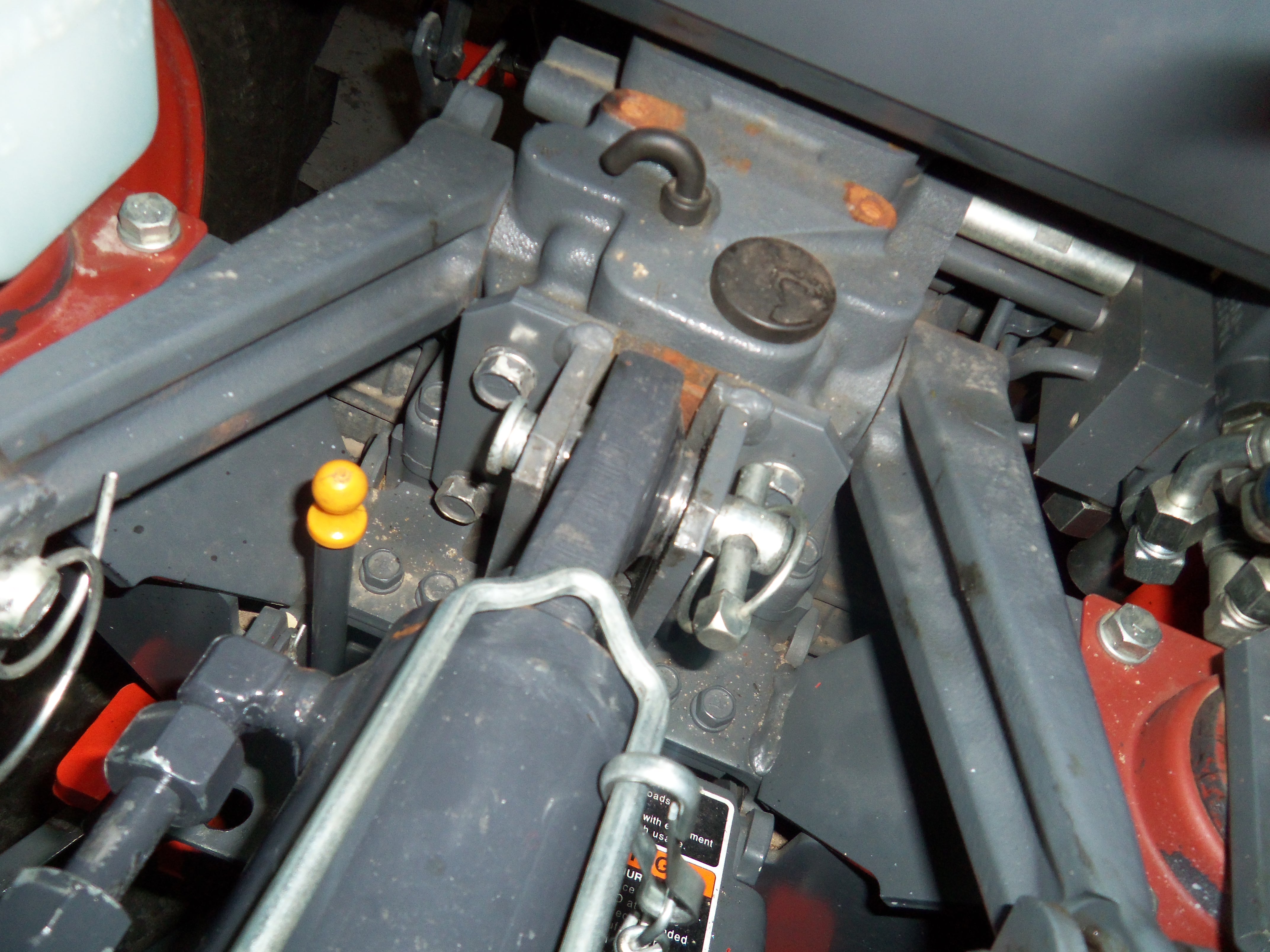

just whent in shop got a few pics. The stroke is about 7 inch
