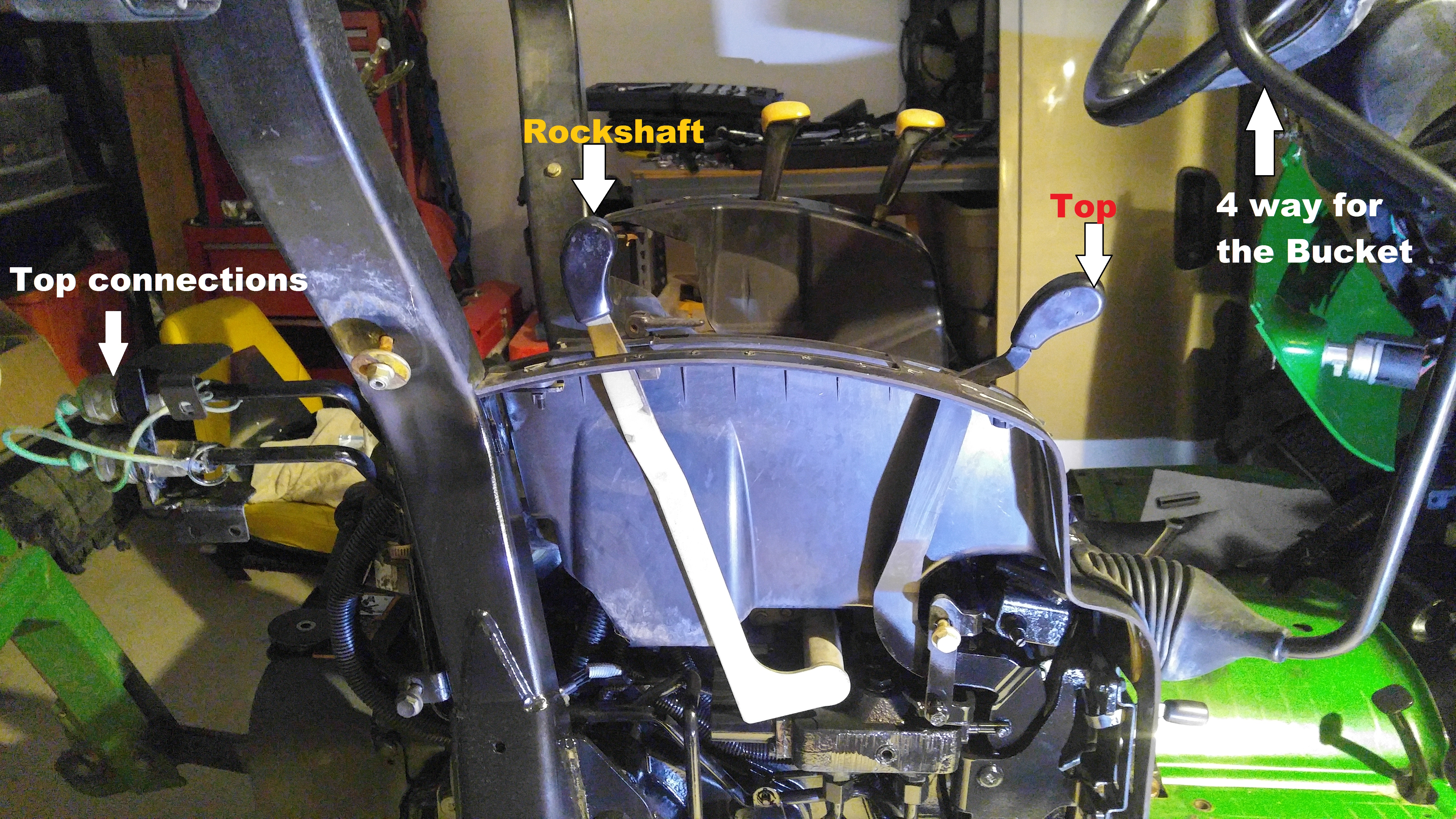

Hello Everyone,
As I posted before my husband has been wanting to add a tilt function to the John Deere 4310 tractor.
here is the progress:
We have an existing top link,
He added a side link hydraulic.
We bought Side Link Cat. 1: 16 1/8" - 22 7/16" by Agri-store USA
Category 1 hydraulic Double piloted check valve prevents drift 6 inch stroke from 16-22"
High quality ball ends on both sides 6700 lbs pushing, 4300 lbs lifting.
Now I need to plumb the lines. it was suggested to save money use a diverter
https://www.amazon.com/CHIEF-Directional-Control-Valve-Joystick/dp/B009066MFW/ref=pd_rhf_dp_p_img_3?_encoding=UTF8&psc=1&refRID=F8TJPHV20AR99MT9DBTQ
or unplug 2 hydraulic lines on my loader & plug in the side link when I need it.......
He would like to take the top link connections & change it to a 4 way stick, as on my front loader. bucket
Is this possible? Rather than a 12 volt 3rd function hydraulic valve kit or manual valve
Something like this?
https://www.amazon.com/CHIEF-Direct...coding=UTF8&psc=1&refRID=F8TJPHV20AR99MT9DBTQ
OR~
CHIEF-Directional-Control-Loader-Joysticks/dp/
With Float
Or what would you recommend???
Thanks
