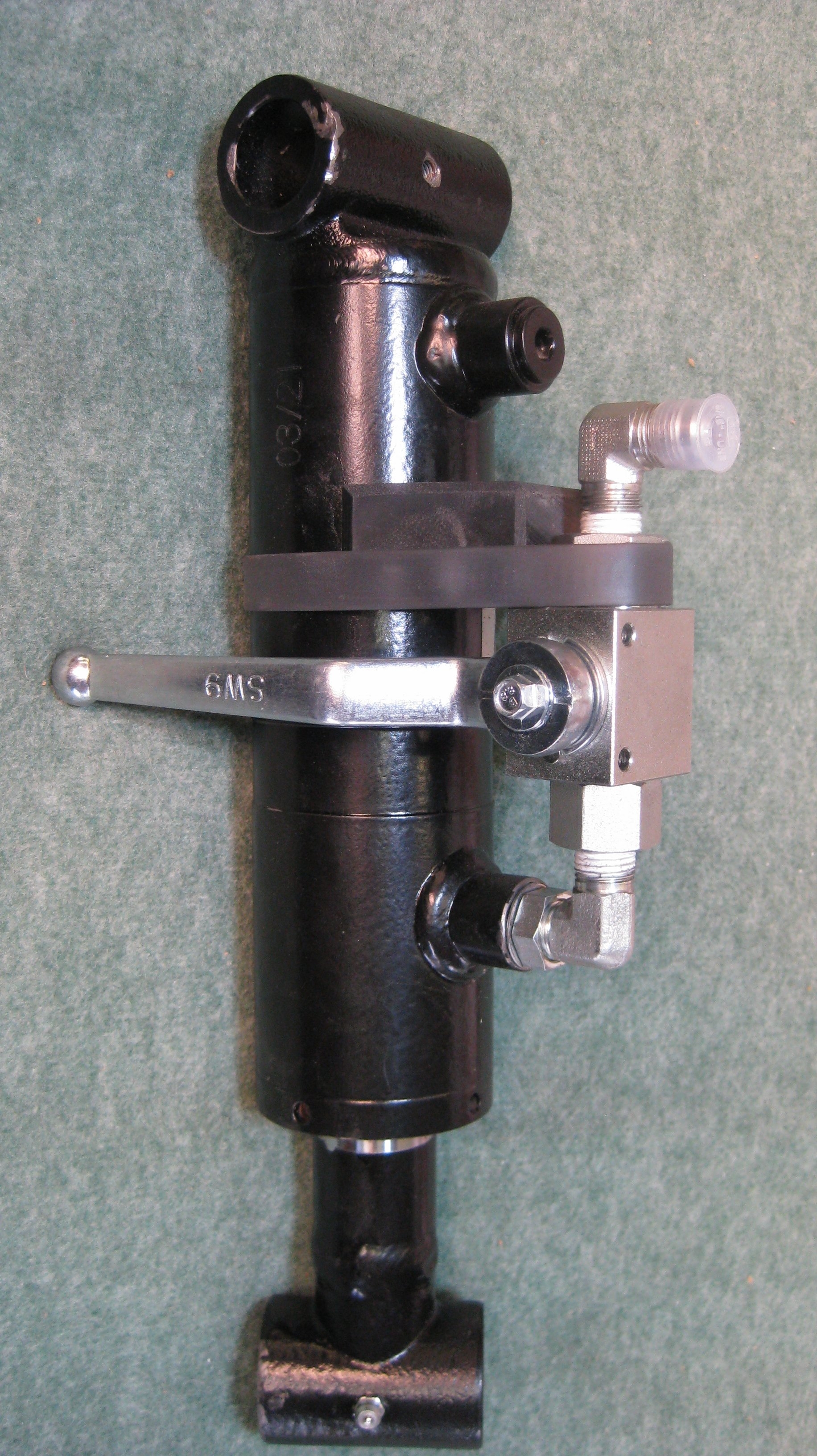

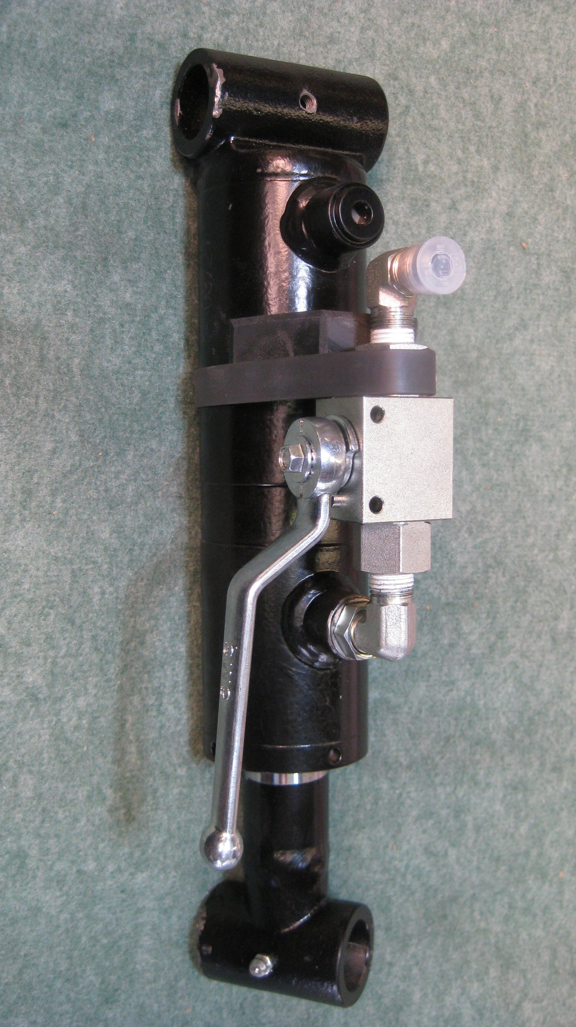

Another option to have in mind would be a simple on-off valve for the rod end connection.
This can be done either manually or with a electric valve.
If you find yourself needing to have the cylinder locked and unlocked on a regular basis, that is when it makes sense to have an electric on-off valve. If it is only say with a mower, then a manual on-off valve works well for the application.
