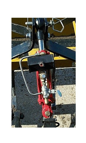

Here is the toplink. I will try to post more.

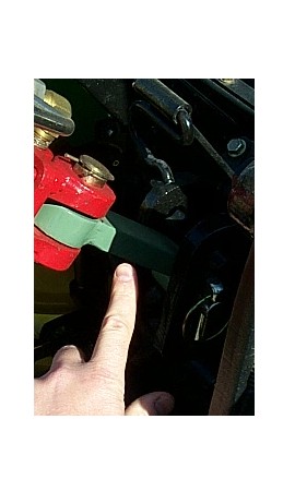

Here is the top view

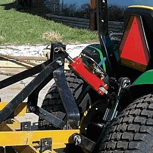

/ Toplink #43
This is the adapter I was talking about

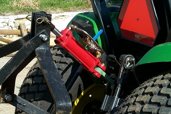

/ Toplink #44
close up

/ Toplink #47
I don't know anything about the bx2200. Although as I pointed out that adapter comes in various lengths. I am confused on what you want to know mikepa. You raise implement open valve to lengthen shaft (toplink) close valve to lock the desired length. Lower implement to ground open valve creep forward this forces shaft closed lock valve in desired length.

/ Toplink #49
Mike it works pretty slick. You do not have to get of your tractor to adjust the toplink just flip the valve. You can remote mount the valve to the rops if desired. The only thing is it is not powered.

I am thinking of building one of these toplinks. We have been referring to the "accumulator" which is plumbed to the toplink. I think that is the correct term based on what I have read on this website. <A target="_blank" HREF=http://www.accumulator.co.jp/what.html>http://www.accumulator.co.jp/what.html</A> Can some of you hydraulic types take a look at this website to confirm we are correct.

/ Toplink
#52
Mike. I don't think it really is an accumulator. I think it is only a fluid storage area. The picture of the square one looks like there may be either a breather or fill plug on the top. Maybe it is just a fill plug, but a square shape will not hold much pressure without distorting and becoming a round shape. If it was an accumulator the pressure in it would push the piston when the valve was turned and that is not how it is described to operate. The two sides of the cylinder have different volumes because of the rod and that is why fluid storage is required. There is no reason that the fluid storage area would need to be under pressure except maybe to fill the cylinder a little faster.
It looks like the more difficult thing to obtain would be the valve. The valve appears to have 3 connections, one for each end of the cylinder and one for the fluid storage. I would suspect that in the closed position all 3 connections are closed and in the open position all 3 are open. The valve would need to be able to withstand the pressure created from the weight of the 3pt implement and any shock loads. I would think this would need to be a high pressure valve.
Andy

/ Toplink #54
You are correct that the valve is kinda funky. It has a somewhat sloppy weld job on the side of the valve that connects to the tank. The tank is a sealed box that does have a plug in the top.
