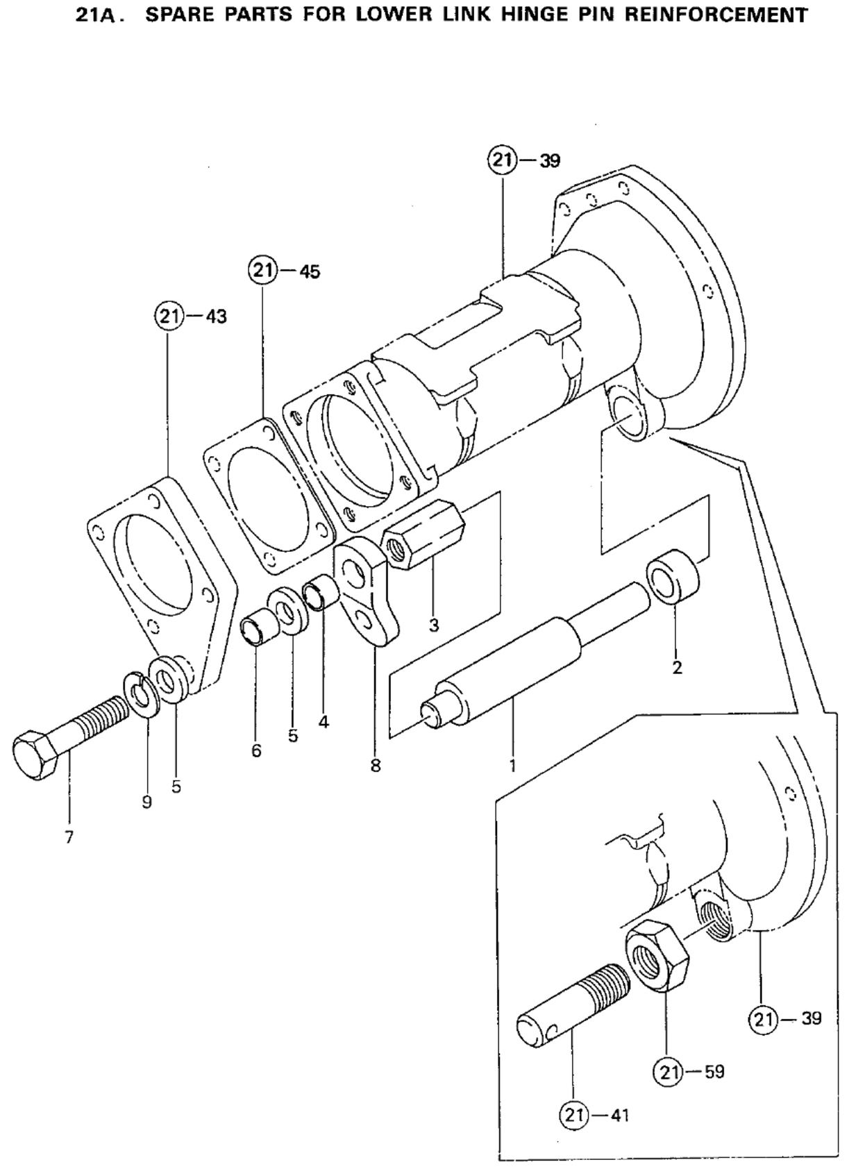

Here's the optional Long Pin Kit In the Yanmar Parts Manual: "Pin Kit, hinge. Part # 794240-73210".
I started this project asking Aaron if he had this kit. He replied they had been unobtainable for years.
Making a kit from scratch would start with a sway chain tab (#8 in the diagram) that could swivel, replacing the present tab with its horizontal pin welded in. I don't have machine-shop equipment so I abandoned making a kit.

I disagree. Originally a poor design. A pin supported on both ends makes for a much stronger design than a pin supported on one end alone. That is why they came out with an optional reinforcing kit supporting the pin at both ends.

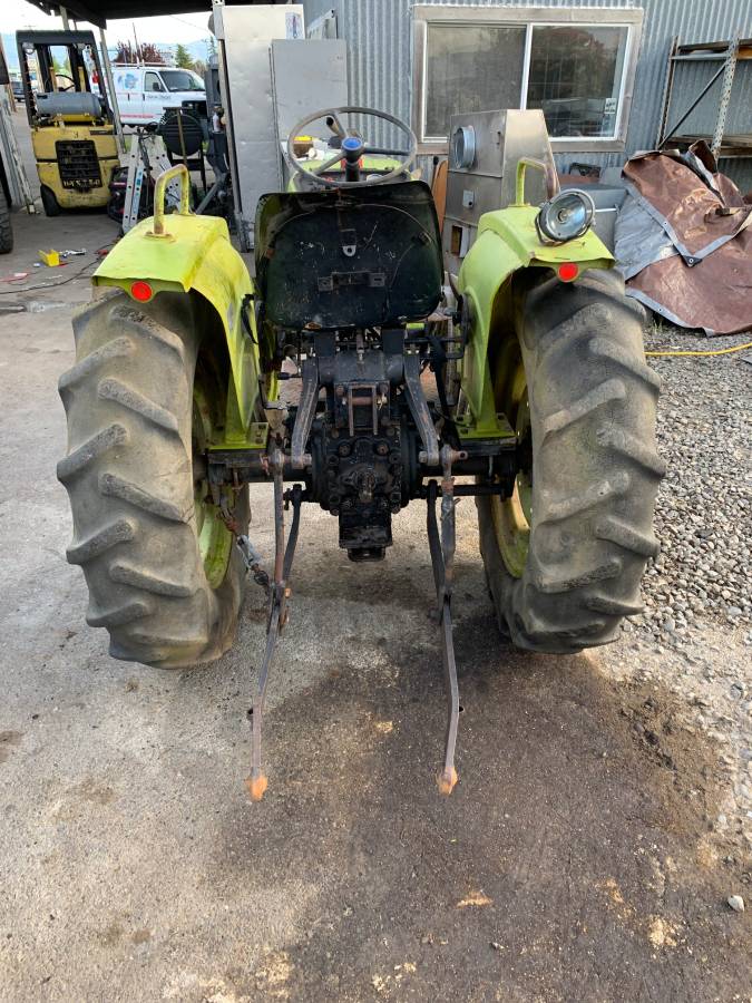

Here's a photo that I think shows the 3-point long replacement pin.
It's from a Craigslist ad in southern Oregon. (YM240 stored 5 years. Cranks, won't start, destroyed the starter trying. $1400). That's not a bad price for someone who wants a project to tinker on.
Yanmar YM240 24 hp diesel tractor - farm & garden - by owner - sale
   / Tore the 3-point pin out of the axle housing! $500 repair #19
Yea I'd like to buy that
   / Tore the 3-point pin out of the axle housing! $500 repair #20
Rusty oil filters are never a good sign. It's a sign it was " stored 5 years" outside!
