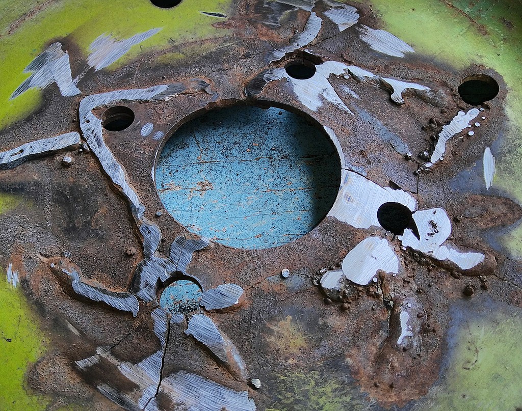

I cant understand why or imagine a tractor rim would be cracked and welded like in that picture, wow, what would be the cause of that..........No one works a tractor harder than me.

When I first had it, a couple of times I backed up fast, in a curve, on rough ground, and had the steering wheel torn out of my hands as the steering went all the way to the stops. This is the only way I've stressed the front wheels and it didn't expand the cracks that were already there.
A prior owner must have done this often with a lot of weight in the bucket. One of the front wheels has "$25.--" written on it, clearly a replacement, so his abuse must have been frequent.
I used one wheel as the foundation to make a grinder pedestal. .... :eek:

I know narrow front end tractors will almost rip your hand off when it hits something just right, always had to hold steering wheel with thumbs out, the wide FE tractors I drove didn't have that issue.
Least your using the rim for something, recycling at it's best. I like using stuff that's no good for anything, that rim fits the bill.
