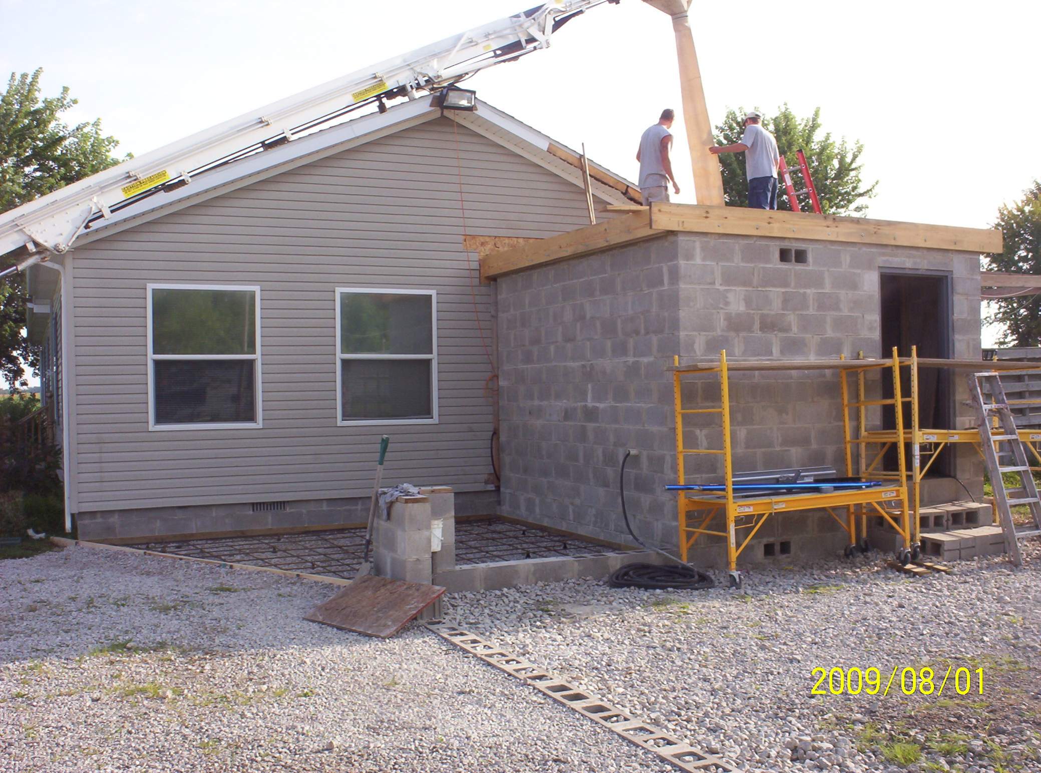

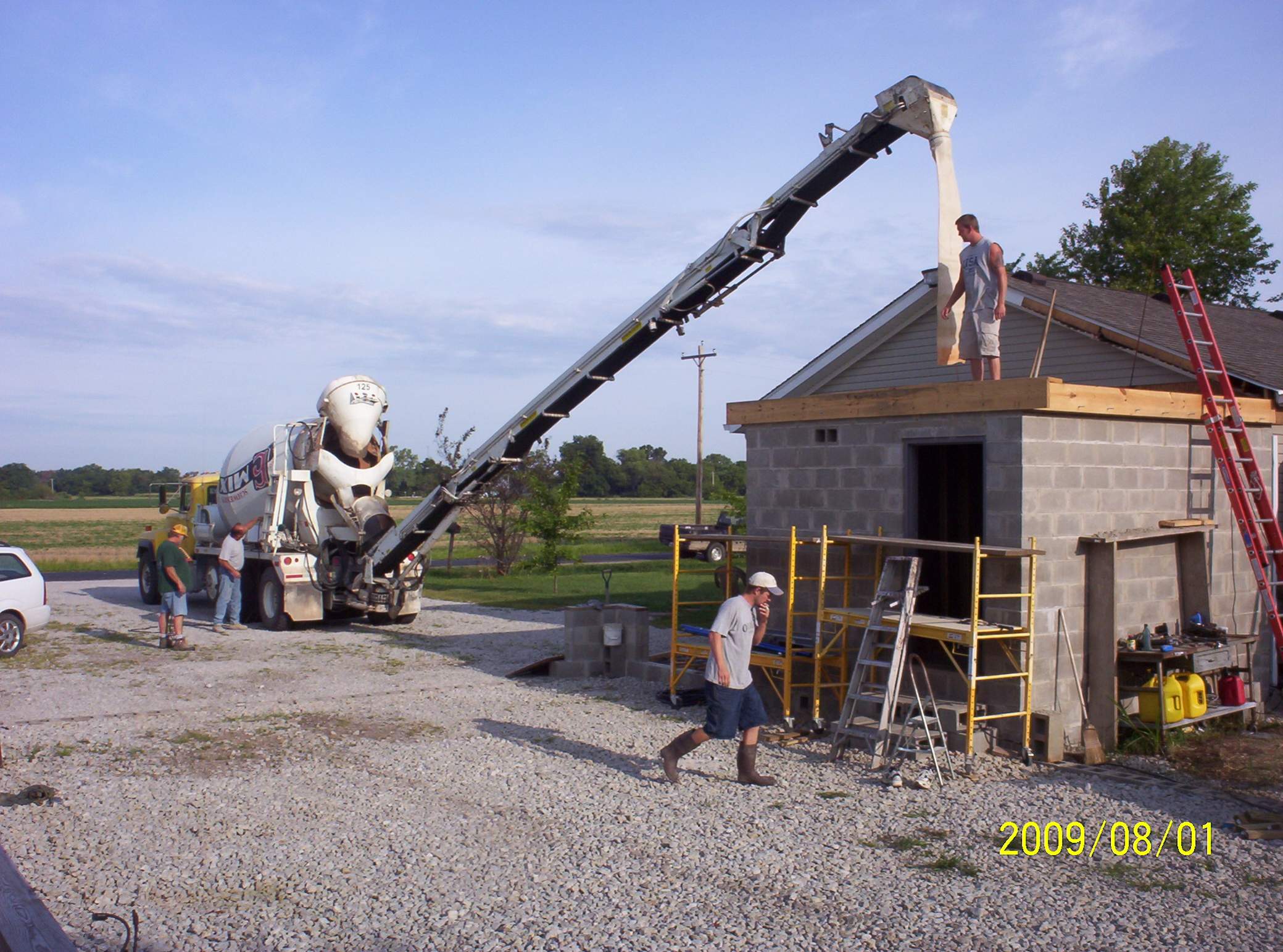

I built mine out of cement blocks filled with rebar and mortar and concrete roof. I went with above ground that was convenient to use. The breeze way approach is what I took. Some action photo's;
Dave
