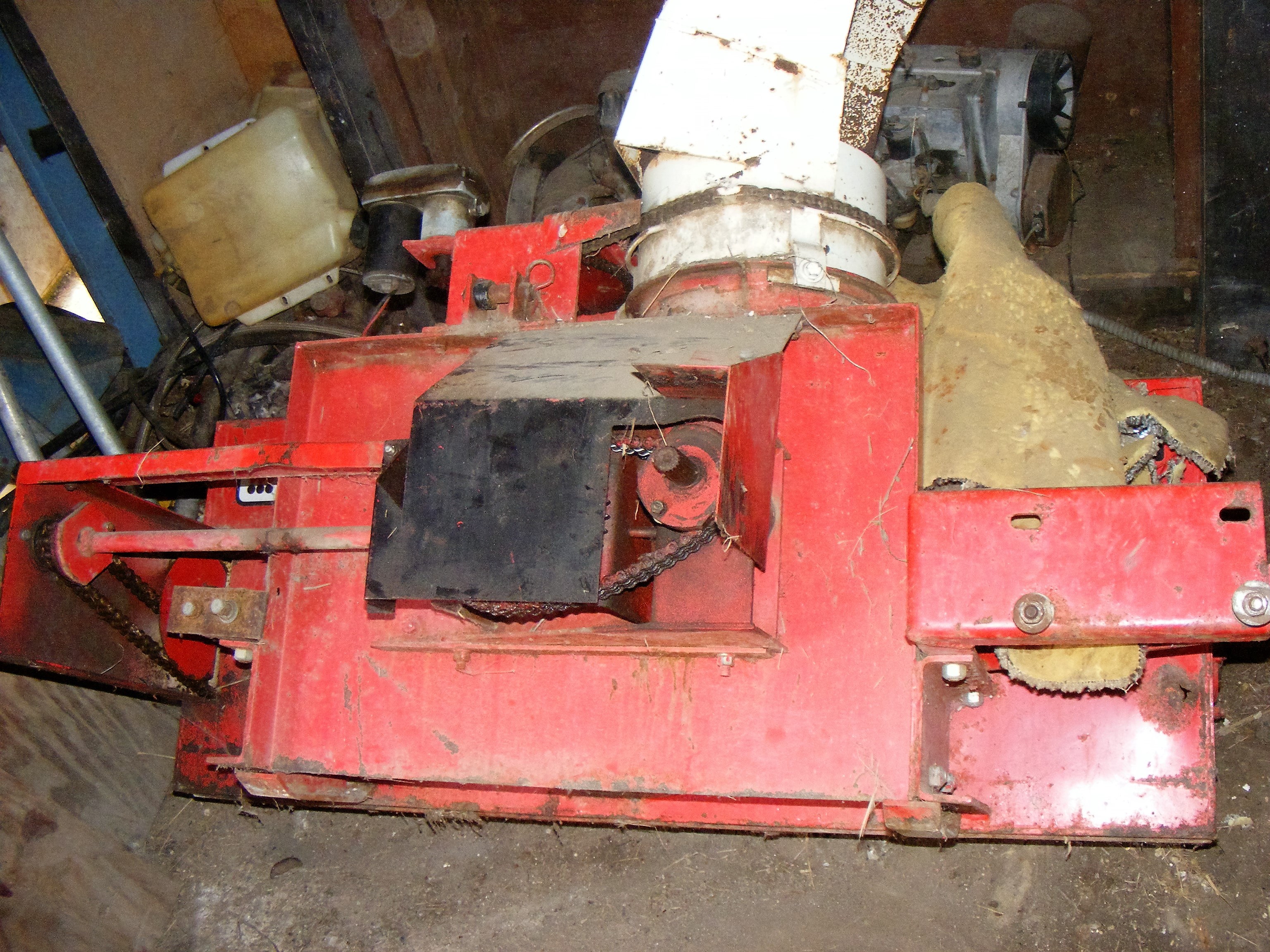

Now I am looking for pics of how the snowblower mounts. I do not believe mine to be mounted correctly - no chains are hooked up. It tilts heavily to the left side.

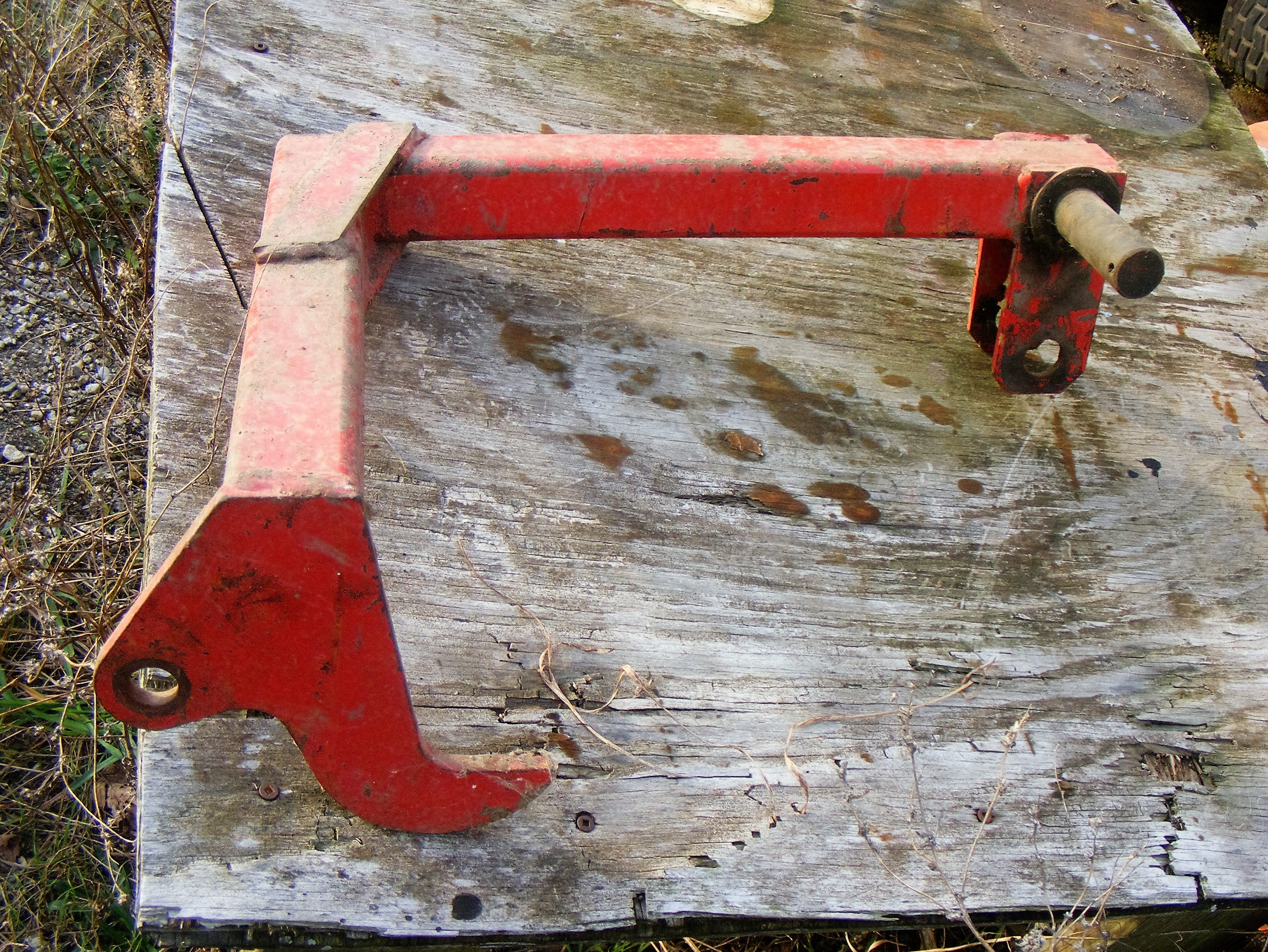

When I put mine on the front of my GM72 I have to unthread the ends on the arms of the tractor half a turn to change from side mount for deck to front mount for blower also it takes a different lift arm then the mower deck. Same drive shaft. I will look at what model I have , the blower came with the toro GM when new in 1979, I have all the manuals from Toro.

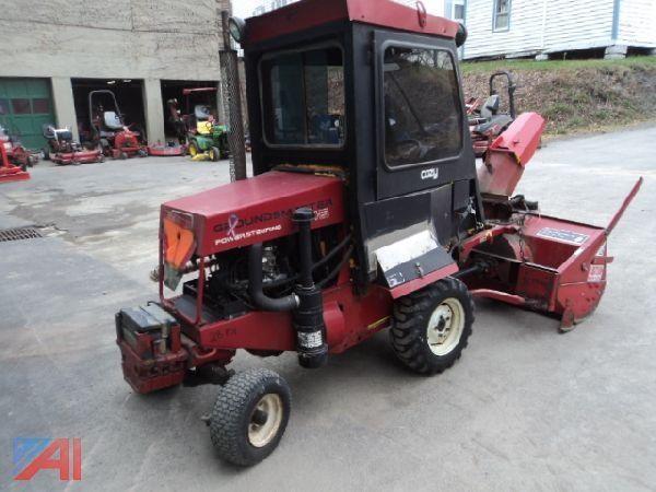

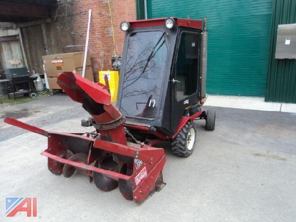

Chains would hook to the upper lift arm, the same as a mower deck.
Found more pictures, but hard to see chains.

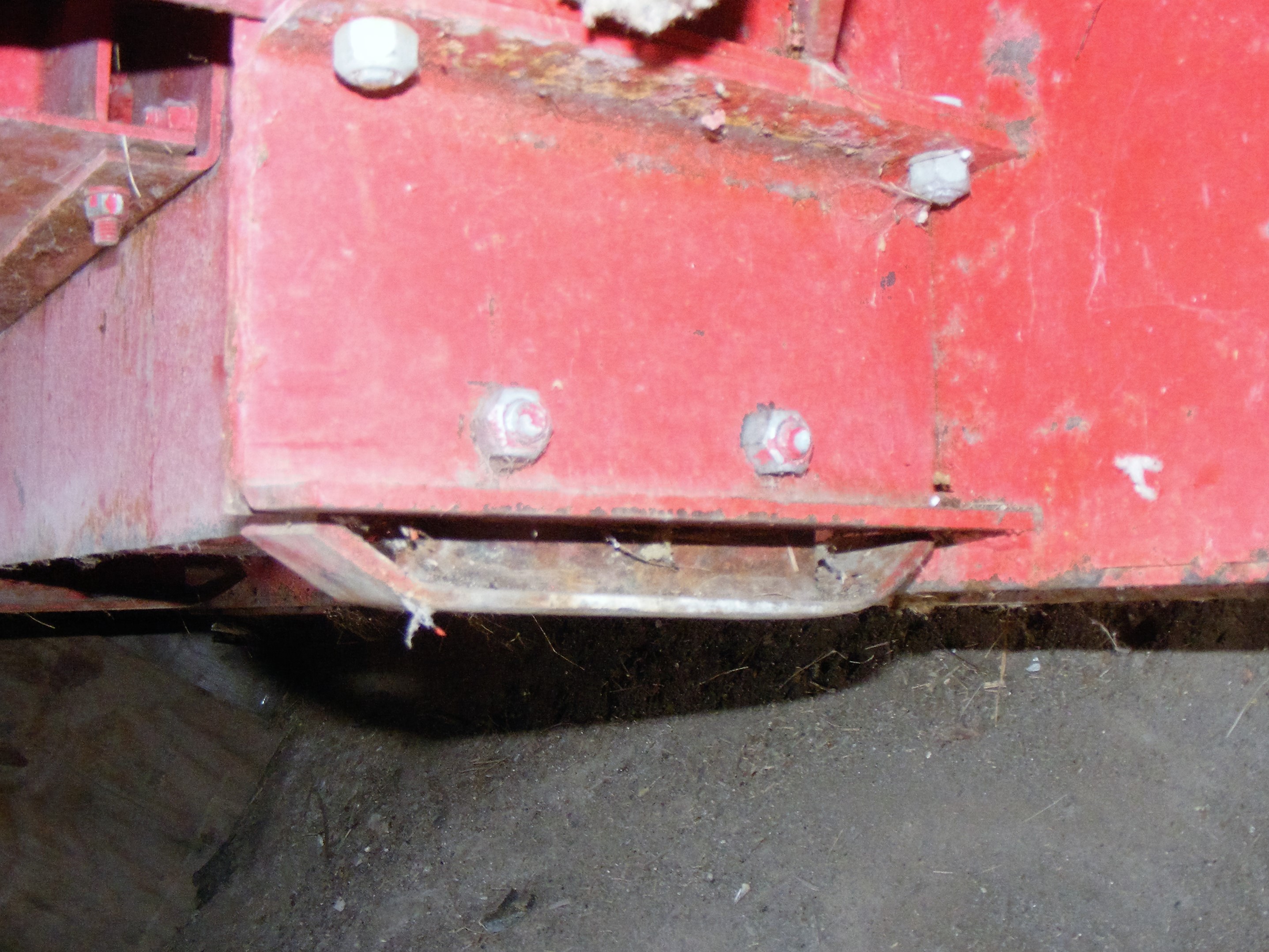

I think I have the mounting figured out now. There are a few things different about the way my blower is mounted.
Looks like there was some work done. It doesn't look bad, They just have the blower attached with a spacer - I would imagine to use the same driveshaft.
Hope I do not run into an issue when I go to install the deck.
I am going to have to add points to hook the chains to. Those are gone.

I went out to mine and tipped it up and took pictures of the skis and the lift arm that I change for the blower. Not quite how I remember it but pictures don't lies outside of photoshop .DSCF1135.JPGDSCF1136.JPGDSCF1139.JPGDSCF1140.JPG
