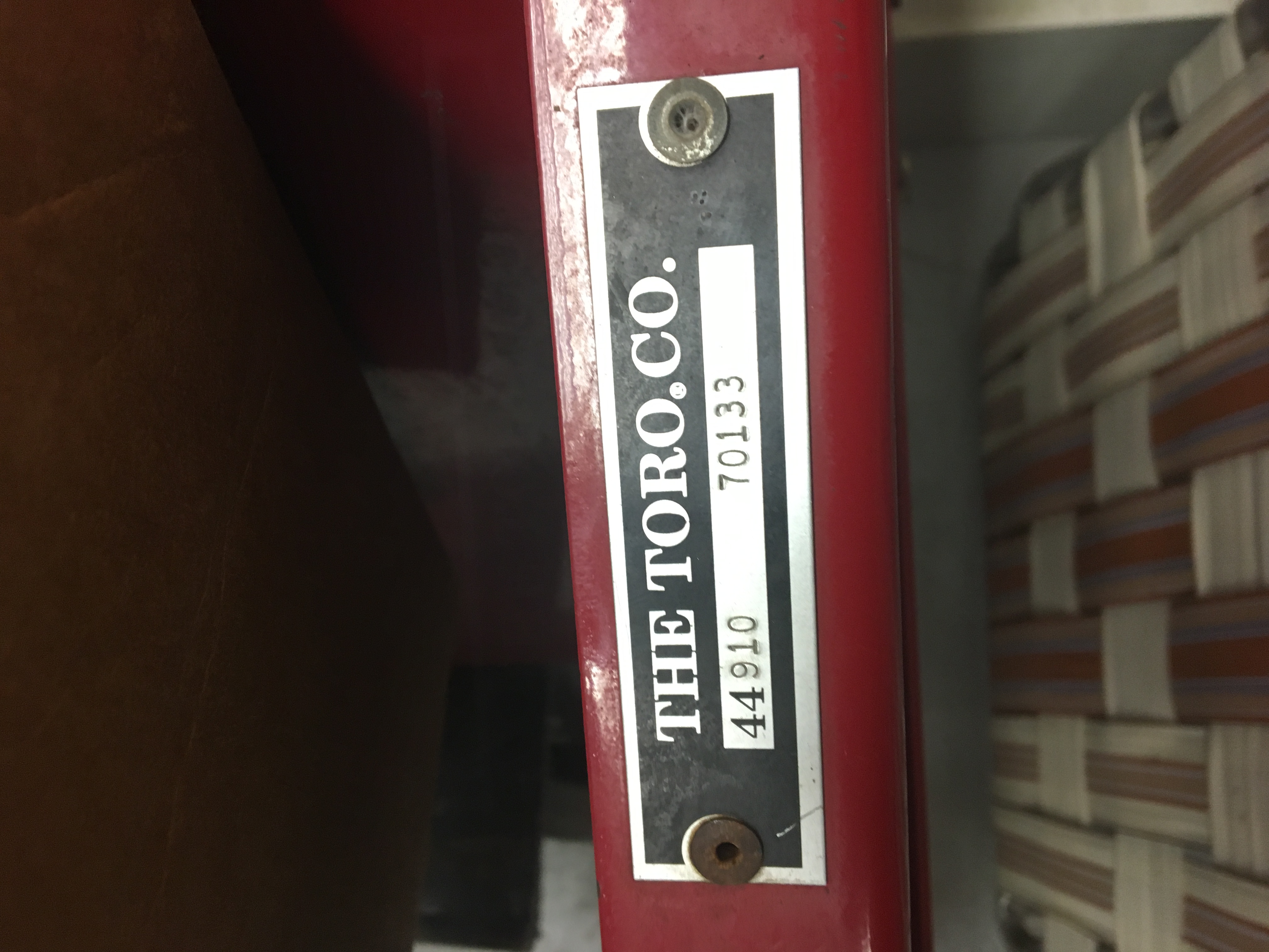

toro1.jpgfile.jpegif you still have Toro 325 d snowblower 150 info...
Acquired a 150 snowblower for my old 325 d. looking for info on name plate, manuf., model #, on the rear gear box /gear reduction unit ? and I think it reverses the direction from the pto shaft. Called Toro and distributors, the answer is not available & no info. I don't have the original part to look for name plate/manufacturer. original Toro part # 01-267-0390 Gear Box... rest of attachment is excellent condition, any info appreciated...Thanks

I am guessing your gear box is broken. Can you give a little more info on your issue?
Maybe pull the gear box off to look for a tag.
Check the gear box to see if it just reverses the direction of the shaft. Check to see if it changes RPM's.
Maybe try surpluscenter.com - They do not seem to be as good with advice as they used to be.
Try calling the service department for The Toro dealership that handles St. Louis. The guy there has helped me out a lot. Very knowledgeable.

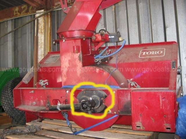

Thanks for replying, problem is I don't even have the gear box. was hoping someone with the same model could look and see if there's a tag on the gear box itself. Then I could look to that manufacturer for info. A company called Hub City makes something similar but I don't know what even to ask for...I called Toro direct but Toro part # 01-267-0390 Gear Box is no longer available and they didn't have any spec's on the gear box. Thanks

That appears to be an issue with some of Toro's attachments. They were contracted out and not all made the same or even all by the same company per year.
If you could figure out the final drive RPM needed - I would think the same as any other snowblower - You could figure things out working backwards. I am guessing there is a chain drive sprocket that attaches to the hidden side of the gear box?
You should also be able to determine if it is a reversing gear box. If it is just a 1:1 reversing gear box Look up something with a 30 to 50 hp rating = or with the proper input shaft size - if you have the drive shaft.
I'm not sure who to check for on gear boxes. Maybe Motion Industries.
If you can find the right guy and show him a picture, You might get hooked up.
It would be good to know id it's a 1:1 ratio - By size - It kind of looks like it would be
Maybe check Curtis manufacturing. Sometimes they can search by the Toro part number.
