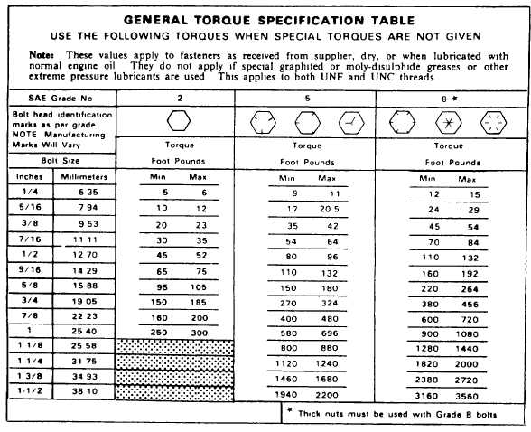

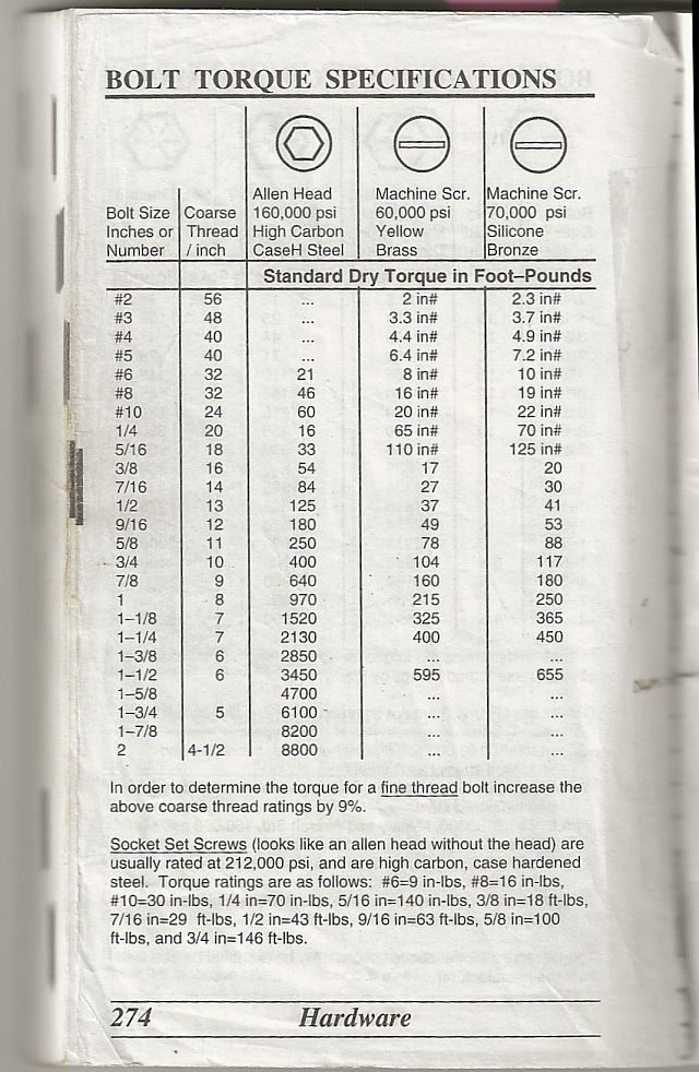

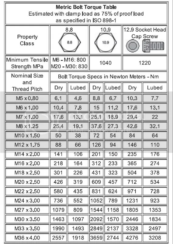

I have a gear pump (with aluminum body and cast alluminum end flanges). I need to reassemble and was wondering what torque value to use for the 4 assembly bolts?
Thanks for any ideas!
   / Torque Values for Gear Pump Reassembly #2
PTO? Hydraulic? Primary or secondary pump? Need some more info.
ETA there are generic torque value charts as well you can use when all else fails.
