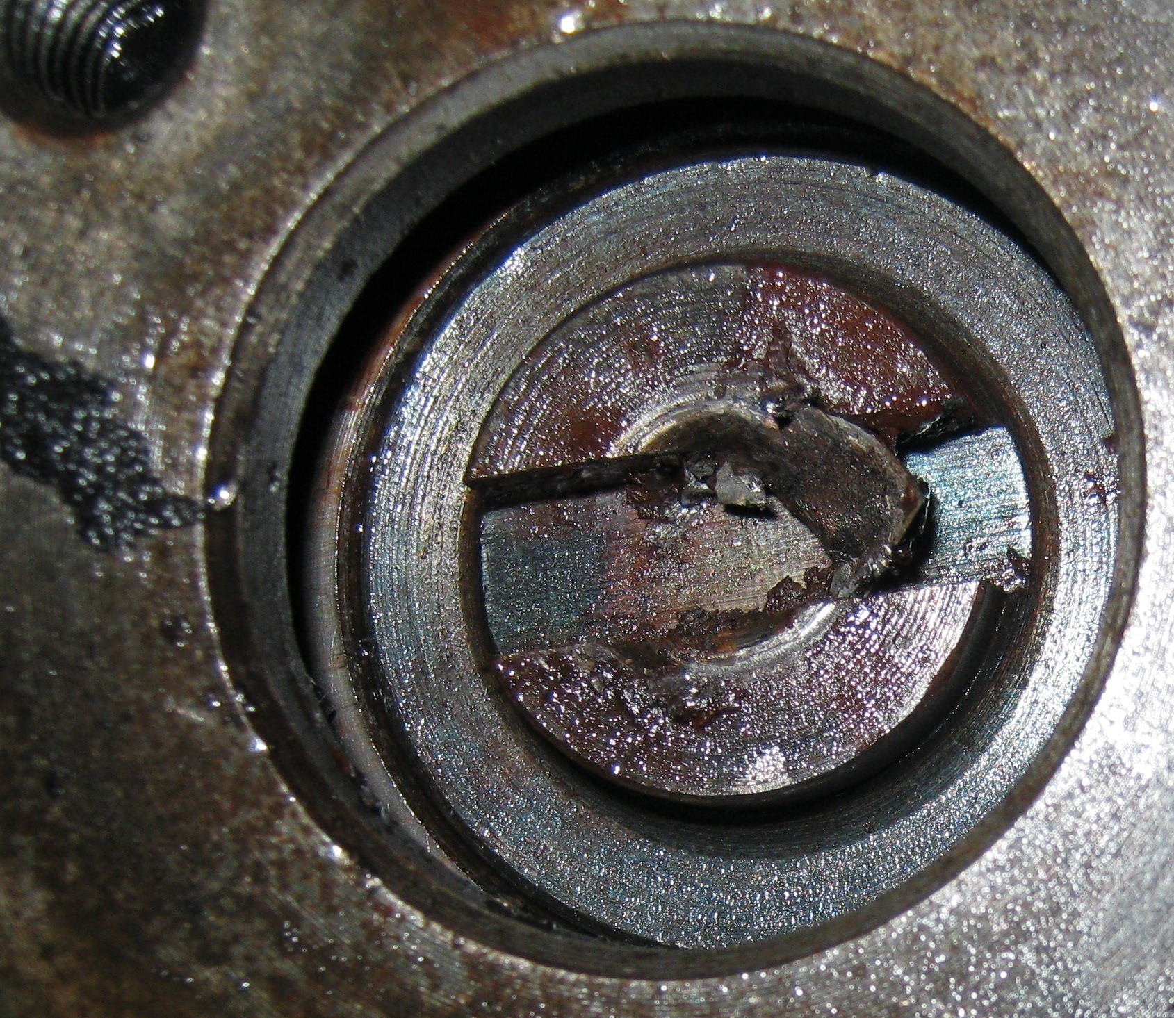

OK, I'm somewhat at a loss. Either I don't have the terminology or there is no quick connect. on these hoses other than what connect below the joystick for the FEL. I unscrewed the fitting just to the right of 26 in the picture.
http://johnstractor.homestead.com/files/HydSteering.jpg
I put the hose down toward a bucket and turned the engine over. I never got fluid to come out and stopped. I am getting the impression from several comments that I could damage the gear pump (if I haven't already) if I ran it too long dry. I tried 2 times about 10 seconds each.
I then removed the gear pump. After lots of cleaning, I too it apart and see nothing wrong except the end of it that connects to the engine appears pretty marked up. I'm referring to the lowest part of the bottom picture here.
HydPumpDisassembled
That "end" is the pump drive tang, and it's damaged beyond repair. The pump has been fatally dead-headed. The drive tang fits into a slot in the drive gear. The engine is turning the gear, but the gear is just spinning around the pump tang. Pump's not pumping. Take a look at the slot in the drive gear too, it should have perfectly square corners. If it's rounded (or rounding) out, it should be replaced as well.
//greg//

OK, thanks for the help. I was afraid that was the case. How tough is it going to be to get the drive gear appart if that is also damaged? I'll take pictures tonight. Also, any underlying cause of this that I should be examining closer?

I've been lucky with 4 Chinese tractors never to have fatally deadheaded a pump. So I can't relate any personal experience replacing the driving gear. But that's a bridge you don't even know if you have to cross yet.
Underlying cause is always the same, impeded fluid flow. The engine continues to turn the pump, but - since fluid has nowhere to go - the pressure builds to a fatal level. Either the tang gives up the ghost, or the seals blow - sometimes both. In the Jinma 200 series, the most common reason is inadvertent separation of the QD at the pigtail that comes off the pump. It's strongly recommended to either replace the QD with something more reliable, or to strap the two halves together with a pair of heavy duty zip ties.

Here's the picture of mine. I'll give you a call tomorrow to order the parts. How difficult will this be for me to install? Is it just unbolting the 5 bolts in the picture?
I'm still not sure how this happened. I've never had a hose get disconnected that I'm aware of. Anything else I should be checking on this tractor?
