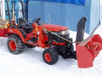

Hey Guys,
Can anyone tell me what the total length of a bx2230 with a front mount snow blower attached? I have a trailer that is 8'2" in length. My dealer told me they will not deliver a snow blower attachment for free even though I spent 13 grand on my tractor and accessories(go figure), so I figured I would want to take my tractor out there and have them mount it on the first time so I get how it hooks up. I am afraid my trailer is not quite long enough.

I have a BX2200 with the front snowblower. I just measuerd both and would tell you that they will almost perfectly match your trailer length. (From the back of the rear tire to front of the blower)
When I bought mine, it was mowing season and the snowblowers were not in stock yet, so I picked it up separately and mounted it myself. There is a manual for both the quick hitch and blower. I had no problems at all (other than Kubota providing incorrect hydraulic hookup information!!!)

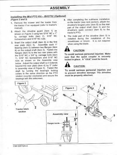

   / total length of bx2230 with snowblower attachment #4
They shouldn't need to cut the shaft. The shaft runs into gearing on the quick hitch which then runs to a shorter shaft connected to the blower so it can raise.
I can probably snake it out and take a pic to post if you want to see how it works/ what it looks like.

   / total length of bx2230 with snowblower attachment #7
here is a pic of the driveshaft mounting diagram- maybe it will make more sense. Both the rear and front sriveshaft move in and out of the couplers as needed.
