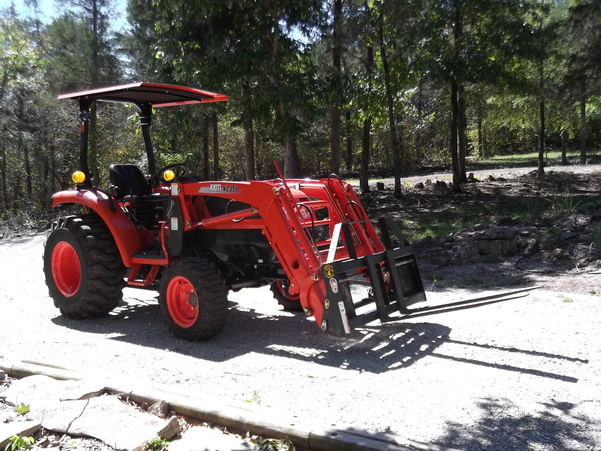

While we are discussing Pallet forks. or Grapples, or other tools that might go on the front end of a tractor.. (oh boy here comes more spending of YOUR money) we need to talk about SSQA (Skid Steer Quick Attach) This front tool attachment system allows you to quickly in a few seconds go from a bucket to a set of pallet forks to a grapple, or to anything else you can build/buy/think up. This system was first developed for Skid Steer machines, but many tractors now have it as a standard. Usually starting in the 30 horsepower range of tractors. I have it on my 35 horsepower tractor and would not be without it. But thats just me:)
I actually have 4 front attachments 2 buckets, pallet forks, and a grapple. All take mere seconds to attach.. With the Grapple taking a few seconds more to hook up the hydraulic hoses to actuate the lid. Many others have things like snow plow blades or front boom poles
