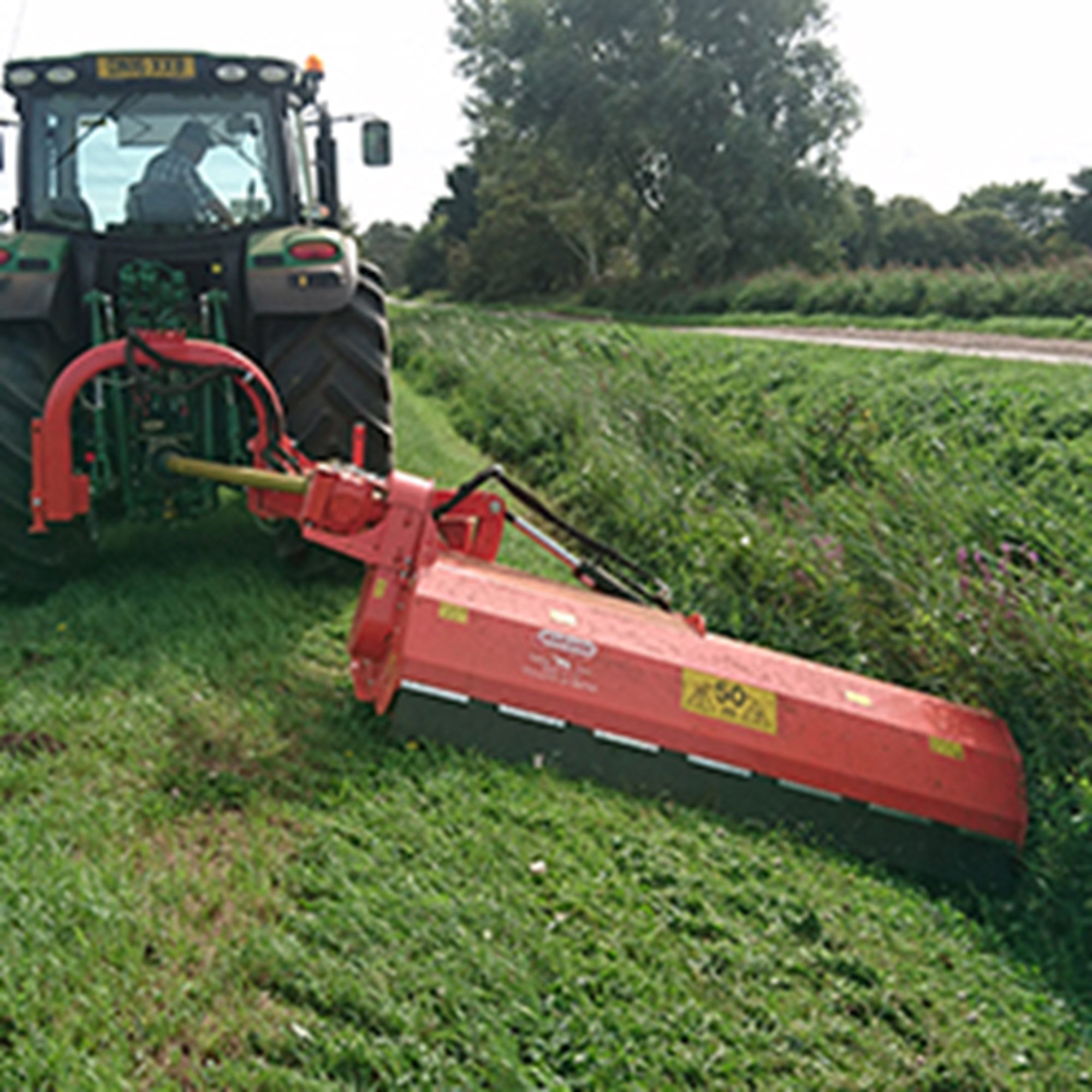

Not sure how long the slopes are you need to cut, but have you considered an offset mower? lets you reach down a bank without getting to close.
   / Total noob. Mowing with Toolcat on a hill vs Ventrac vs Kubota L3902
#36
That won't fit my application. I have long runs of 100 ft plus hill section. But Thanks for the suggestion
