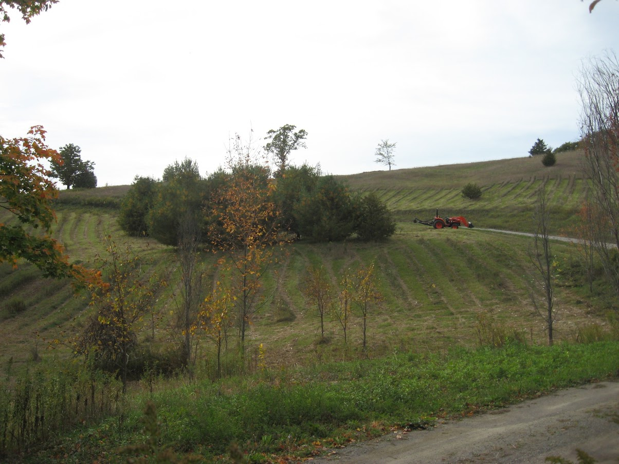

If you can mow it straight up and down a normal 4wd tractor with Ag tires will scare you long before it will go over backwards, IMO. On the slope in front of the pines I was watching to see if the oil pressure light for the engine was going to go on, and I was happy I left the bucket on the loader. I kept the backend downhill the whole time on the steeper parts as any tractor with a pivoting front axle is really a tricycle. I mowed this in the late fall for the next years tree planting, which is why I left the strips.
Parts of this slope would be getting close to 30 degrees. The brush cutter is only a 5' at about 500lbs and my tractor with loader and bucket is near 5500lbs so it didn't matter much if it was lifted or riding the wheel on the ground.
If for some reason I had to mow something like this often I'd probably get a 7' wide side discharge finish mower and let it ride on the ground, but still keep the tractor backend downhill, also an HST is nice for this kind of terrain. The advantage of going straight up and down is holes or bumps don't really matter much at all and this slope had lots of groundhog activity from years ago...

"If you can mow it straight up and down a normal 4wd tractor with Ag tires will scare you long before it will go over backwards, IMO. On the slope in front of the pines I was watching to see if the oil pressure light for the engine was going to go on, and I was happy I left the bucket on the loader. I kept the backend downhill the whole time on the steeper parts as any tractor with a pivoting front axle is really a tricycle. I mowed this in the late fall for the next years tree planting, which is why I left the strips.
If for some reason I had to mow something like this often I'd probably get a 7' wide side discharge finish mower and let it ride on the ground, but still keep the tractor backend downhill, also an HST is nice for this kind of terrain. The advantage of going straight up and down is holes or bumps don't really matter much at all and this slope had lots of groundhog activity from years ago..."
Lots of good info here, thanks! I absolutely CAN mow up and downhill for most of what I will be mowing.
