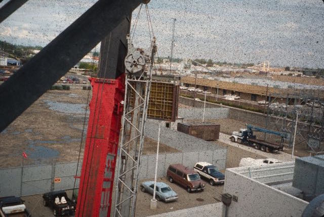

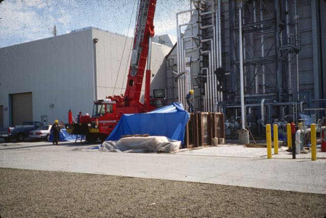

That's this program on my phone that changes words I wrote SCR'S and it changed it to a word with a s
   / Totally OT: Power Plant tour #89
I had to look that up. Now I know what you're talking about.
Here's some we took out, added more titanium catalyst and then re-installed more than twenty years ago.
I don't really know what the issue was, but the factory told us they weighed 3,000 pounds. When we first came up on them with the crane, with just a lattice boom jib rigged single part, the LMI said they were going at about 8K. Although we were far inside the chart and load line, the rope stretch was kind of scary. Switched out the jib for the manual extend main boom, and went two part, and everything was hunky dory.
