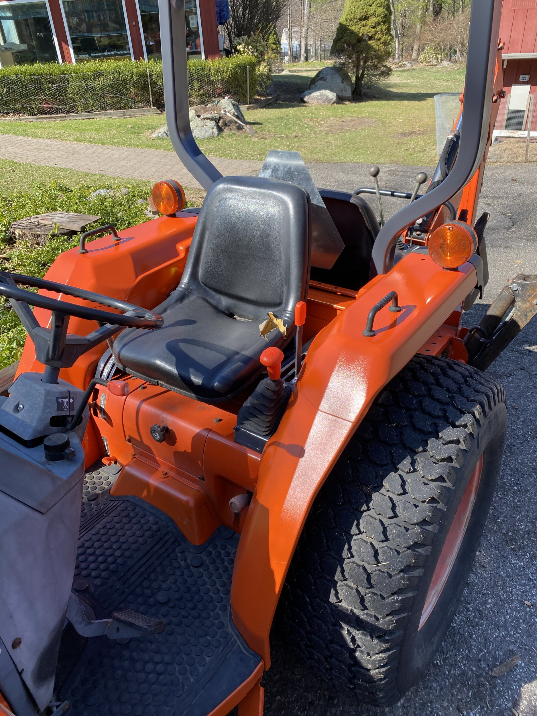

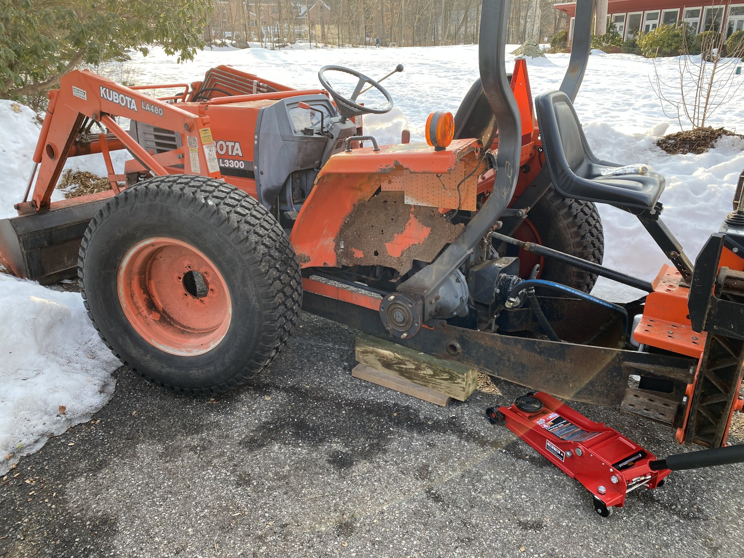

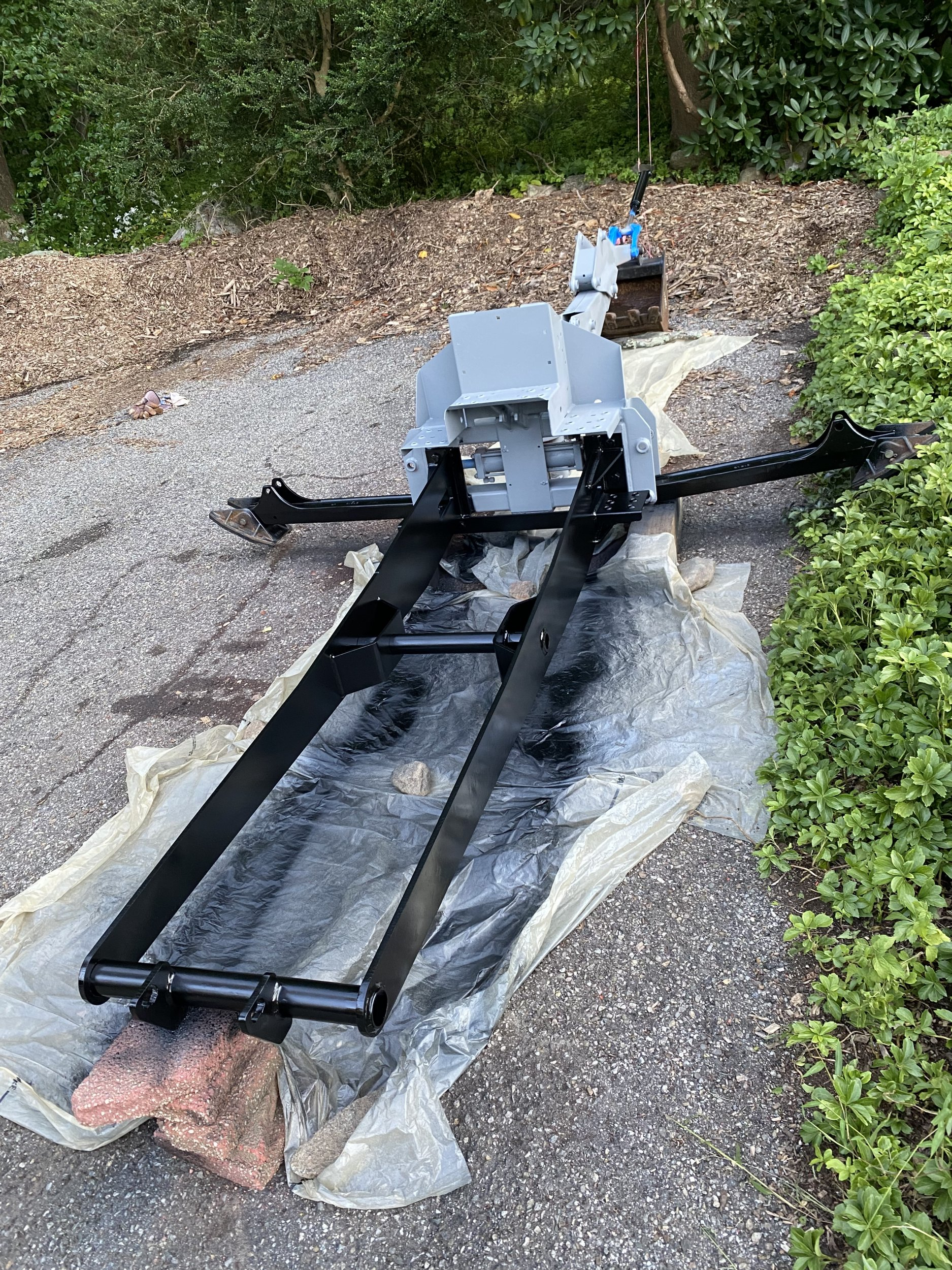

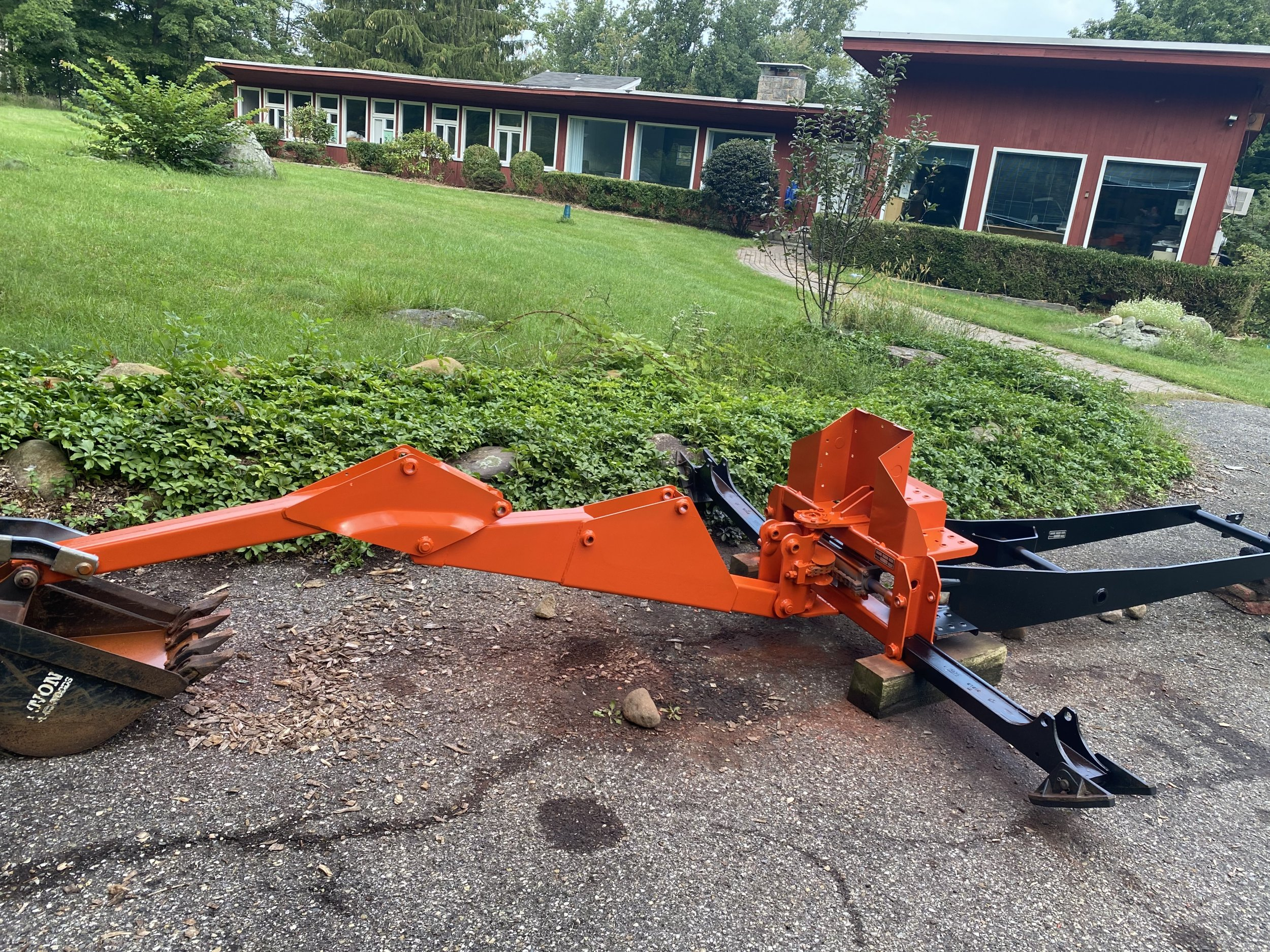

Old post but I owe an update to everyone who contributed. New fenders and all other small parts around them including ROPS were painted. Floor and backhoe also painted.
baby steps but the 30 years old baby is starting to look young again.
