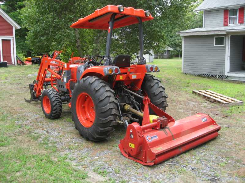

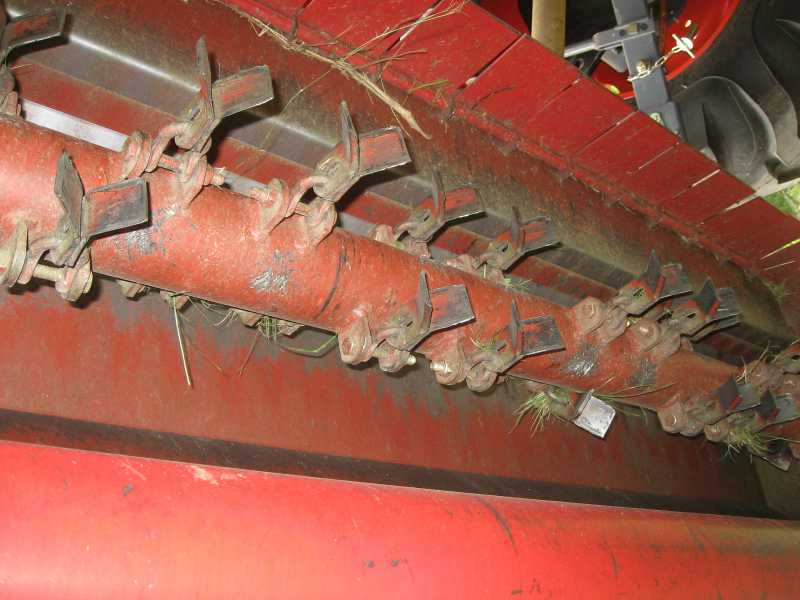

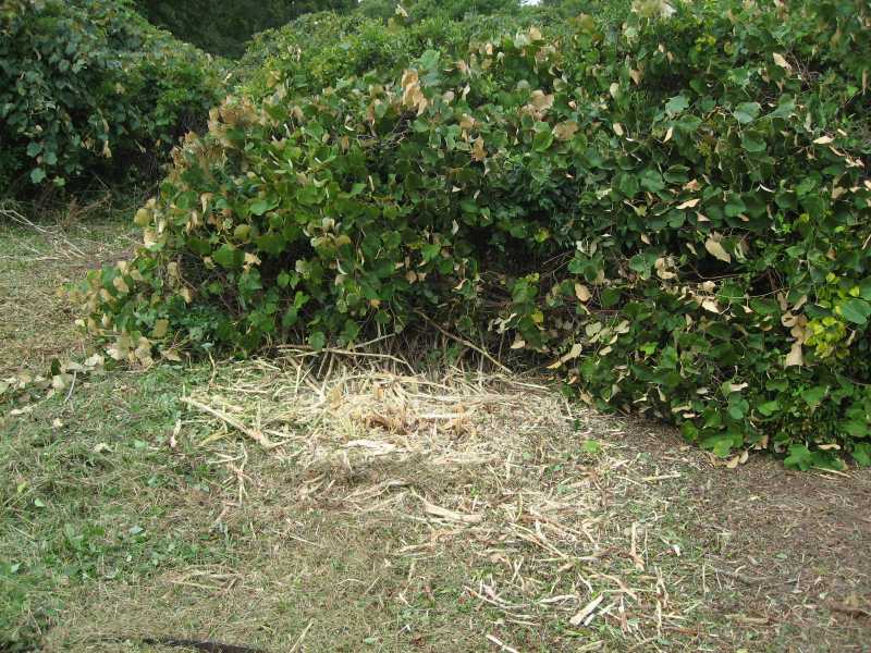

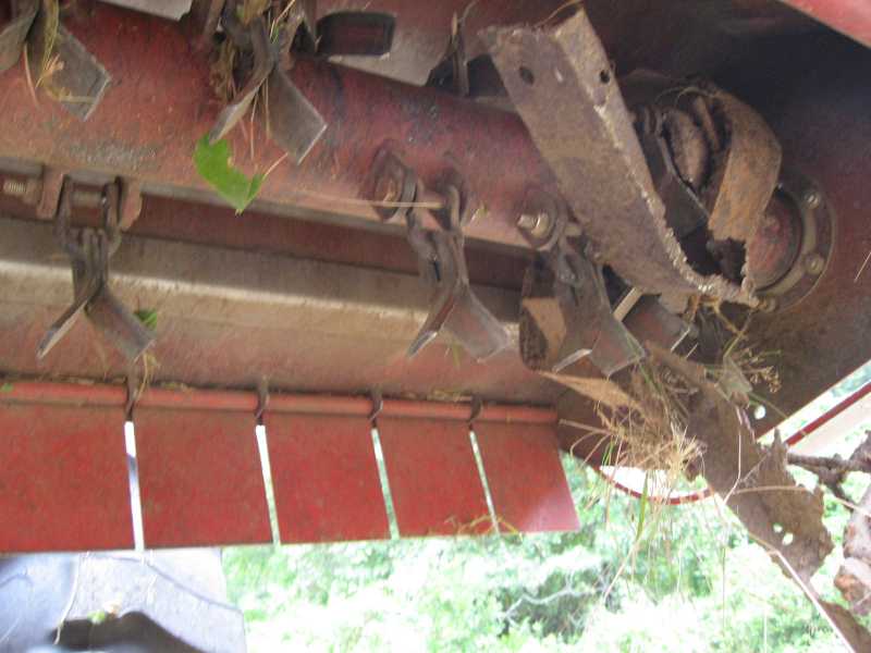

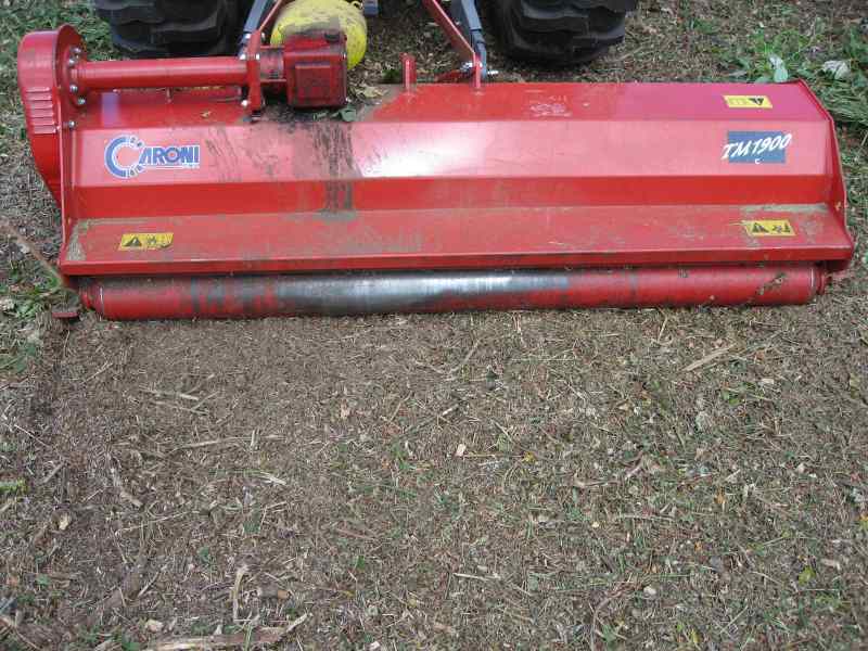

I couldn't get photos to upload yesterday so will try again to post the Caroni TM1900 photos.

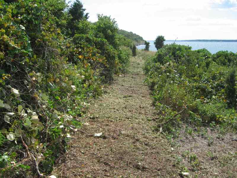

I completely agree with superduper's analysis. I think I stated that I consider the Caroni a "medium duty" flail which is akin to a medium duty bush hog (i.e. very good quality) but not a "heavy duty" machine. No doubt it is designed to handle material less than 3 inches even if it can handle the occasional bigger stuff. I have backed the Caroni into eight foot multistemmed bushes and left behind nothing but mulch but I don't do that every day.
I don't want to oversell the Caroni. It would not last long if used by a highway department running over cinder blocks every day but it certainly seems as tough as a good quality medium duty bush hog and cuts much finer. In the long run it will require more maintenance than a bush hog because of the many knives that require flipping and then replacing so that is the price you pay for the finer mulching cut compared to a bush hog. I've mowed through a few acres of pretty substantial brush and while I can see dings on the knives it will be quite a while before I actually need to flip them over. I don't know if the Caroni would serve as needed in a coffee plantation but it is a good enough value that one could probably buy three or four of the TM1900's for the price of one super heavy duty flail.

The underside of your caroni looks very much like my Gearmore GML49. I was loosing one or two cutters each outing. Some of the time they were cracking off where they attach to the main drum.

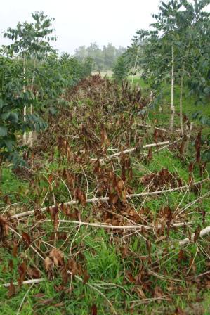

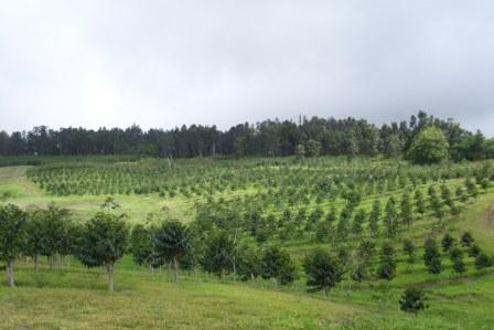

Here's a shot of the prunings waiting to be shredded or trimmed by hand (much more labor expensive).
The second shot is part of the coffee farm after pruning and clean-up.
Enjoy.

Nice spot. Lucky you live Hawaii eh? I used to live in Hawaii so I've visited that area south of Kailua quite a bit. You must be close to Captain Cook.
I'm not a farmer and don't claim to appreciate the practical issues in a commercial operation but if I had piles of clipping like those I would use my grapple to cart them off to a mulch or burn pile then run the Caroni over what was left on the ground.
   / Toughest Flail Mower: Gearmore?
#17
Good eye. Exactly right; just mauka of Captain Cook. From where I took the second shot, Kealakekua Bay was at my back. The orchard is at 2200' elevation. I'm trying to minimize labor requirements on the 50 acre farm. Not only is labor is expensive here, but it's hard to find good help. Even multiple passes with a shredder are cheaper than hand work, chipping, or grapple runs.
