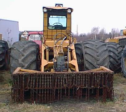

They use one on the army base to cut roads. Its a Hydro Ax.
