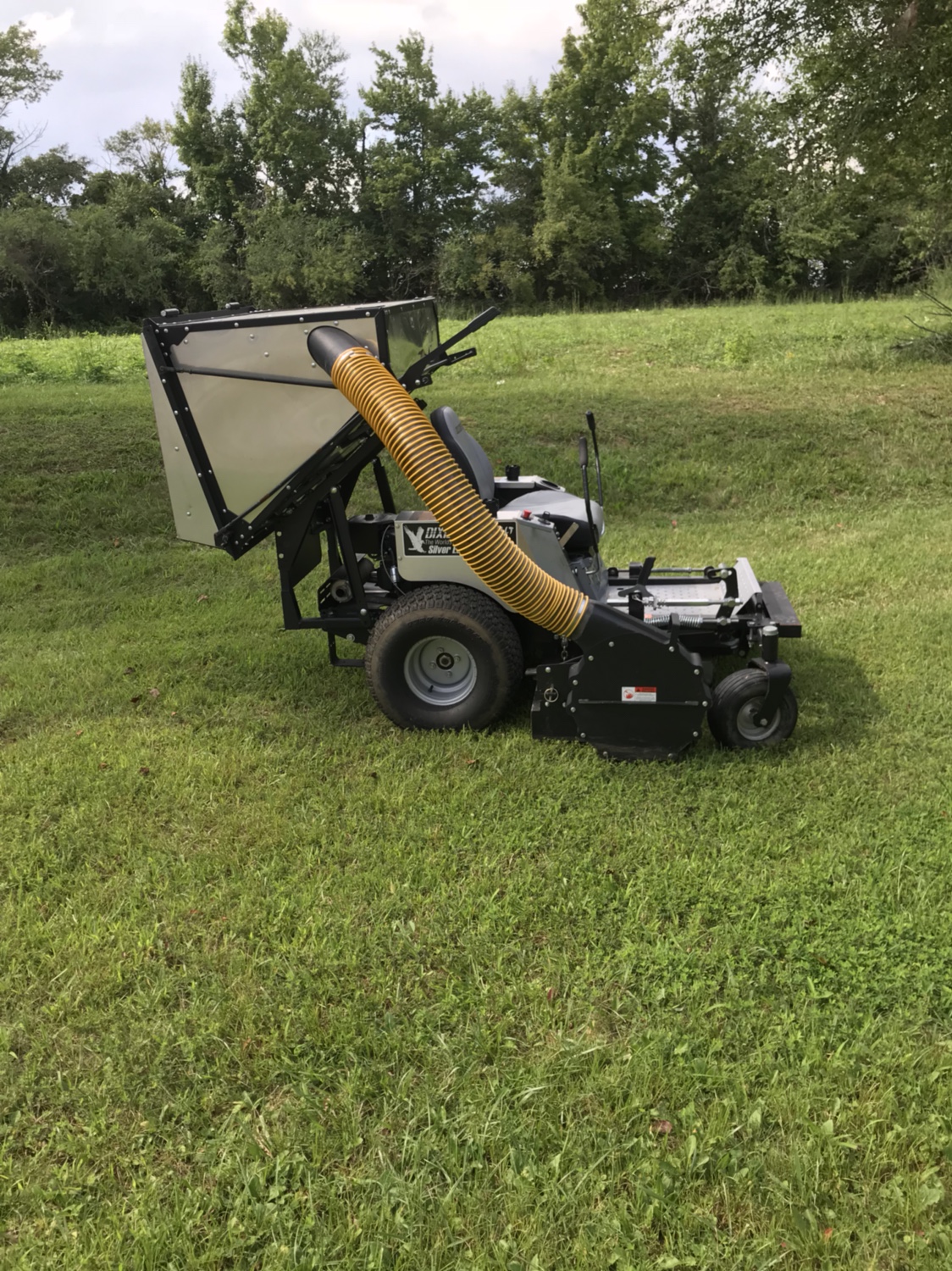

I can’t imagine either works well for a ZTR. I haven’t had a chance to use it yet, but I recently bought this unit. I think it’ll work much better then my old cyclone. I hated that thing. IMG_0095.JPG

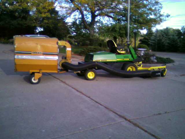

I've used both castor type vacs and a trailer unit. I prefer the trailer unit because when the catch box is full of leaves, nuts and twigs, its very heavy. This adds a LOT of rotating inertia to the combined unit and that takes a lot of steering force to maneuver. This means large loads on a front steered lawn tractor (because of the inertia, and likely a lot of torn up grass from the Z-turn method of steering. The only advantage I found was the length of hose from the deck to the vac is a fixed constant.
For the trailer unit, I like a long hitch on the mower so I can make very sharp turns. Yes, the hose length changes as you turn left and right. My trailer vac also holds quite a bit more content than the canvas bag units. Since it has a separate motor, I have all the power it takes to suck, shred and blast the clippings, leaves and nuts that I want removed from my lawn. I have a 72" deck on my F-935 and it takes a 10" hose to handle the volume per second that the mower can produce.
