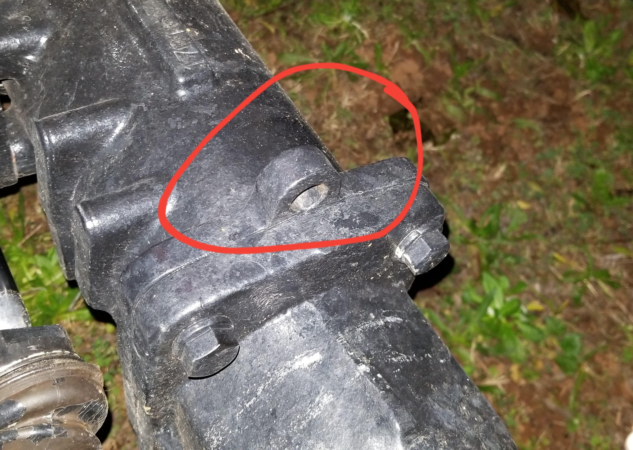

Has anyone added clevis hitches to the front axle to help with attaching tow chains instead of wrapping them around the axle and scratching the paint to pieces? I bought a 1/2" (too big) and 3/8" (too small). I'm thinking about ordering some 7/16" for the front axle. They are rated 3000lbs each. If I'm using 2 of them, would that be ok just to secure the front of the tractor? I would be using 4 anchor points total.

I don't think that small hole on the axle would have enough strength for use as a tie down point. Putting a clevis in there then tightening a chain through it on a 45* angle would probably snap those cast holes right off.

I wouldn't do this,your asking for big trouble. With that setup there's a very good chance of breaking the axle housing.

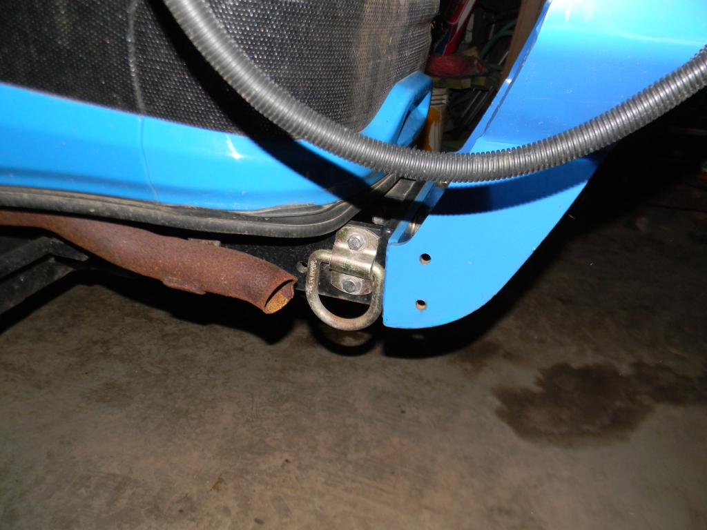

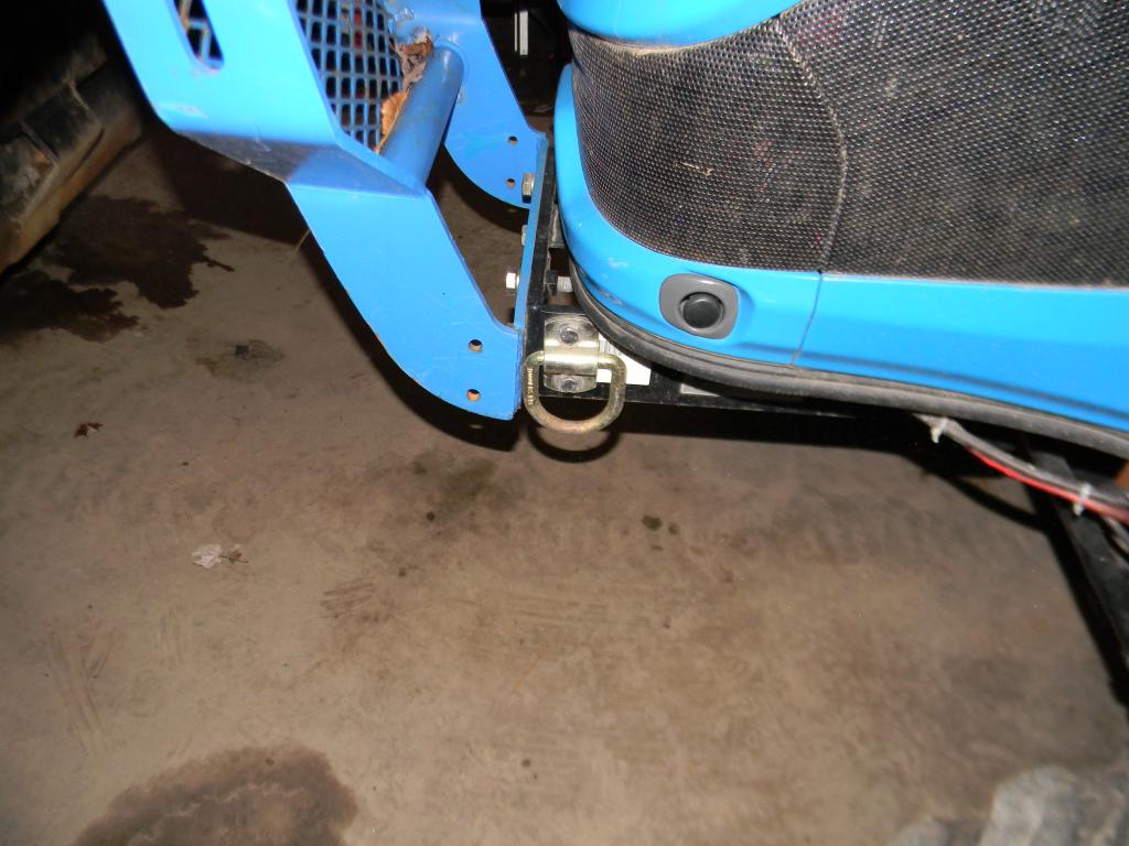

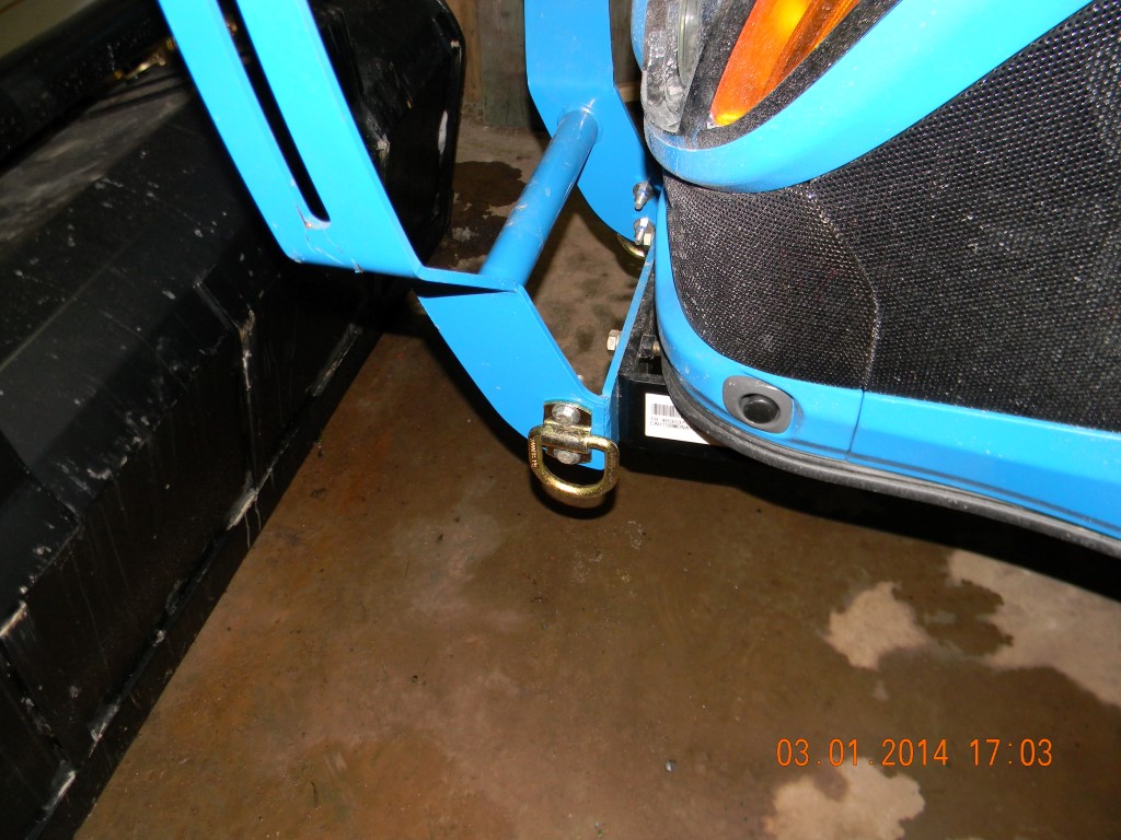

The d-rings on the front frame.
/ Tow chain anchor points #8
I originally had them bolted to the brush guard but after seeing a few bent and broken guards I moved them to the frame. Each ring is rated for 5K lbs. Bolts and nuts are metric equivalent of grade 8.

I think those are lift points for the axle assembly in the factory or replacing, not tie down points.
