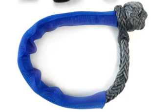

Soft shackles are all I use, I do have steel ones also but hardly use them.
I do have a HD jerkstrap but also mainly use a kinetic rope. Seems to be easier on the vehicles vs the sudden jerk.
I also have a hitch that is basically a shackle you put in the receiver. Good anchor point and if it rips your receiver off, your very stuck
Even self recovery is easy if you have a good anchor point
