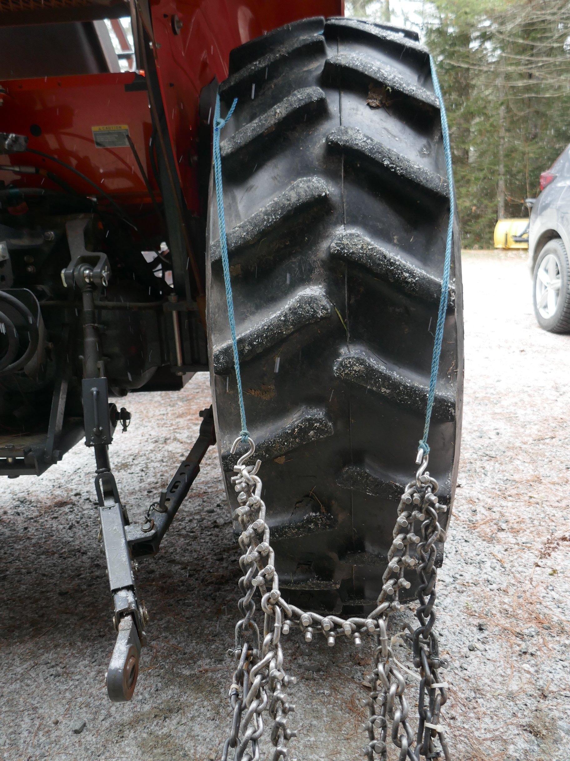

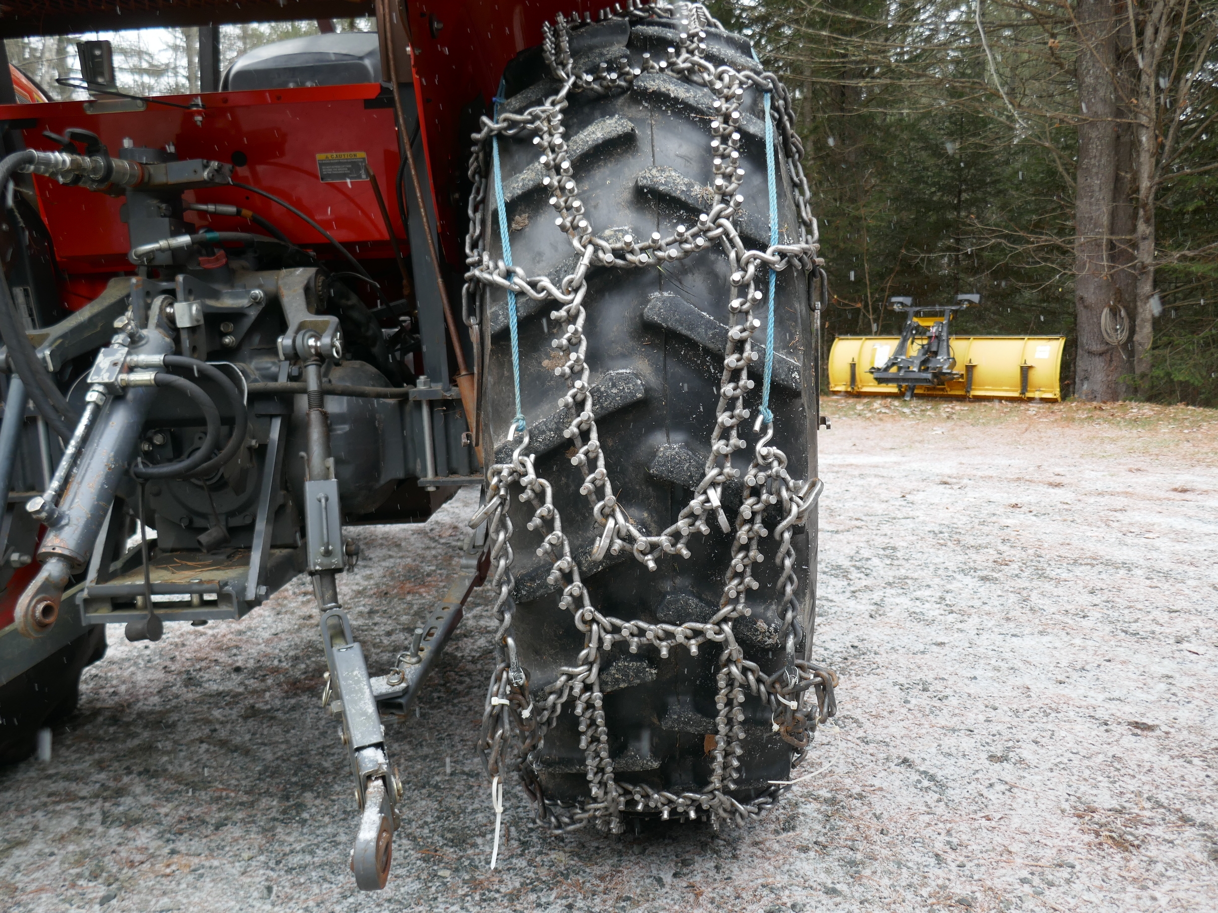

Well I got my rears on the Branson today;
I do both tires at the same time, step 1 getting the ropes on, step 2 getting them started around
step 3 most of the way around and thennnnnnnnnnnnnnn step 4 all fastened on and done.
I've started putting mine on were the driveway has a bit of slope, once I've got them both hooked up on the tires I can release the parking brake and just let her roll ahead a bit, stopping every 3 feet or so to make sure they haven't tangles and to spread them out and keep them centered. Doing both at the same time just seems to work better for me on the rolling slope.
