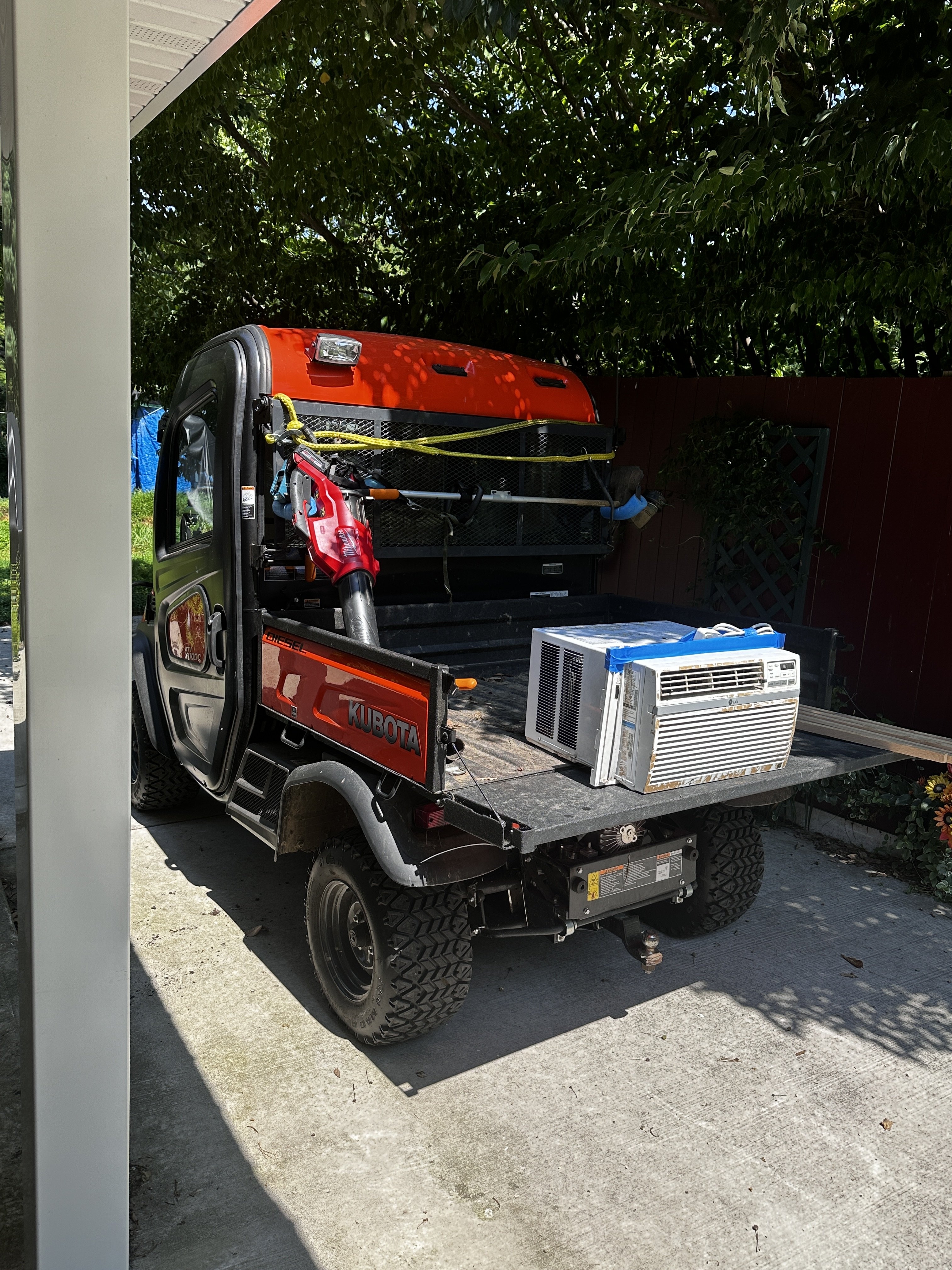

I keep a light duty tow rope curled up high on the RTV usually for pulling out the ZT when it gets stuck in mud as shown in the picture below. Sometimes the RTV gets stuck also that is where I get the tractor or excavator and use a chain or much bigger tow strap. Chains should not be used to jerk or on much bigger vehicles stuck really hard.
I've got that same AC unit!

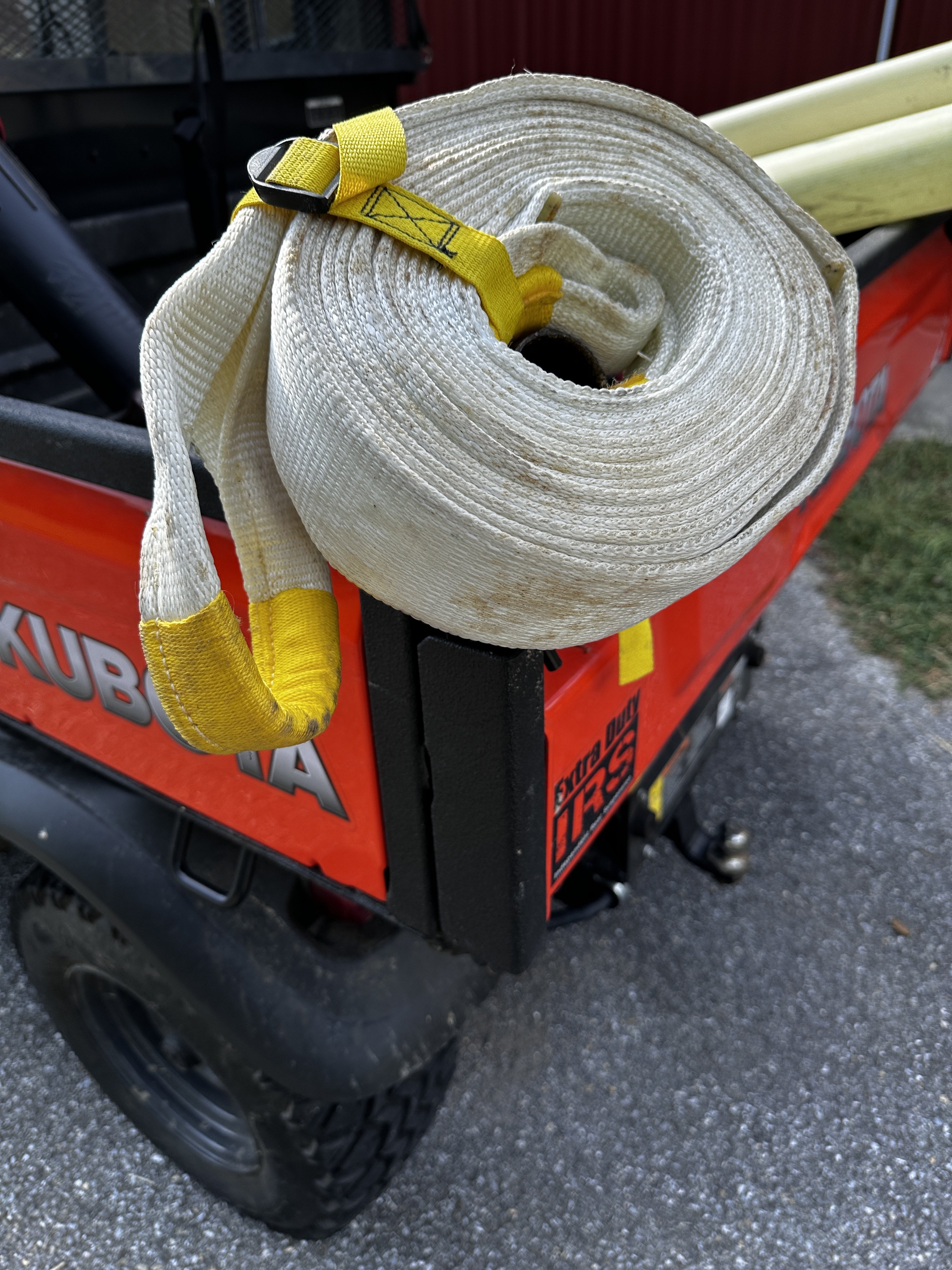

When it is a difficult stuck vehicle I will use this tow strap. It absorbs the energy and stretches and snaps back and multiples the towing force and jerks the stuck vehicle back a little. Sometimes have to do it a few times but it allows a smaller vehicle to perform beyond its weight class
What you are describing is a RECOVERY strap, not a tow strap. Tow straps are designed to minimize their stretch and should not be used to jerk something out. They are made for steady pulls. A recovery strap is designed to be elastic, and works as you describe.
