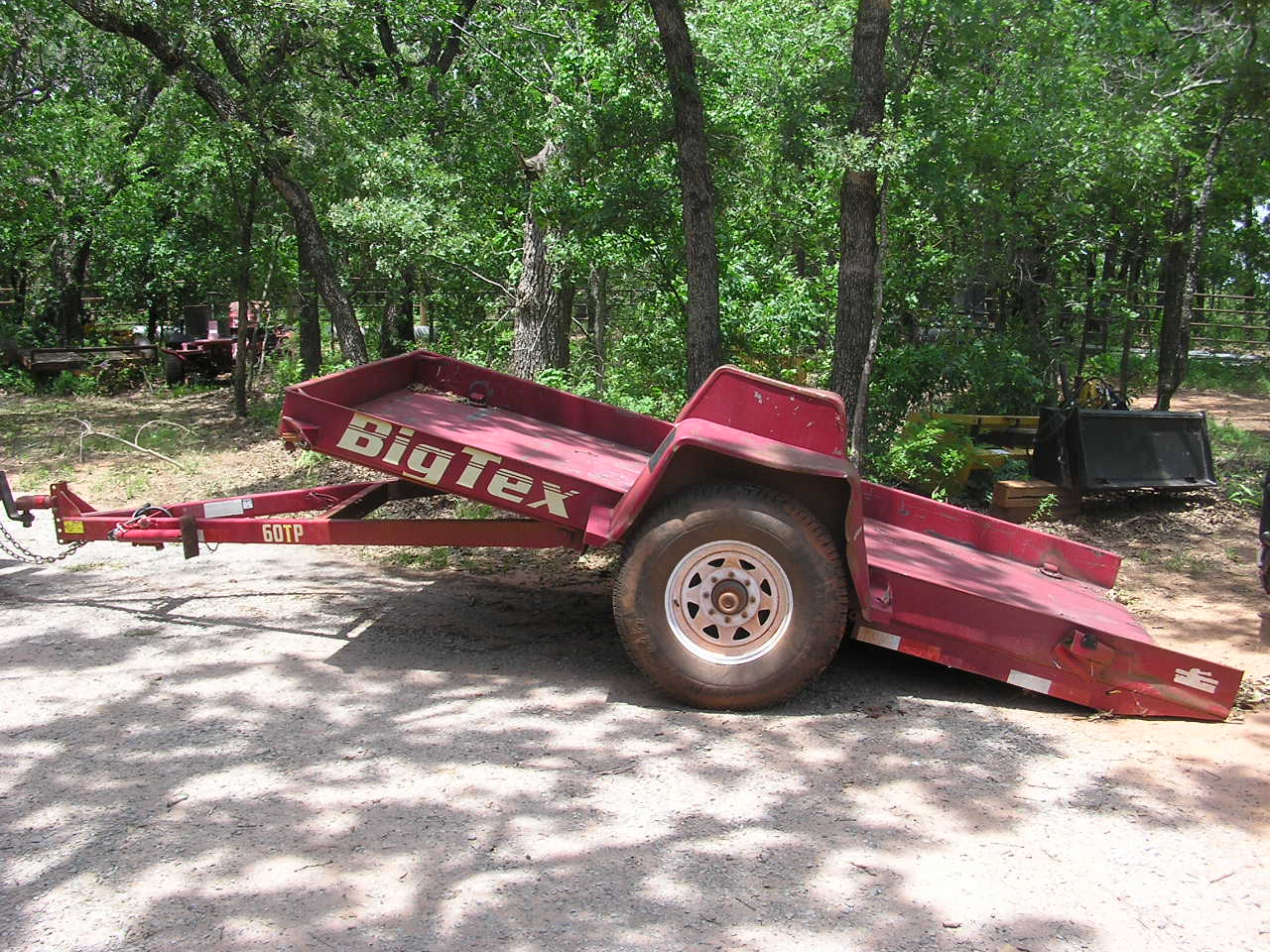

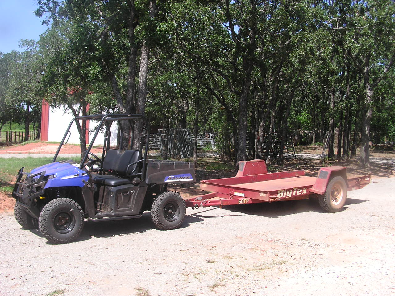

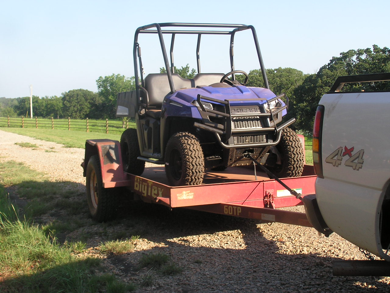

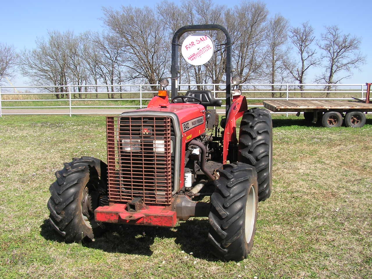

I have this 6x12, 6K tilt trailer.

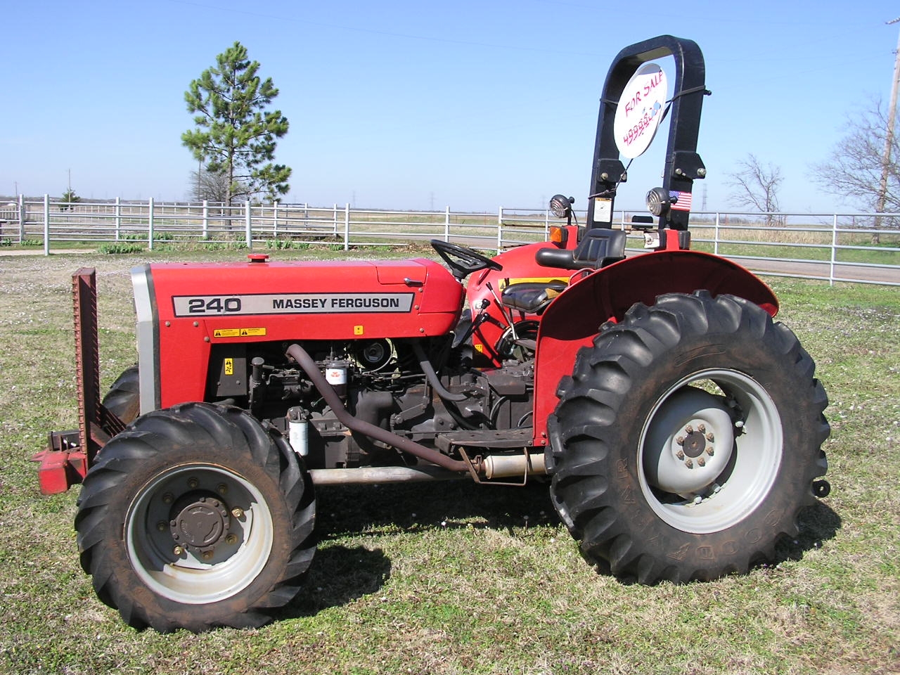

Have hauled this MF240D on it.
And hauled 4 of these 5x6 round bales on it, loaded from the side.
The trailer weighs about 1800 pounds. No ramps to mess with. Have load range E tires on it now, never had a flat or blowout in the 8 years that I have had it. The spare from my truck will fit it, so I don't carry a separate spare tire for it.
You have to be careful not to get too much weight, too far back on any tilt trailer, because of the extra overhang.
