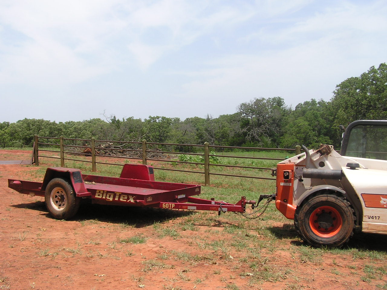

I have this 6x12, 6K tilt trailer.
Have hauled this MF240D on it.

No, the tractor just squeezed on, with the rear tires touching the sides.

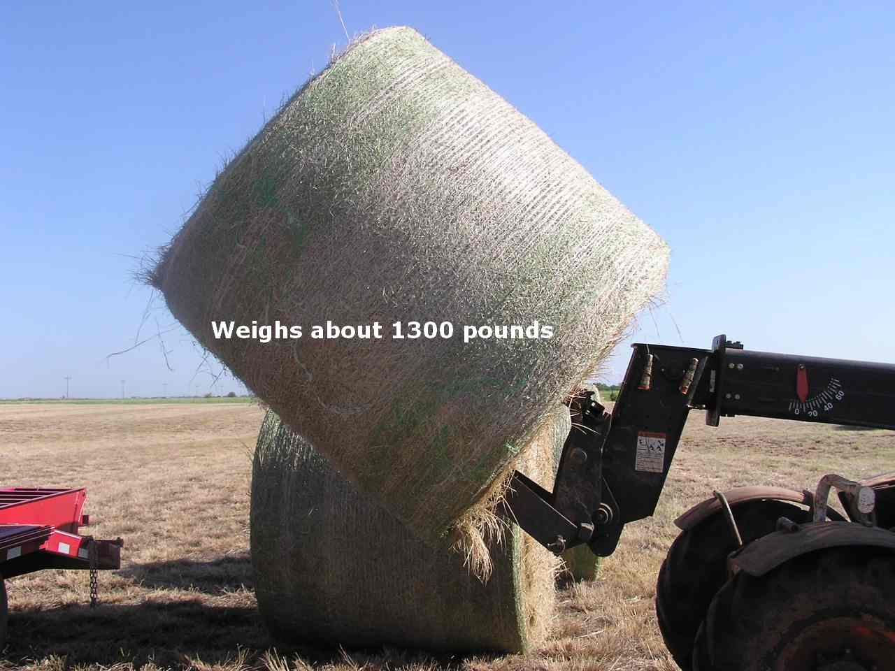

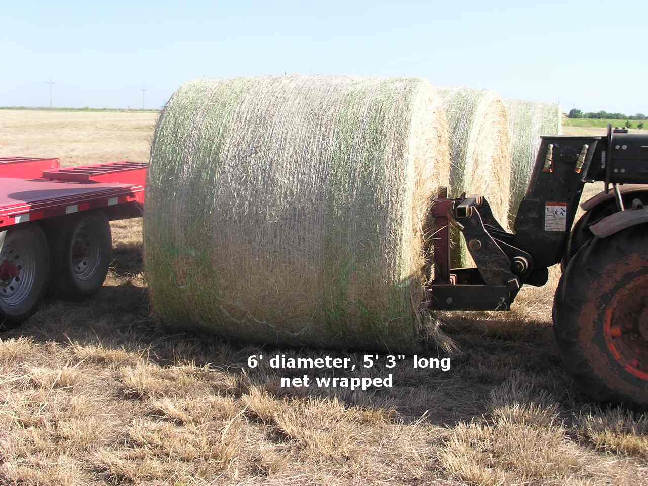

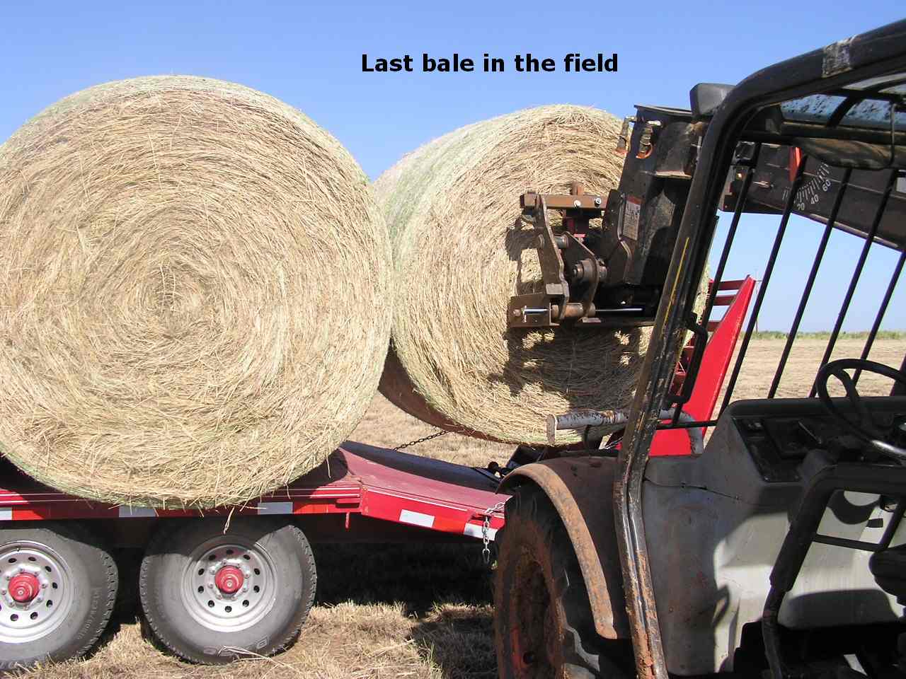

For the hay bales, I would put two ten foot long 6x6 posts in the middle of the tilt trailer and hook it to the receiver hitch on the gooseneck trailer.
Then I would load the bales from the side. The bale would set on the 6x6 and the edge of the trailer, two ahead of the fenders and two behind, with a ratchet strap to hold them.
10' 6" wide, It was 2 miles from the hay field to the barn on a county road, don't live there now.
These were taken in July, 2010.
I will take pictures next time that I haul hay.
