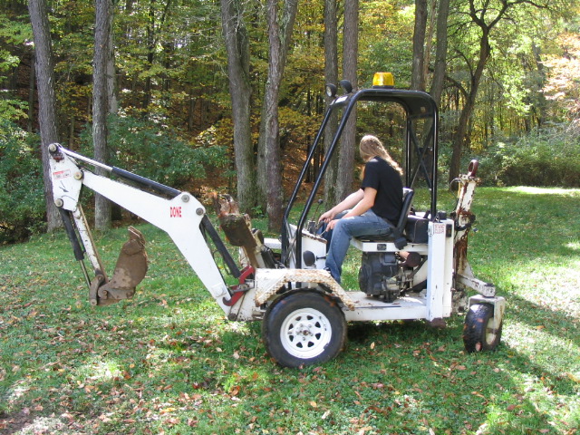

This is my Go-For-Digger, made by R.H.&M. Industries. Gofor digger towable backhoes As you can see, it has four outriggers and a lot of weight for digging, and hydraulic motors on the front wheels for moving around the job-site. For moving and towing, you lift up on all four outriggers, pull a pin and the back wheels lift up, with the tow bar dropping down, ready to pull. Unlock the drive wheel hubs (like an older 4WD), and it pulls easy.
I found mine on E-Bay and love it. Don't let the list price scare you... you can find them used.
