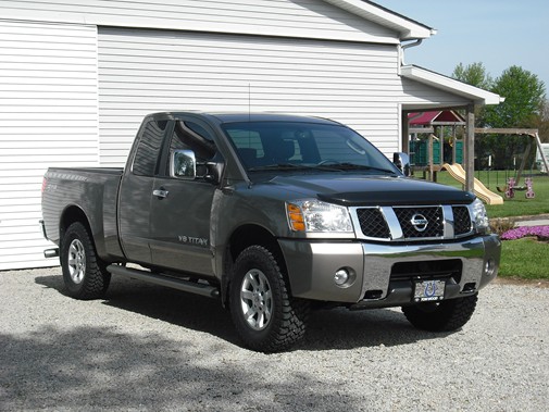

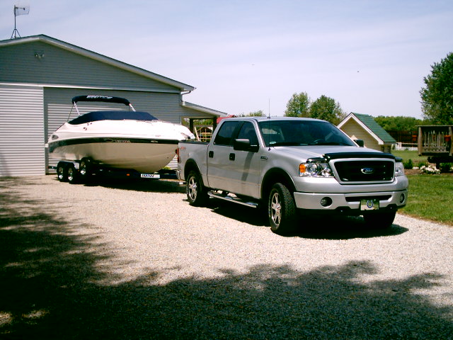

Thats funny to me. I am a Ford guy and just came out of a 2007-F-150 4x4 to a Nissan Titan and the Titan 4x4 will stomp all over the Ford. Trust me, I would like to see the Ford dominate but it just plain does not. I let my old college roommate drive my truck for a 75 mile trip, he has a Escalade and a GMC 2500 with the 6.0 gas, and he could not belive the Titan. He said after stepping out of it that his next truck may very well be a Import. Both trucks pulled the same 7K boat and equipment trailer on the same route.
One interesting thing about MPG's. The F-150 did 15.5 and 8 towing. The Titan does 14 on a good day but has 33" tires but will do 10.5 towing the same load.
At the end of the day it all depends on gear ratios. Put a 4.10 behind a S-10 with a 4.3L and it can tow a lot. Nissan only offers 2 gear ratios. You can tell which it has by the mirrors. Small car like mirrors and it has something like a 2.93 and big truck mirrors like mine has is equipped with 4.10's. Big gap there.
