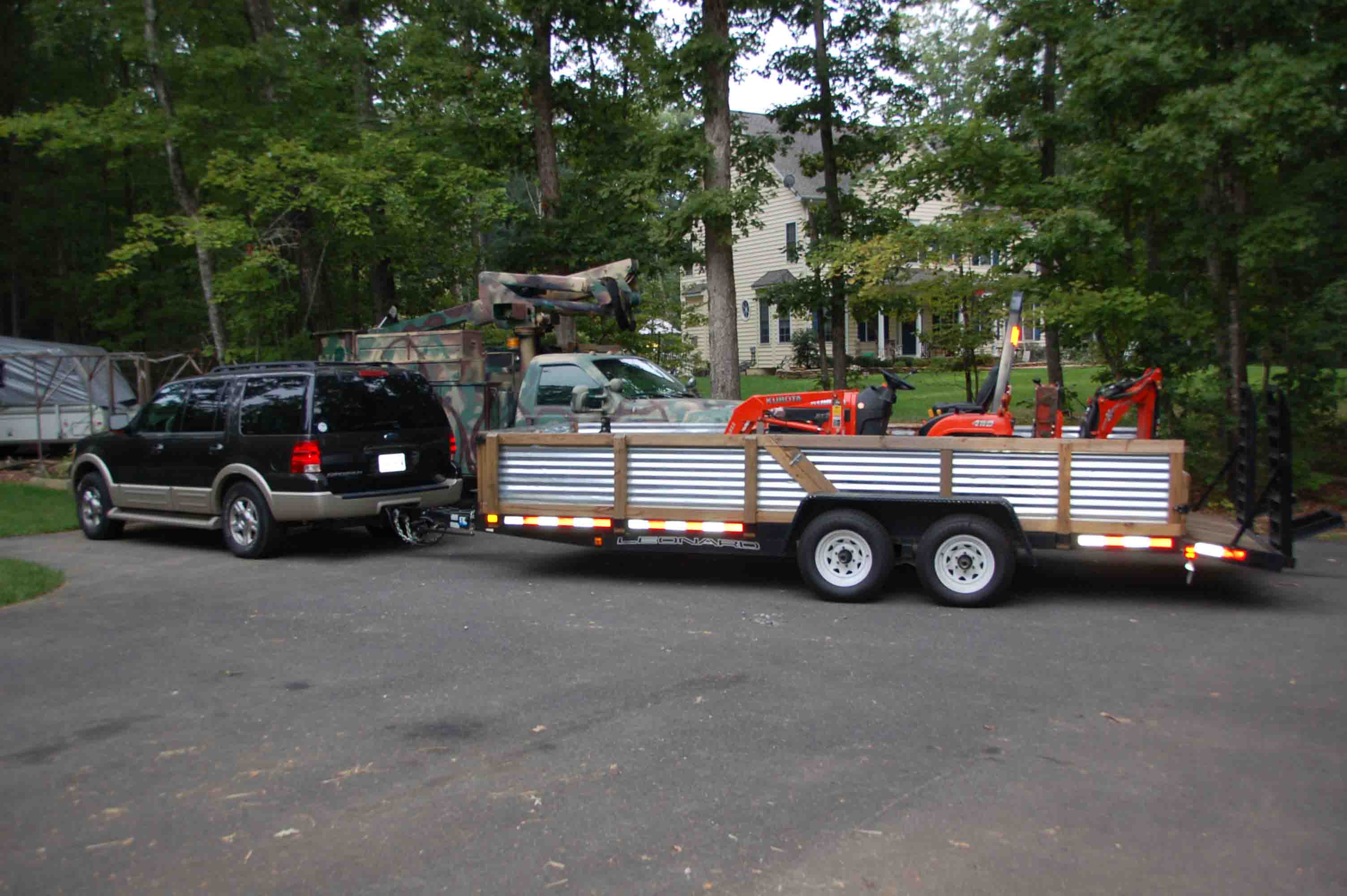

You NEED that heavy tongue weight even more so with a light tow vehicle.
Of course, in that 10% to 15% sweet spot. Apologies if my message was read as not having any weight on the ball...that's just silly.
Taking my utility trailer as an example: Without any load, straining, I can BARELY get the tongue jack off the ground...something around 300#. About right for a ~2,000# trailer. I put my baby tractor (with FEL and BH mounted) along with my box blade onboard and it is now a ~5,500# trailer. To be within the 10% to 15% threshold, all I need is ~300# to 500# more on the tongue (600# to 800# tongue weight). All that requires is placing my box blade at the front of the trailer and getting the COG of the tractor somewhere over, or just in front of, the front axle of my trailer. IT DOESN'T TAKE MUCH.
What really get my goat is folks that take their 30 HP tractor and drive it straight onto their bumperpull trailer, front wheels to the front trailer rail, back wheels somewhere around the axle, chain it down (if you're lucky) and call it good.
"Having heavy tongue weight" is no better advise than having no tongue weight at all.
Of course the intent of my input was to have the appropriate amount of tongue weight. Honestly, 2 out of 3 trailers I see on the road are VERY badly loaded and seem as though the owner/user forgot that THE TRAILER AXLES ARE THERE TO CARRY THE TRAILER LOAD.
What you don't see in the attached picture is my box blade (250#), 3PH reciever hitch (50#), and middle-buster plow (50#) against the front of the trailer. I load the tractor WITHOUT the WD trunnion bars installed so I can judge (by rear end squat) how much tongue load I put on the truck. I stop pulling forward when there is enough.
