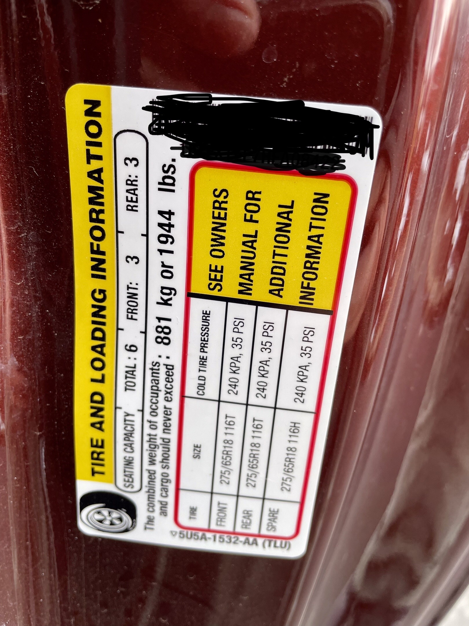

All trucks built today have a payload sticker. I posted a pic of mine. This is on the drivers door area normally. Don’t go by advertising or some salesman, look at the actual truck.

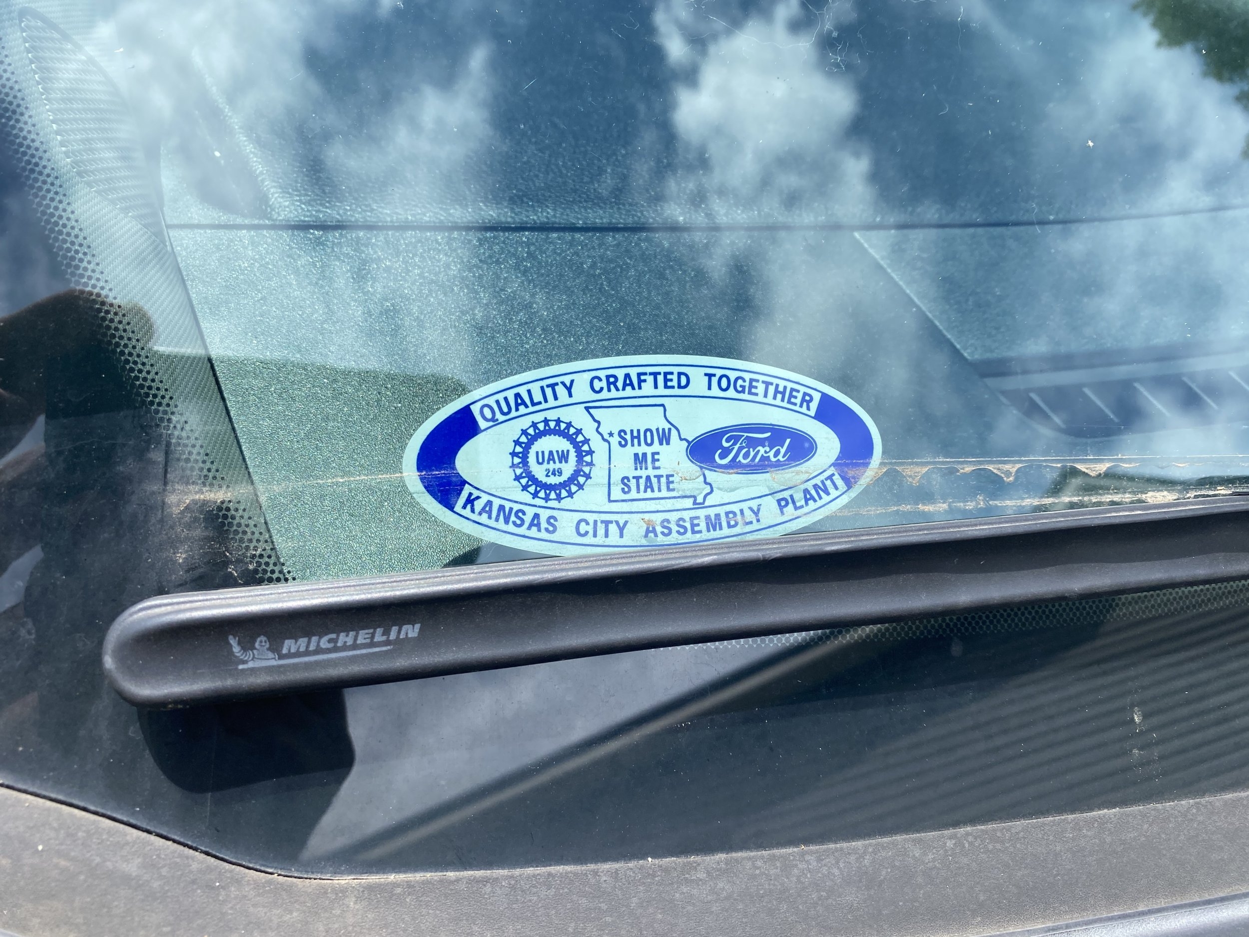

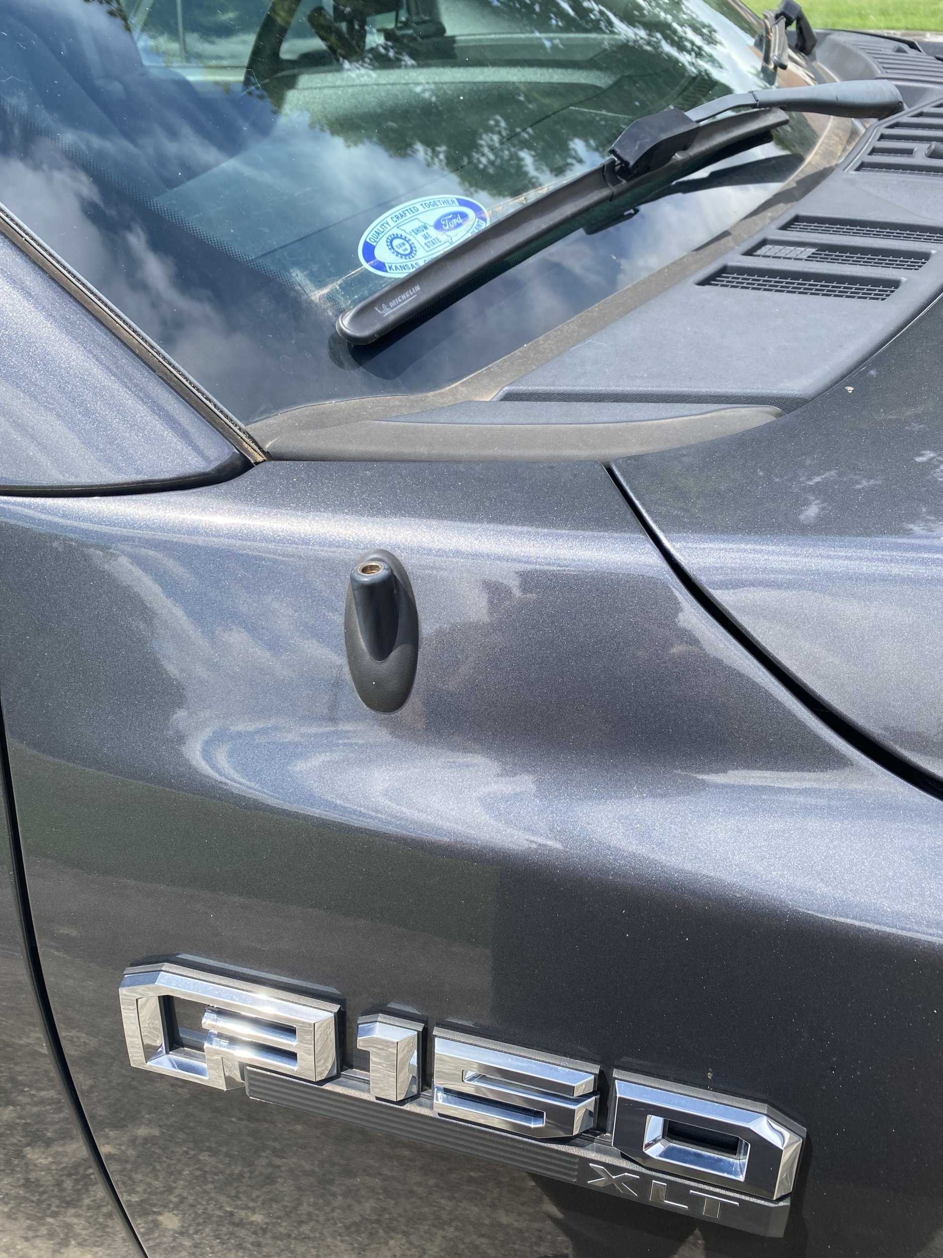

Hmm. Toyota Tundra made in southern Indiana - or Ford made in Mexico, Hmm...
Golly, I didn’t know Mexico was a suburb of Kansas City, MO.
Learn something new every day. Disinformation AIs would not have allowed the above posting if it wasn’t true.

That barcode is your VIN
