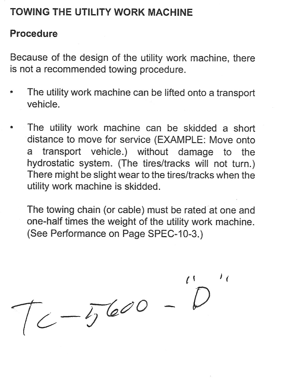

Here's the URL for the Tire Skates. I think it mentions that they are sold in sets of 4.
Tire Skates - Single Wide
Still not as cheap as a match and five gallons of gas....which if your TC dies in a client's driveway, you may prefer. Don't ask me how I know.
This looks like an alternative well worth trying.
Rip...good to "hear" from you and thanks.
   / towing a tc #42
Yeah, I suggested the 420 model as they were wider, but they are sold per pair rather than set of 4. In any event, look like they would be a fairly inexpensive way to safely drag or skid a TC a short way or up on a trailer or roll-back truck. Much less hassle than the official bolt method. AW has a LOT of neat hard-to-find stuff.
OK......what is the story with the gas & match ???? (Although I have been frustrated with machinery - and computers to about that extent myself)
I have not been on the forum as much lately - too many economic & political distractions ! ! ! Hope most folks here are keeping their heads above water .... things are not looking to get better short, medium or long term, IMO. Carve out a unique niche or be really versitile.
Good Luck !
   / towing a tc #43
You could very well be right. I will check back with the service manager tomorrow.
Rip, You were right, those bolts are for a TC 5600 " C " model. The service manager told me wrong, he assumed that the C and D were the same. The page below is straight out of the manual for the "D" model.
