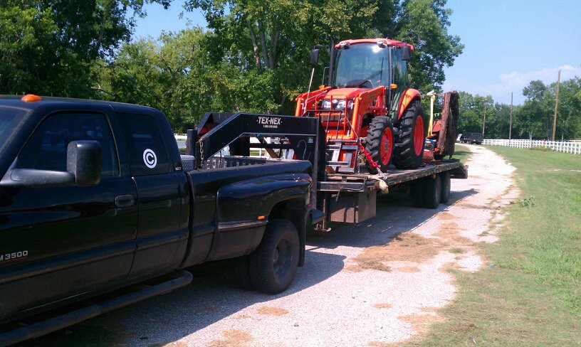

Here's a pic of my M7040 and a Rhino magnum that I picked up a few weeks back.

As long as you have standard rear axle setup on your batwing ( no walking beam axles ), then you will be fine hauling it on a 27+5 GN.
What I do, is drive the tractor and mower all the way to the front of the trailer, up against the GN. Then I flip my ramps back onto the trailer, then I back the tractor and mower onto the ramps. This puts the tractor about 6' further back away from the GN frame.
Still a lot of pin weight, but it will travel just fine.
As mentioned above, your 7.3idi will haul it just fine, just won't get up to speed very fast, and will lose speed on any hills. You ought to gross close to 30k with the truck/trailer/tractor/mower

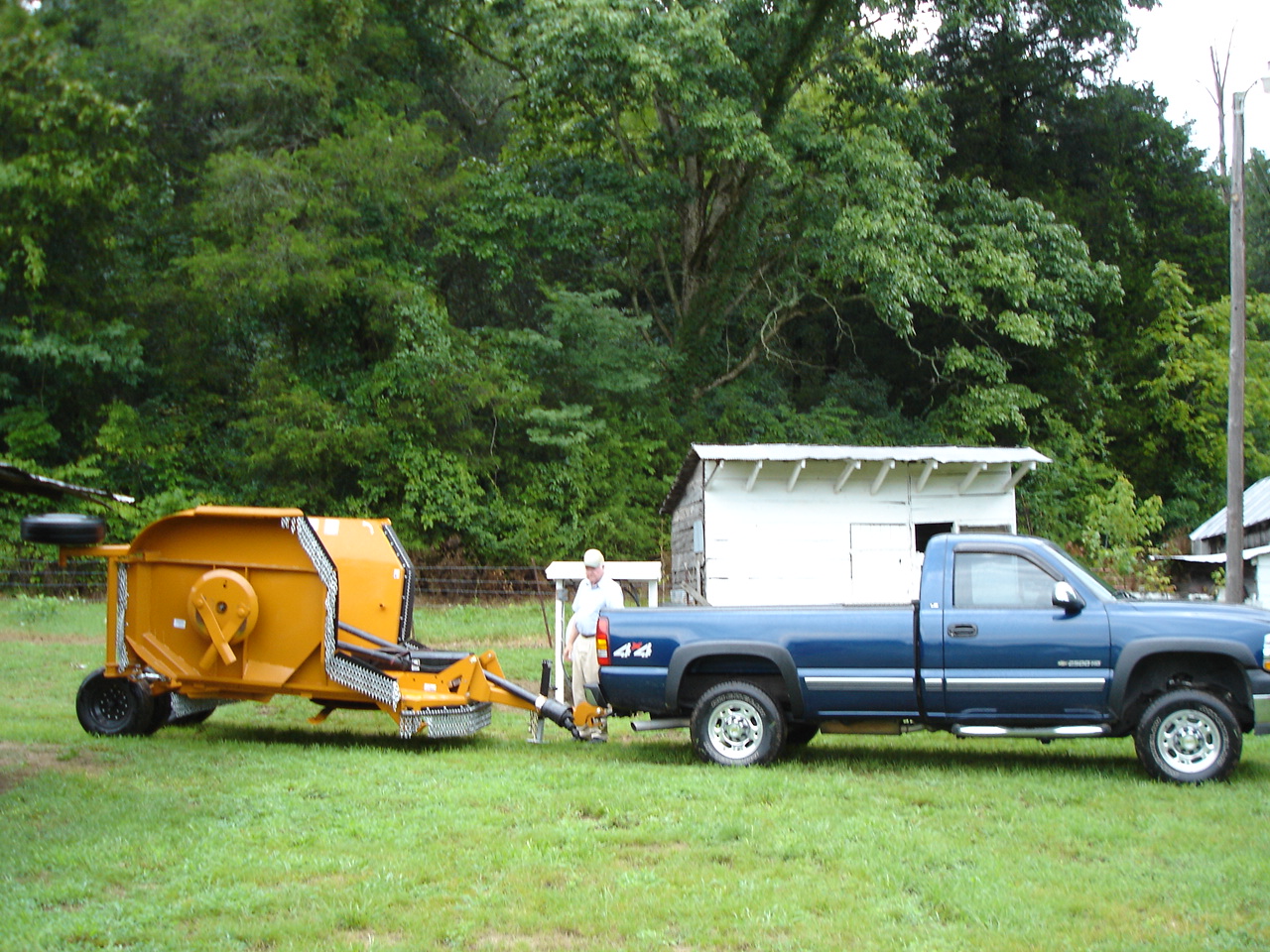

Just an update with some pics on hauling the BW over to the farm. We hauled the BW over Friday morning with a 3/4 ton Chevy. As you can tell from the pic, it's little heavy in the rear but it pulled just fine and speed was kept to a minimum so we had no problems whatsoever.

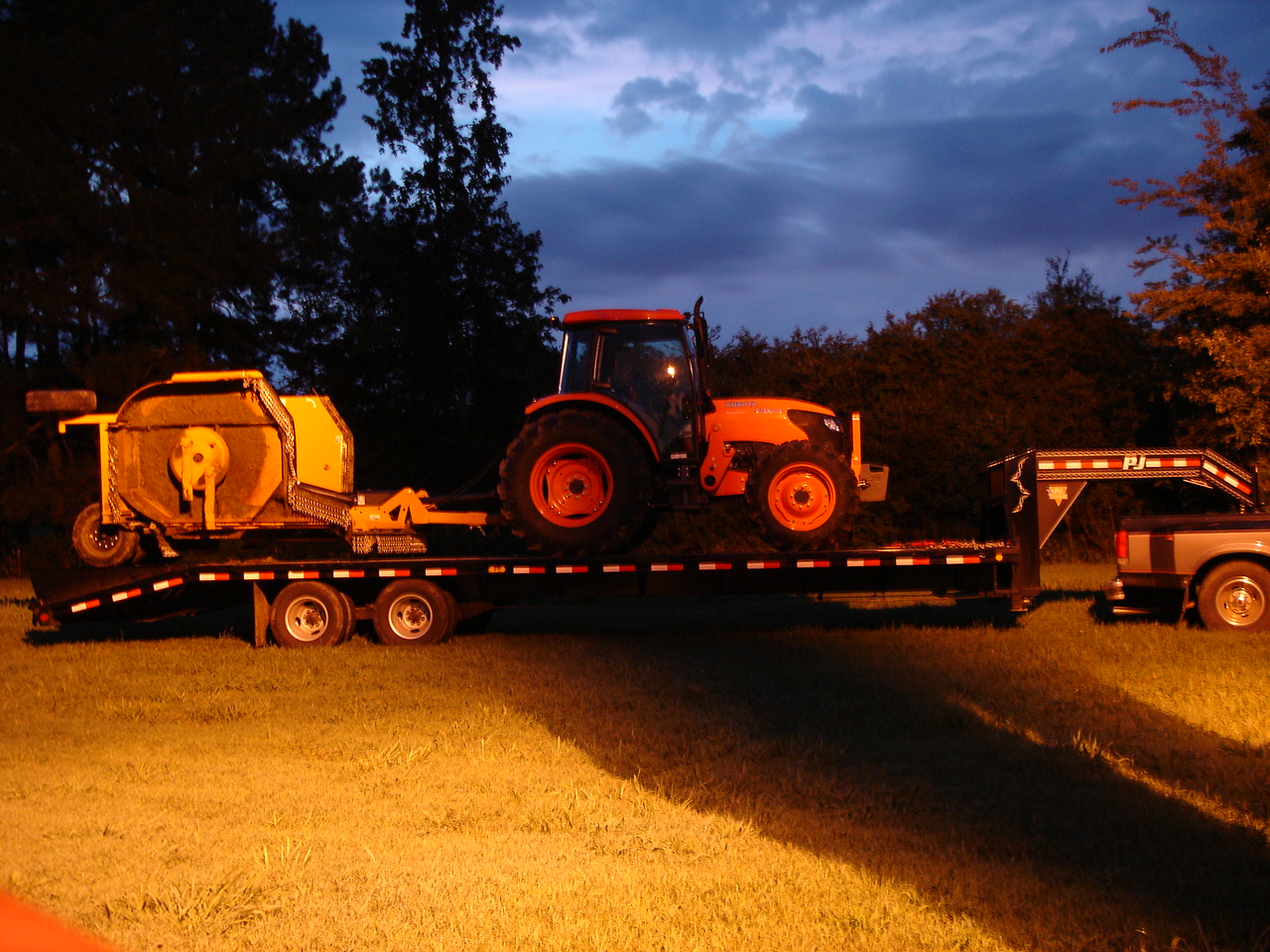

On the way back home Sat evening, I tried loading both 9540 and BW on the GN and towing with the 7.3 '89 F350 Ford. Like CCOUGHRAN1 suggested, I pulled all the way up to the bulkhead, flipped the ramps over and then backed over the ramps to move the weight to the rear. Truck pulled it better than I thought it would. Sorry the picture was taken at night after I had gotten home and it was dark. We forgot to take one at the farm earlier.

Nice pics! In addition to the chains to lock the wings in the up-right position, did you add any other straps or chains to help secure the wings? That is my biggest concern when hauling mine on the trailer-how to keep the wings from swaying back and forth...

Wow, that is tongue heavy. Put that Chevy's front end skyward.
