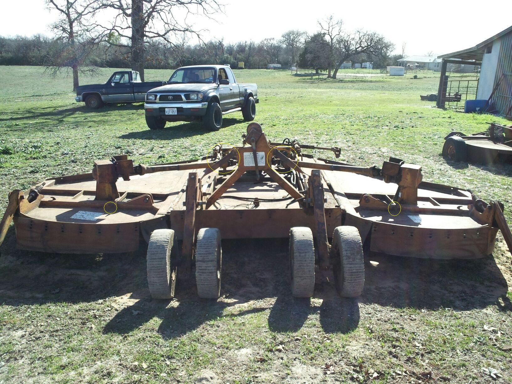

Nice pics! In addition to the chains to lock the wings in the up-right position, did you add any other straps or chains to help secure the wings? That is my biggest concern when hauling mine on the trailer-how to keep the wings from swaying back and forth...
Hawk
Hawk, thanks! I did not put straps on the wings. They were locked in transport mode (secured with steel bars) and did not move. The rear wheels that hang out over the wings do sway slightly, but only slightly. Probably would be a good idea to throw a strap on those next time to keep them pulled inward though.

OK. The difference is mine are secured in the transport position with chains rather than a steel bar. The keep the wings from folding out, but not inwards. Fabricating some sort of steel bars to provide rigid support seems to be the solution. Now you got me thinkin'...Thanks!!:thumbsup:

In yellow is the bars that pin into the small yellow circle batwing2+.JPG. Yeah no cylinders on mine,all hand power:D But will be adding some soon dont wonna do it to many times in a day...
