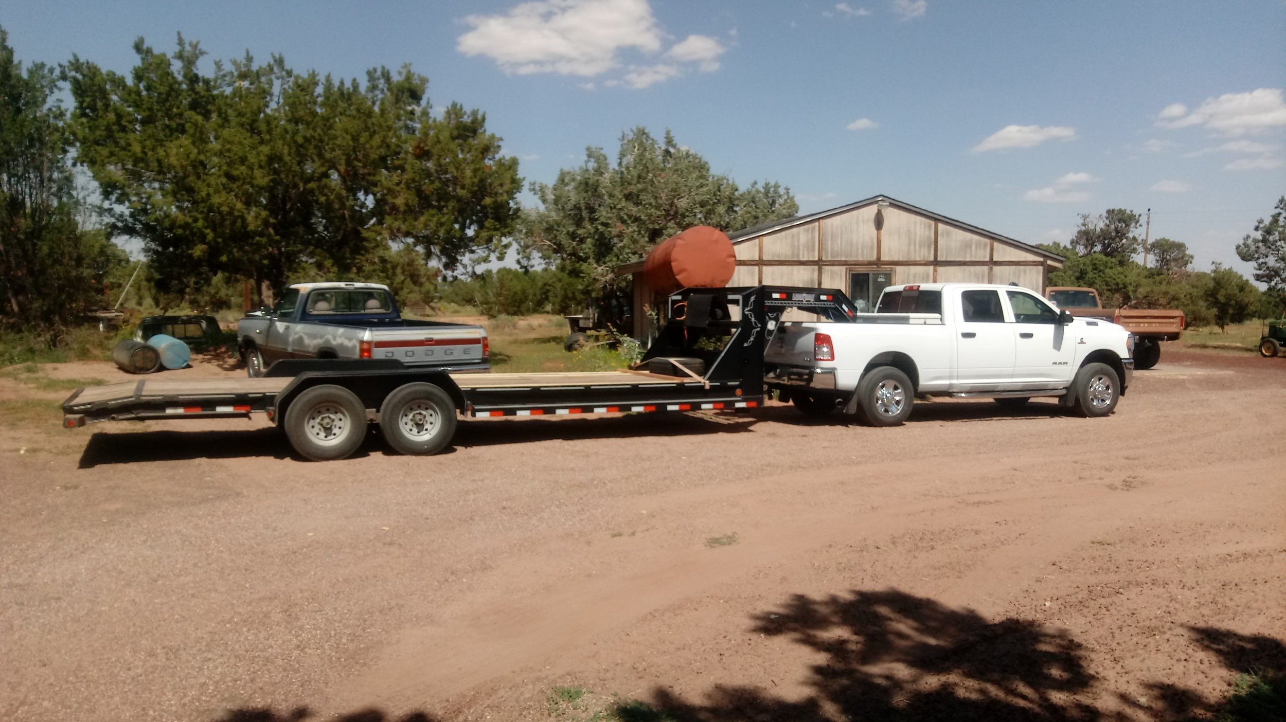

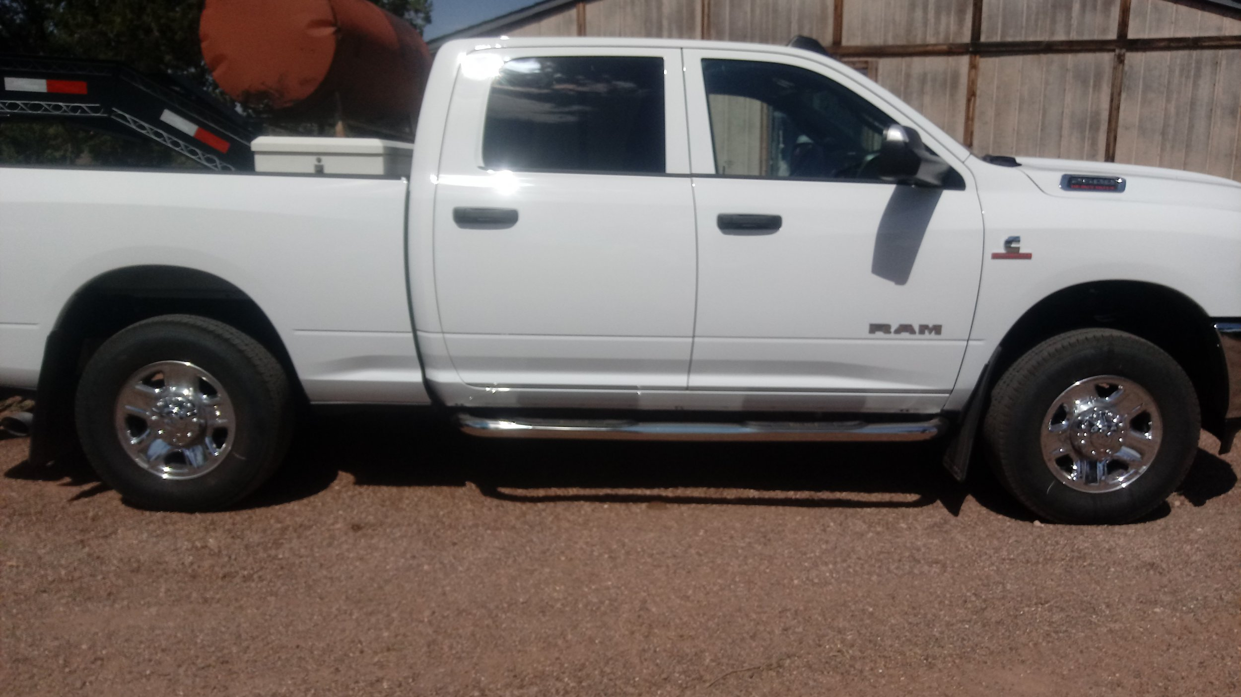

With a 5th wheel towing arrangement you are in a totally different circumstance. The exact same load on an identical trailer (but one with a hitch ball tow arrangement for a receiver hitch instead of a 5th wheel pad) WOULD lower your rear bumper by a lot more than 2-3 inches.
Yes, the hitch type you are using plays a part in how much the truck drops. It takes more weight with a gooseneck, to drop the same as a bumper pull. However, my point was/is, regardless of the hitch type, 2"-3" is the most drop you want. At least on a HD truck. That is about the amount of factory rake that is built in. I don't want to go beyond level. Light duty pickup? Yes, they probably have more rake and more suspension travel. I don't have a 1/2 ton anything.
Here are some pictures I just took of my truck, trailer and suspension travel. With the empty car trailer, my rear fender well is 3/4" higher than the front. When I load my Ford pickup (5500 lbs) the truck will drop another 3/4" and I will be level and loaded. Or about a 3" total drop from my empty truck as delivered, new. I have about 500 lbs of Tools, chains, binders and etc., so it probably starts out an inch low from the get go. Note the bump stops. I don't have 5"-6" of suspension. That is about a 2.5" gap with the empty trailer. I need at least 1.5-2" of wiggle room for suspension travel before bottoming out (a no no).

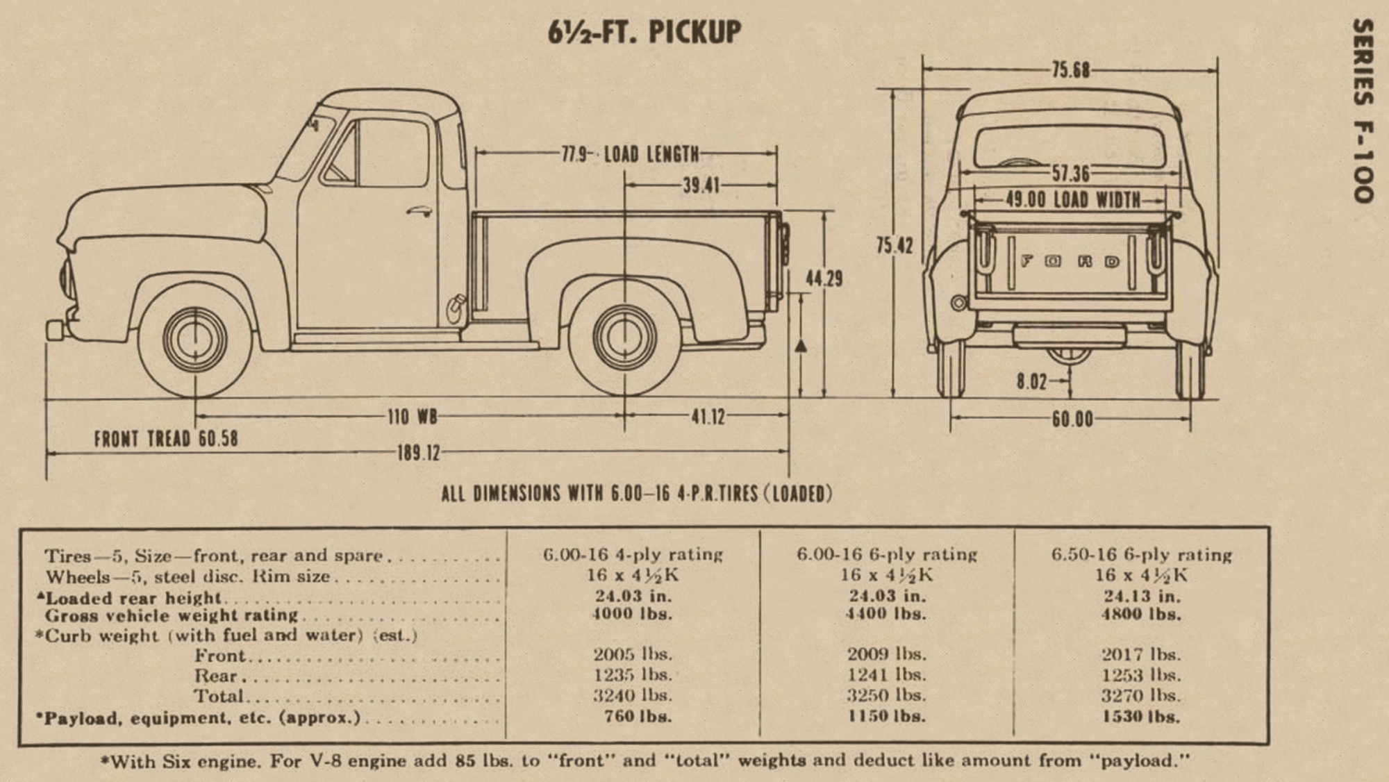

I'm talking using a half ton 4WD pickup. F-150.
Help me understand what you are saying. An F150 used to be a 1/4 ton truck because it's payload was 500 pounds, or a quarter of a ton. Modern F150s are a wide range from 1280 lbs to over 3200 lbs. Most configurations are well over 1700 lbs payload. That makes most modern f150s at least a 3/4 ton truck. There was probably a time when an f150 had a 1000 lb payload. Is that what you mean? You have an older f150 that only has 1000 pound payload?
   / Towing capacity #129
From:
"For 1975, the F-150 was introduced; a higher-payload version of the F-100 (intended to circumvent emissions standards), the F-150 would become the most popular version of the model line (ultimately replacing the F-100)."
Didn't say what the payload ranges was.
Bruce
   / Towing capacity #130
1953 F100
Bruce
