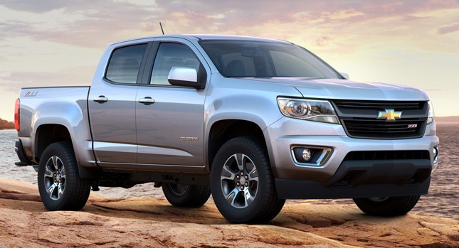

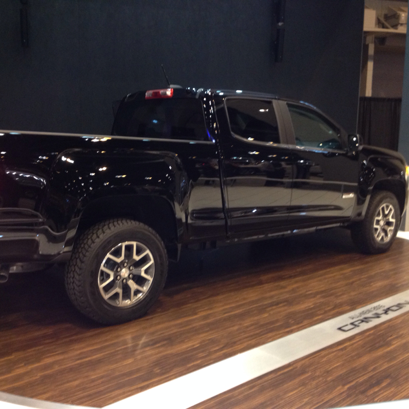

I'm not sure how quick you need a smaller tow vehicle, but if you can wait till fall I would recommend one of our new GM mid-size trucks. RWD primary w optional 4WD. Two bed length options on crew and extended cabs. Tow capacity is 6700lbs and offers trailer sway control w decent control also. http://www.chevrolet.com/2015-colorado-small-truck.html image-165204540.jpg https://www.gmc.com/canyon-midsize-pickup-truck.html image-2662343888.jpg
