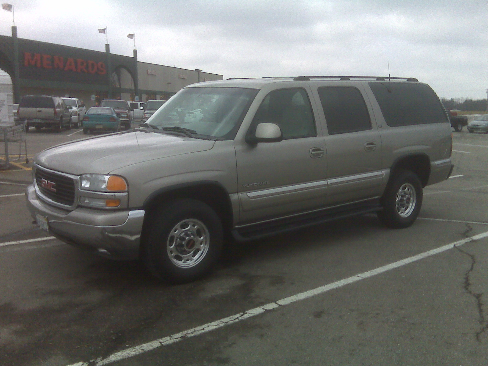

I purchased a Y2K GMC Yukon XL 2500 new, the current mileage is under 37,000 actual. The OEM tires are Firestone LT245/75R16E, and the tread isn't even half worn out. The only sign of use, other than the tread wear, is tiny, hairline checking in the bead area. The truck is garaged 99% of the time, and the only towing use is a half ton aluminum utility trailer that might get 100 miles use per year, half of that when loaded to it's one ton capacity.
Every spring, I rotate the tires front to back, cleaning the sidewalls well with a power washer, and then applying two coats of Protect-All. EVERY year...at least every 2000 miles.
Now, if you were me, in my situation, would you shell out $1000 for new tires?

I wouldn't but you must be retired or thats your sunday driver? Thats a lot of money to spend on a brand new truck not to ever hardly drive it? Just sayin!
My wife and I worked in the same place, a 12 mile commute one way, but we needed two vehicles so our car got used for most of the work miles, and less than 3 years after we purchased the GMC our employer offered an early retirement deal that we both took. I used the truck for a materials hauler and my part time carpentry job after we retired but the way it sucks gas (4X4 with 4:10 gears) I try to drive it as little as possible. Thought about selling it when we retired but I really liked it and the depreciation hit would have been really bad at 3 years old, so we are keeping it.
