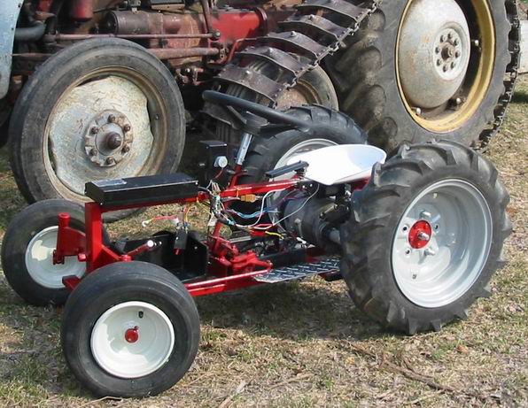

talent? I dunno- resourceful maybe :) and with contacts that made the bodywork possible. The 1/2 scale hood is too small for even small riding lawnmowers but something in fibreglas to suit a riding mower would sell a signficant number, I think.
But I agree, most people interested in something like this 1/2 scale unit could do the work themselves.
It ended up at 1/2 scale because I measured the height of the rear tire and compared it to my 8N. Next I measured the width and wheelbase and went from there. Most of it is angle grinder and stick welder (don't look too close!).:)
Basic electricity knowledge sorted out the scooter controls and mechanism.
The body was basic woodworking and patience ( a lot of scuplting/interpreting required.. That ford hood is not as simple a shape as it first appears!). A friend has a large vacformer and did it for me free.
I bet if the boy drove around a tractor show with body kits on a trailer-they would sell on impulse- we all have projects we're going to get around to- some day!
I'd be happy to help anyone interested in doing something like this, I've sorted through a lot of deadends getting to this point.
Here it is without bodywork (jpeg)

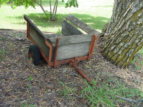

Here's the perfect trailer for the perfect toy tractor.
