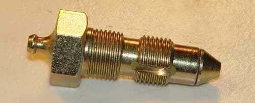

WCDad I recommend that you study up on your track tensioner system before heading out to the woods. If that track is loose, it will come off. Then you're really in for a crash course on track tension. Especially the track comes comes off the wheels in a mudhole or in heavy brush - it can be no fun to put back on. If it won't tension your machine may be stuck there until you get the tension system working. I have a hard time believing a track tensioner zerk could be plugged. Some track tensioners don't have a removable zerk, such as the one pictured below.
492600d1482601276-track-tensioner-wont-take-grease-41wgsyeujdl-jpg
Notice that this one has a tapered "seat" like a brake bleeder. It has a slot to release the grease, so you unscrew it partway to open the 'seat' then more turns and it exposes the thread-slot to release the grease, then the track can be slacked. I was able to jam a short log between the track and the dozer blade using hydraulics to shove my track tensioner back (which squirted grease out the slot). Of course you can unscrew it all the way too but don't drop it into the mud.
On this one, you can see the zerk is not replaceable. http://a.co/bL3V39z
If you post the model of excavator you may get a higher level of assistance. Zerks have a specific thread. To replace them the new zerk must be the same thread, either US or metric. Usually it's much faster to poke it from the outside, then unscrew it, dig it out with wire, put it back. Sometimes where exposed they can be damaged, or corroded from non-use, in that case replacement is the only way.

I will be back there next weekend. I'll take a package of zerks with me. Thank you all for the advice. I will update with the results. Hoping a new zerk fixes this.

I'll bet on metric. I only live 10 miles from a dealer so I will call them and get the zerks and some spares. They are 90 degree and removable. I had to change the angle of the one that worked by unscrewing it just a bit. I will look thru the manual and the software version shop manual as well. I tend to keep some spare parts for small stuff like this. It drive my wife insane
