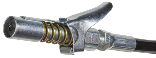

Probably a dumb question however what kind of grease gun are you using? Are you getting enough pressure? Back in my mechanics day, we used a hydraulic pump to bump hung up track tensioners. Also, the tracks and track frame needs to be clean to allow movement.
   / Track Tensioner won't take grease. What do I do ? #39
I swapped out the grease fittings. I was able to pump three times and then nothing else would go in. I guess I have some work to do. I am not sure how I am going to access the tensioner...I have a feeling this is gonna suck.
Before I would take anything apart, i would reiterate trying a lock-n-lube grease gun nozzle. I had a grease zerk I couldn't get anything in, but hooking up one of those did wonders. Grease sailed right in. Maybe mine was hardened grease in the zerk or somewhere else down stream, I don't know, but it works. Okay, i'll go back to my garage now.
   / Track Tensioner won't take grease. What do I do ? #40
I removed the pipe and coupler from my 10,000 PSI lever gun and put on a hose with a LockNLube.
Here is where I found out about it: http://www.tractorbynet.com/forums/oil-fuel-lubricants/304889-locknlube-cupler-grease-gun.html
Muchly gooder. :D
