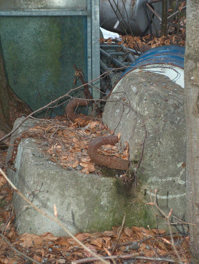

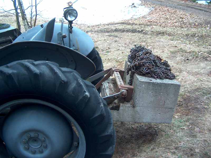

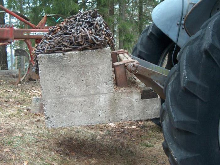

I have showed this ballast here earlier. Most people think it will ruin the lifting arms. It wont, it has been used on the tiny Fergie arms for 50 years!
Just hitch and go, you wont even have to get off the tractor.
Some of the weight is transfered to the lover part of the lifting arms, preventing the ballast from swinging. The heavier ballast the better, both for traction and for saving the front wheel drive. (the weight in the last pic has fallen backwards)
