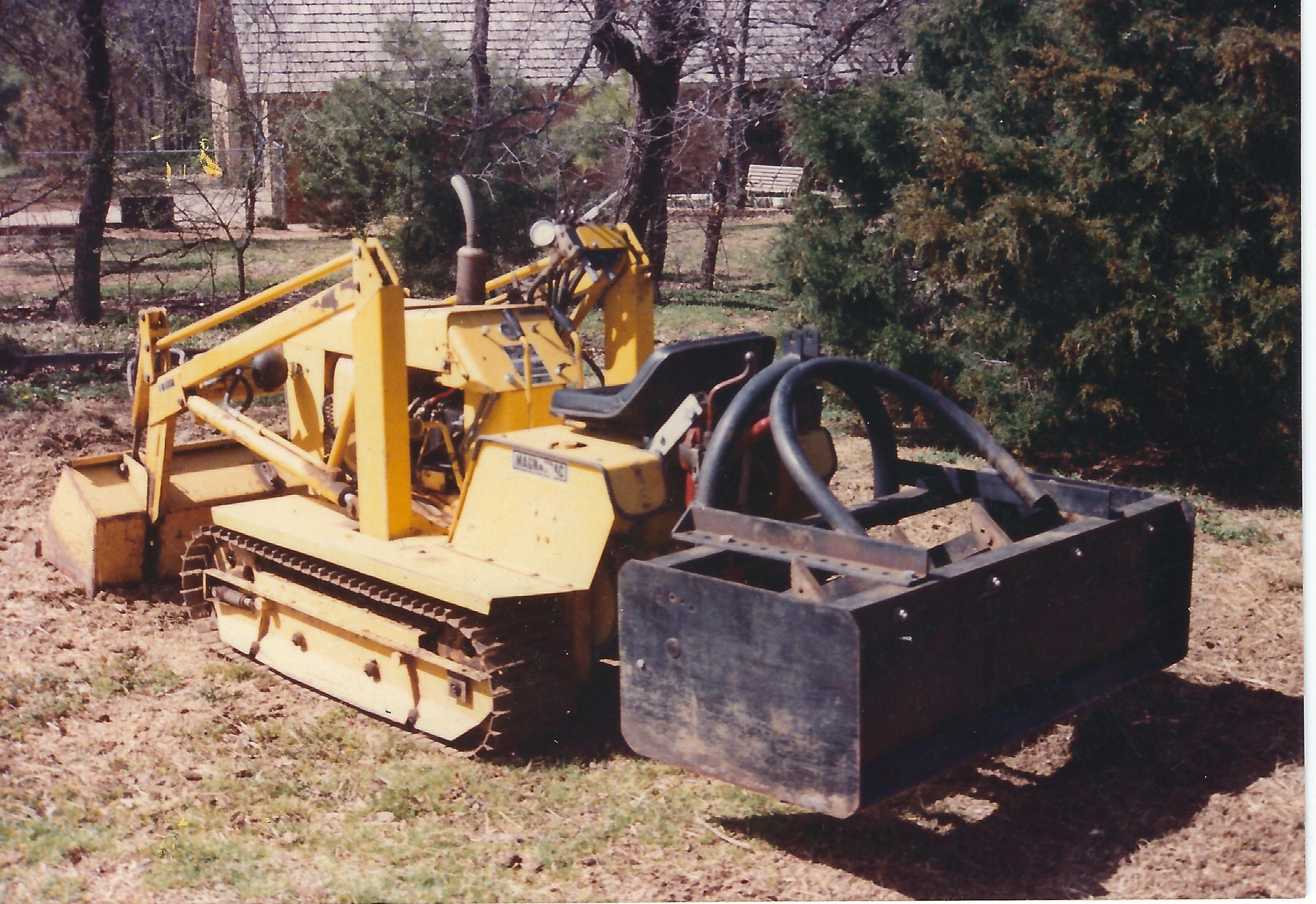

A little, little dozer can be very handy :thumbsup:
With the 4' box blade:

it really is in great condition as far as the sprockets, chain, track pads, and rollers go. I see no reason to think any of the undercarriage components will ever need to be replaced in my lifetime of homeowner use.
Did you confirm this yourself? The above pict. isn't very big, but that doesn't look like the case from the pict., of course like I said, the pict. isn't very big to see clearly...
SR
   / Tractor and HD Box Blade vs. a small Dozer? #70
SR
That appears to be a little Magnatrac loader.
A very little .... "play machine".
