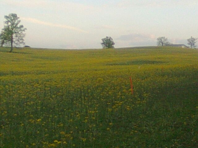

mwing bottum 3.JPGbottum finished.JPGthe bottum.JPGmcrees.JPGfresh cut pasture.JPGmowing pic.JPG 7040's side by side.JPG
I figure I would show you in pictures,for reference....

Nice rigs, nicer ground. Definitely more rolling than my hilly patch! Thanks for the photos.
