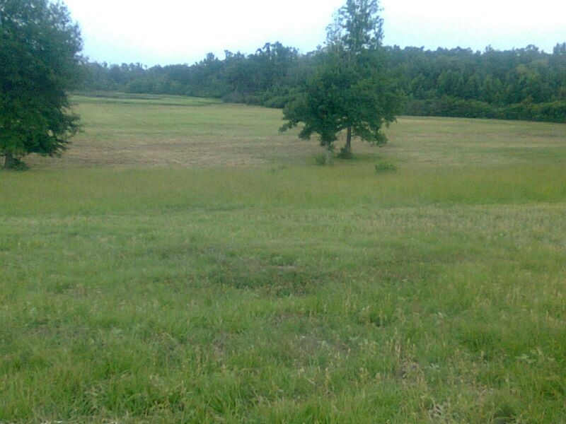

The 8ft is a Landpride(RCR3596),the 12ft a Woods(DS1440) and the 15ftbatwing of my father-in-laws a 1979 TerranKing. The Landpride has been a good shredder...

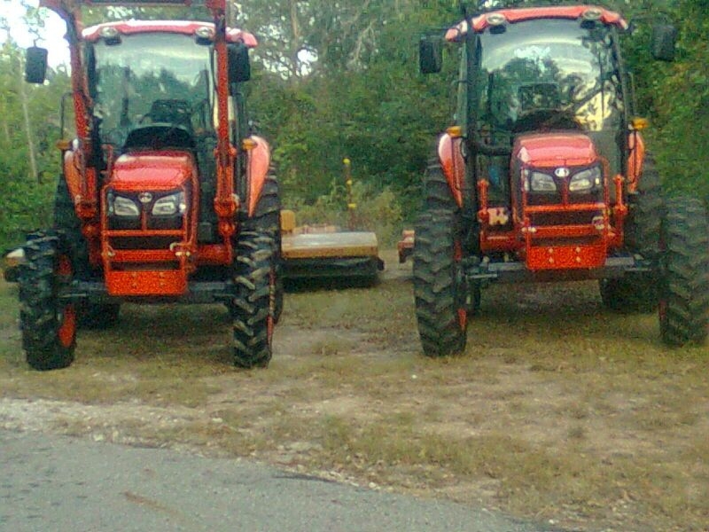

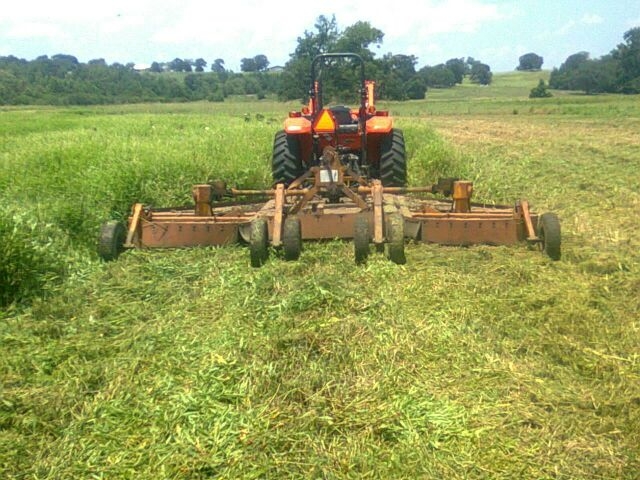

   / Tractor and mower combination #14
mwing bottum 3.JPGbottum finished.JPGthe bottum.JPGmcrees.JPGfresh cut pasture.JPGmowing pic.JPG 7040's side by side.JPG
I figure I would show you in pictures,for reference....
