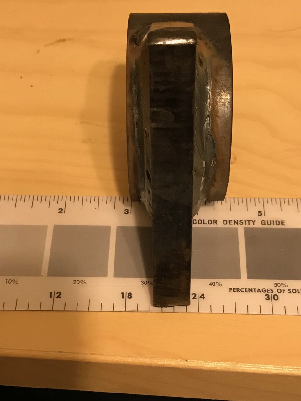

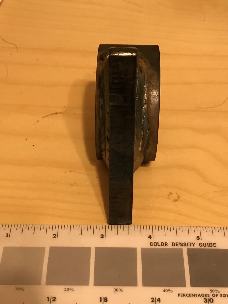

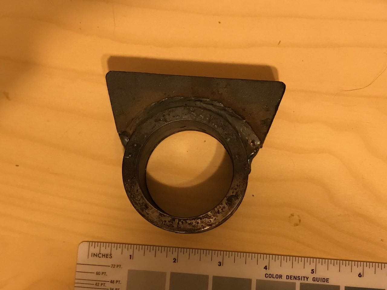

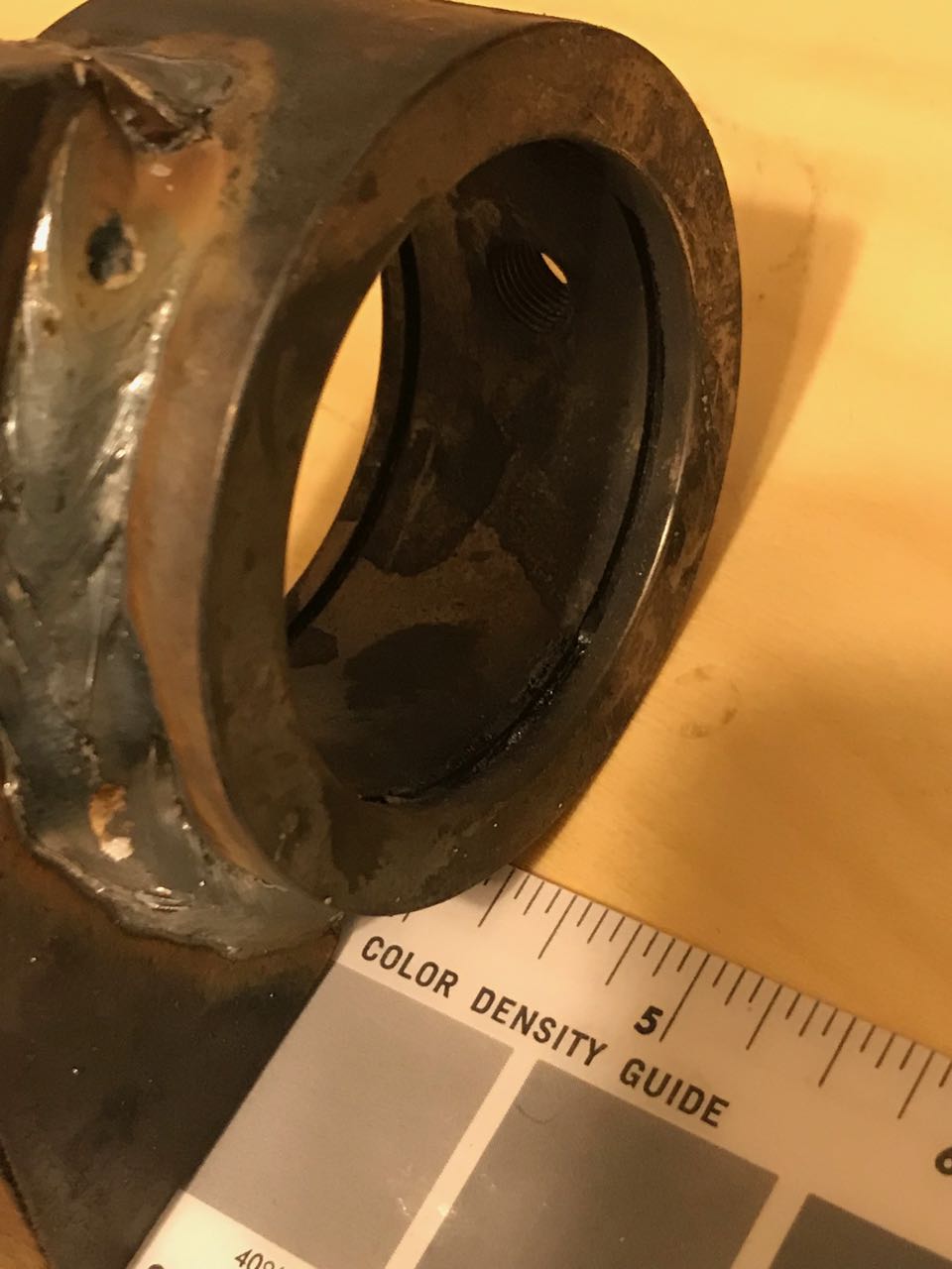

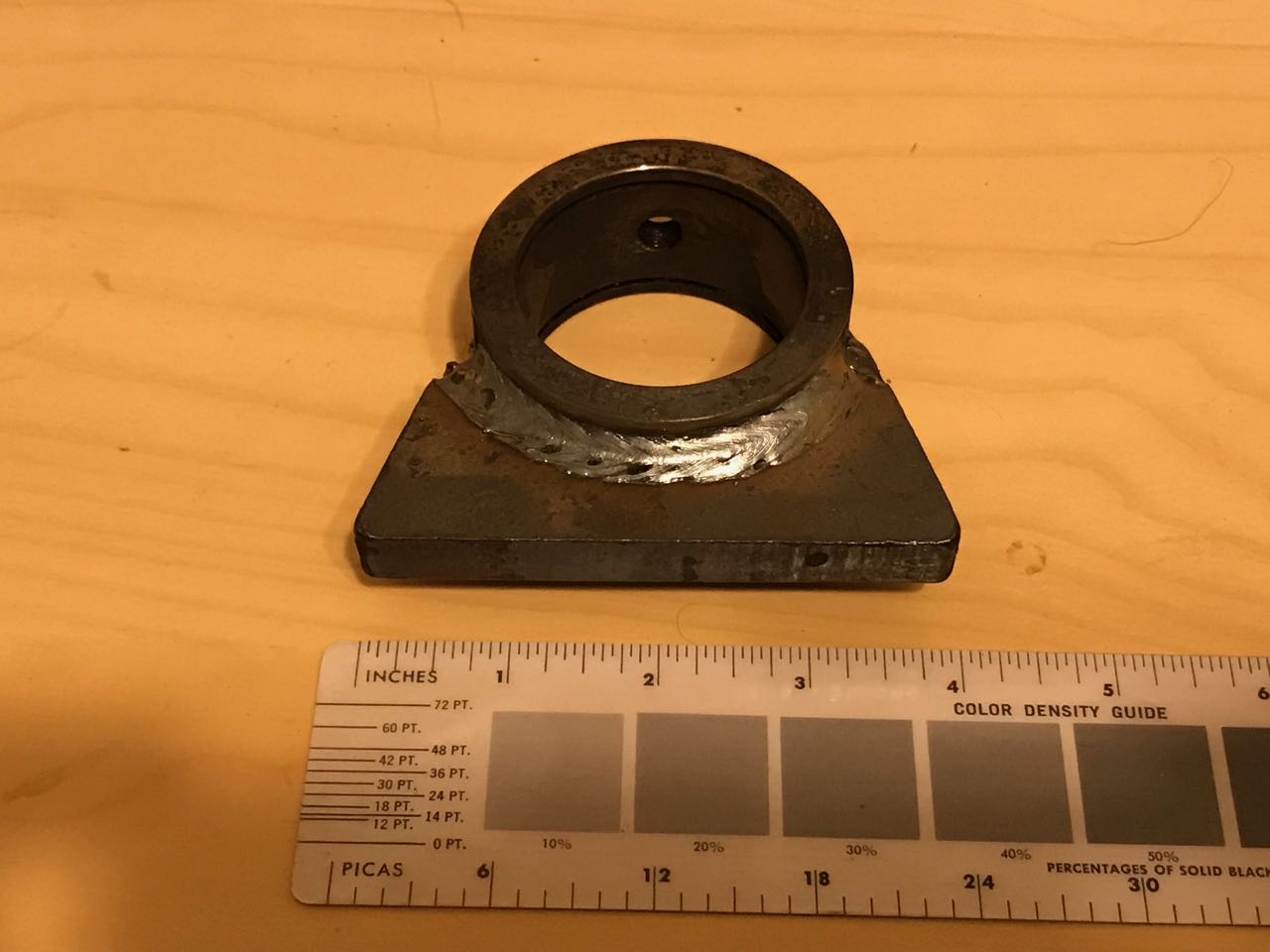

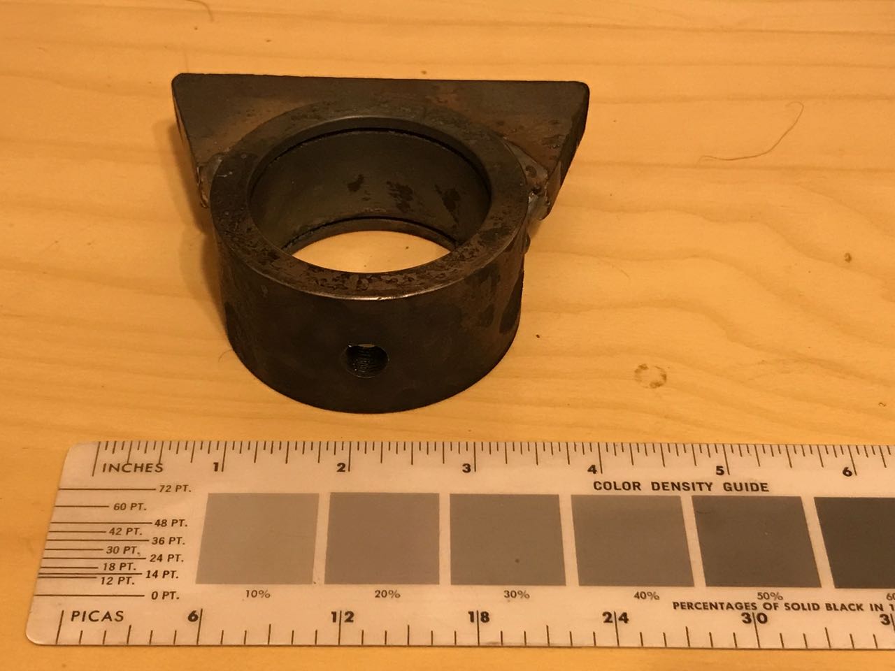

So the new center section arrived today. Over the weekend I am going to devise a few plans to beef this piece up, and Monday will go to the steel shop and see what they have.
Taking all ideas here, if anyone has one.

Carl-
I'm no engineer, but it seemed to me that your old one broke right at the end of the weld. That could be caused by a lack of strength, brittleness from welding, or random. I'm betting it is one of the first two. Adding metal, and then a little post welding heat treatment should help.
Given where it broke last time, I would be tempted to get some E10018 welding rod and build up the perimeter starting at the triangular base, crossing the existing weld and going at least half way around the perimeter of the inset/attached tube. I would work up a couple of passes until you have added another 1/4" of material along the outside of the piece and over the existing welds, which will be (I'm guessing) probably be 3-4 passes. I would also try to add more material at the join to build up the web. (If you think of the perimeter of the part as a keyhole, I would be trying to make the keyhole into more of a triangle by adding material at the sides of the circle/triangle intersection.)
All the best,
Peter
