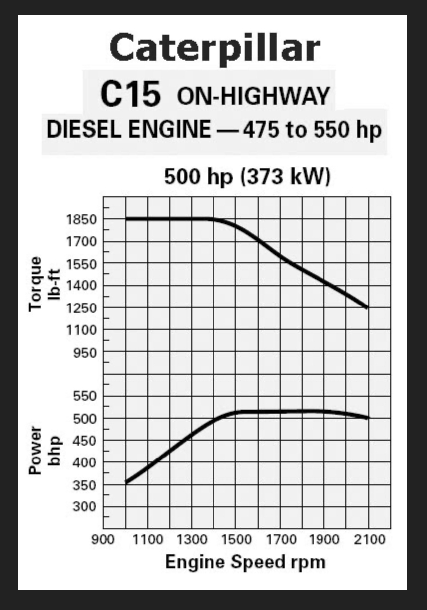

IF you pick a specific RPM.....and want the most torque.....it will also be the one with the most horsepower.
If you want to maintain torque as RPM's change or drop.....its ALSO maintaining HP better....IE: area under the curve on a HP graph.
This is a dyno chart of one of the Cat equipped road tractors we have where I work (heavy construction)
I pull double, cement bulk trailers in western Montana… 128,000# give or take…
When I first drove this tractor, and came to “the hill” (6% uphill for a little over a mile), I would start downshifting, four or five gears, to keep the engine between 1,900 - 2,100 rpm which is at the peak of its HP range…
One day I got lazy… ok, I was “experimenting”, I let the engine begin to “lug” … and found the engine would continue to pull hard down to 1,100 rpm… I still needed to downshift a few times, but I didn’t have to keep the engine racing and the tractor/trailer climbed the hill at a greater speed than it would in a lower gear with the engine racing…
Which brings me back to the reason I started this thread… and I STILL can’t wrap my head around why it‘s HP performing the work when, in my experience, I see torque taking over when it comes time to do the heavy lifting…
As was pointed out earlier in the thread, two 25 HP tractors with two different displacements… seems to me the larger of the engines will generate more torque throughout a broader spread…
