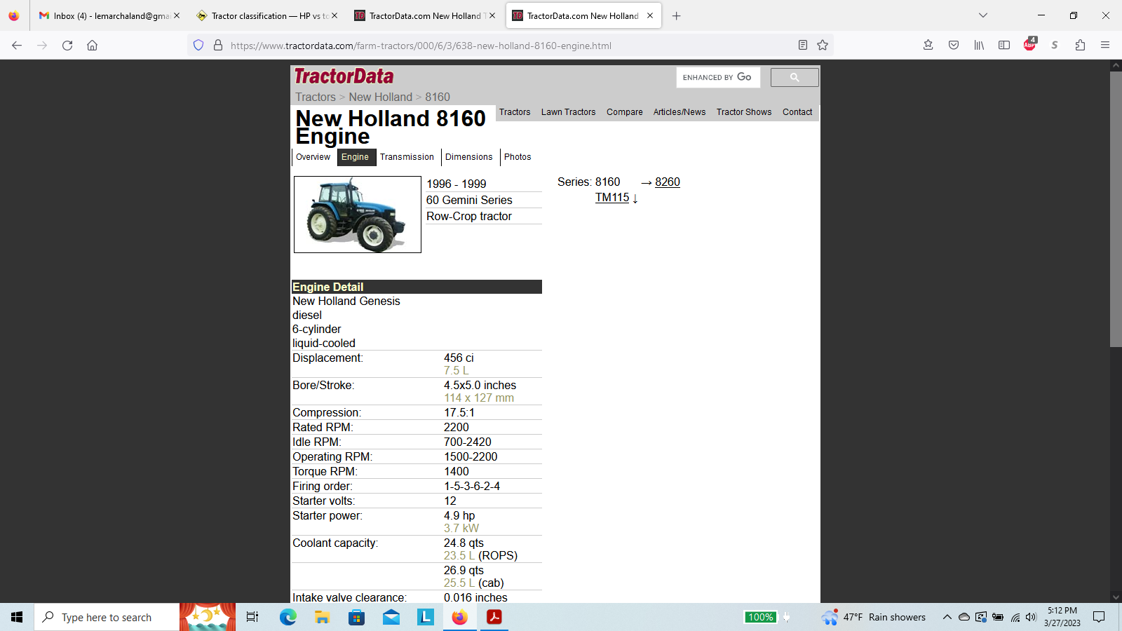

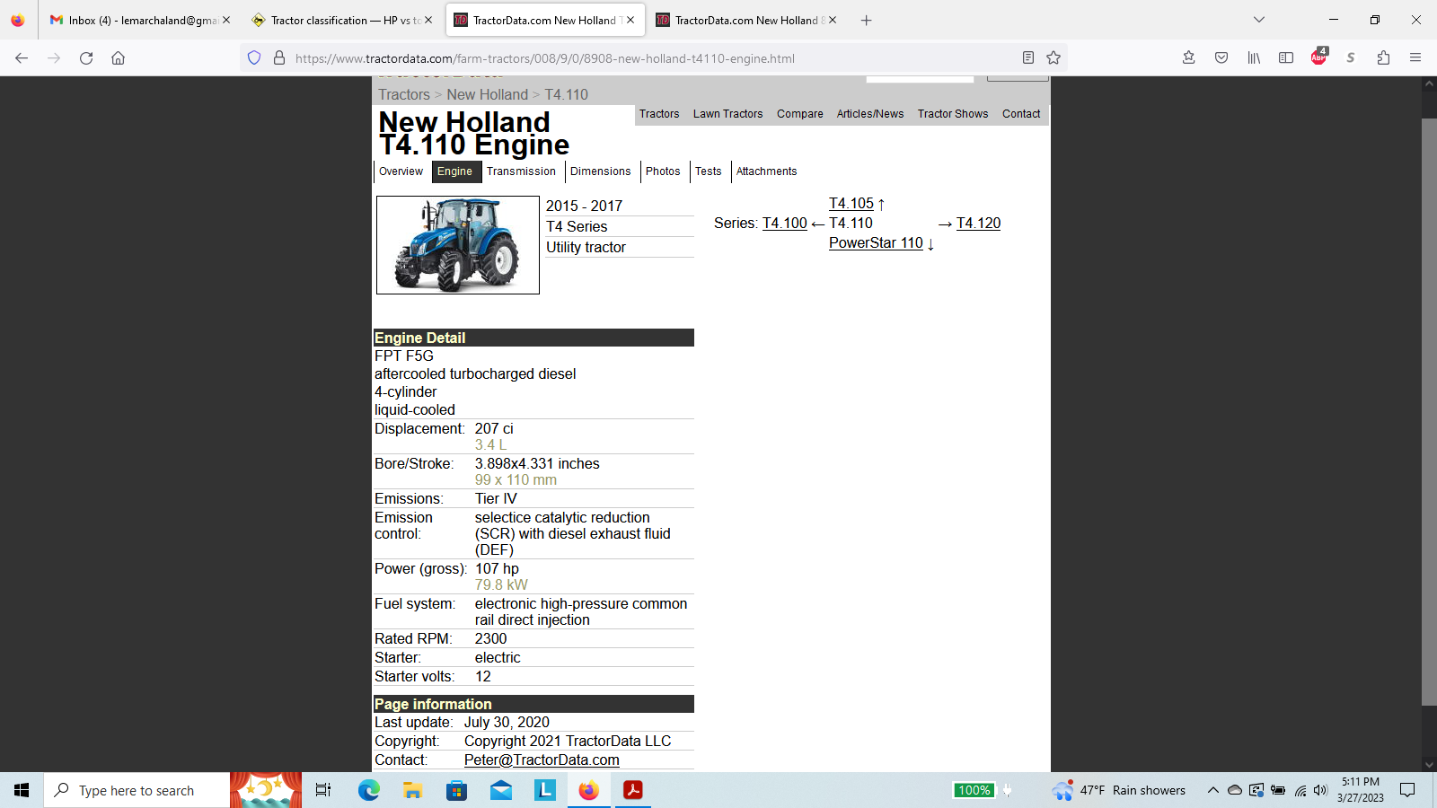

Two 90 PTO HP tractors from the same manufacture with completely different engines.
I much prefer the second one, myself.
   / Tractor classification — HP vs torque #54
Me too.
The Genesis (8160) can be a 40+ year tractor. The T4.140 is a fine tractor, but will die from it’s own complex design and a smallish engine pushed too hard.
I would say the Genesis Tractors were second only to the Boxcar Magnums as the most popular tractors ever built since the 80’s.
I’m an AGCO guy, but have a lot of respect for the Genesis and Boxcar Mag’s. Came close to buying a Genesis more than once.
I love my big Magnum primarily because of the big engine. You can turn the PTO hooked to a huge baler and it just takes it.

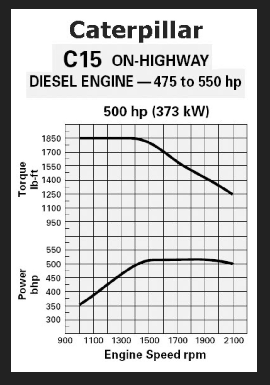

This is a dyno chart of one of the Cat equipped road tractors we have where I work (heavy construction)
I pull double, cement bulk trailers in western Montana… 128,000# give or take…
When I first drove this tractor, and came to “the hill” (6% uphill for a little over a mile), I would start downshifting, four or five gears, to keep the engine between 1,900 - 2,100 rpm which is at the peak of its HP range…
One day I got lazy… ok, I was “experimenting”, I let the engine begin to “lug” … and found the engine would continue to pull hard down to 1,100 rpm… I still needed to downshift a few times, but I didn’t have to keep the engine racing and the tractor/trailer climbed the hill at a greater speed than it would in a lower gear with the engine racing…
Which brings me back to the reason I started this thread… and I STILL can’t wrap my head around why it‘s HP performing the work when, in my experience, I see torque taking over when it comes time to do the heavy lifting…
As was pointed out earlier in the thread, two 25 HP tractors with two different displacements… seems to me the larger of the engines will generate more torque throughout a broader spread…
Another thing larger displacement engines have over small engines I hear commonly talked about by truckers and farmers is “rotating mass”. Once a bigger displacement engine gets going, the rotating mass of the larger pistons, heavier crank, bigger components keep the torque and momentum going.
